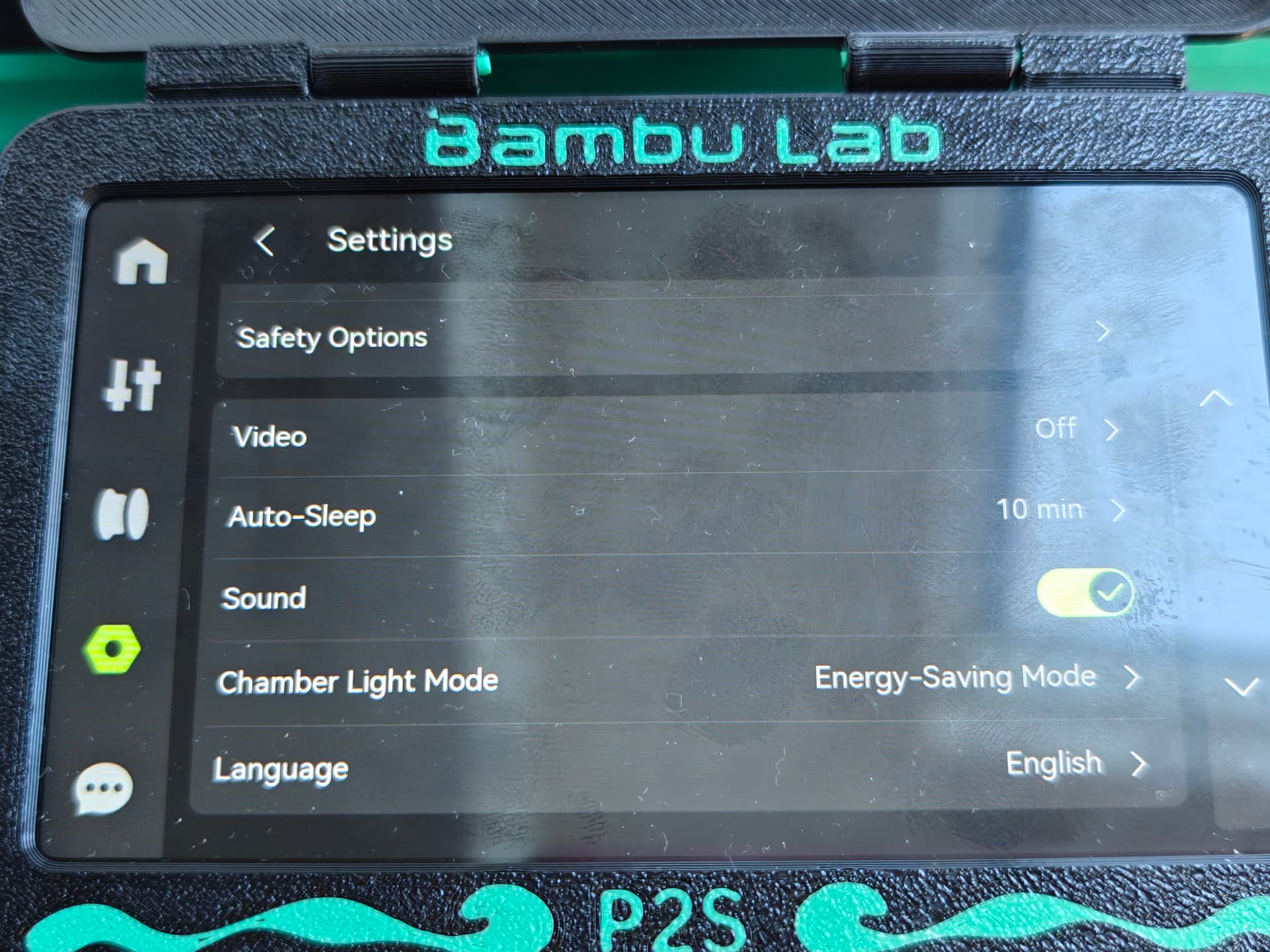

The lights in the chamber stays on after printing… I can turn it off manually, but next time I print the lights come on, but don’t turn off again after ended printing ?? It should not be necessary to mess with the G code on the P2S as far as I know ??

on the h2d is a setting (power saving I think?) it is probably the same on the p2s?
That was it… I was looking for something like that, but looked the wrong place… Thank you :slightly_smiling_face:

2nd button on screen ( looks like 2 arrows) and you’ll see the bulb to turn light off.
Setting is here to turn if off after 10 mins after print has finished.
Change chamber light mode to energy saving mode
Same thing is happening to me but my energy saving feature is enabled and still not turning off when the printer goes to sleep.
