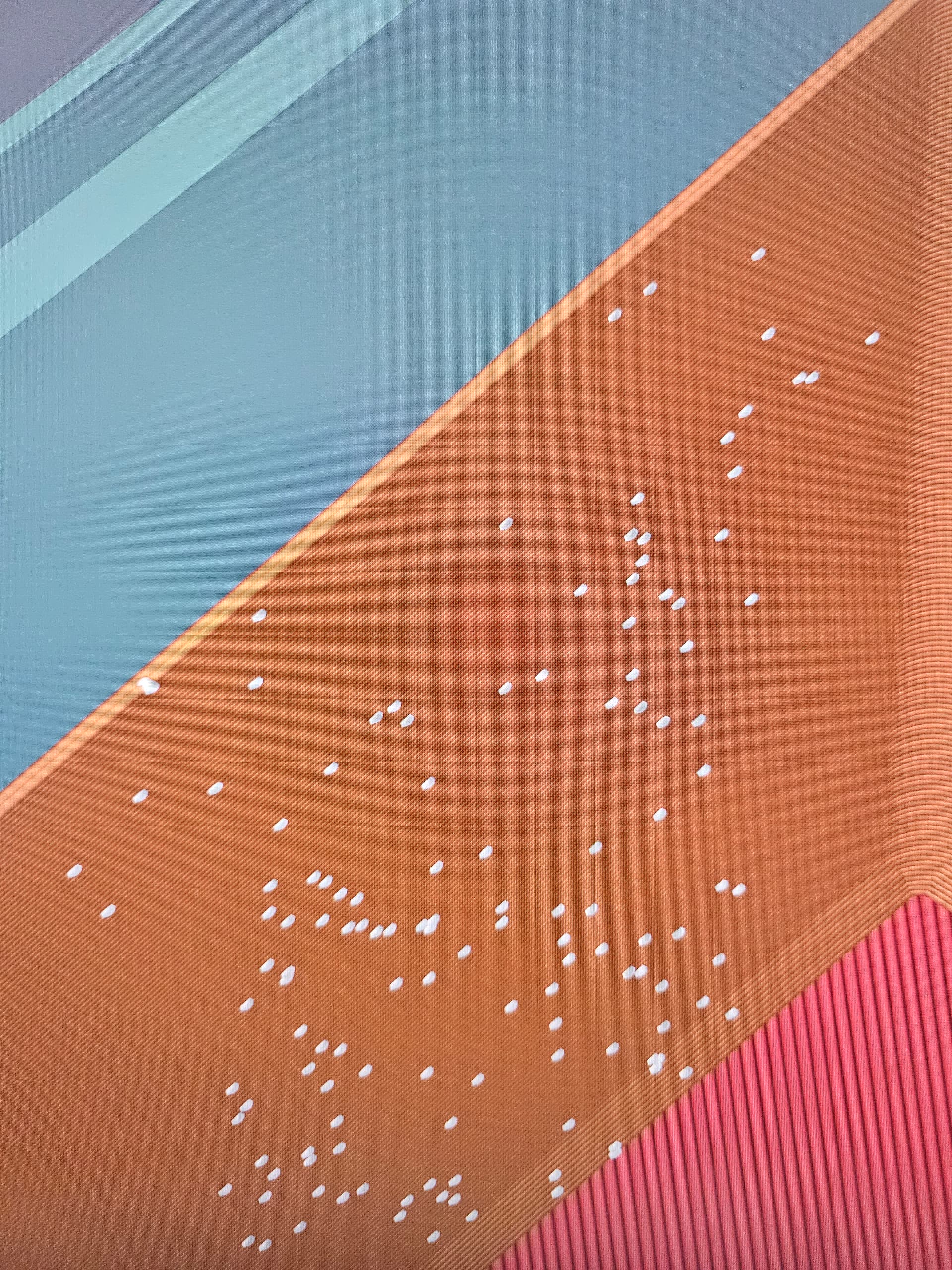

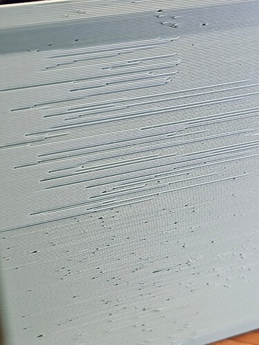

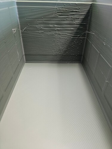

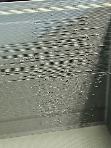

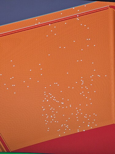

P2S, PLA, calibrated (printer calibration), random seams. I can’t understand where does the difference in print quality comes from. It almost seems like the printer is misaligned somehow… skewed or something. I ran a couple of other prints ant they came out perfectly, therefore I assume it’s the print/file. The wall with all the seams is a perfectly straight wall, no reason for the seams and print lines to be visible.
This looks more like a flow/extrusion issue. To be honest, I don’t like the random seam function anyway, as it does not give a nice look in large, straight surfaces. I accidentally did a spiral vase with random seam, and it looked awful.
I prefer to try and get a single seam in the inside, and if possible in a corner.
