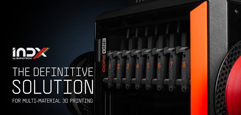

Tool changers (real ones) and/or INDX (do not get confused with IDEX).
I always get confused on this, which ones are tool changers and which ones are tool head changers?

Tool changer
Active Tools: The moving part contains mostly motion events and the heads that are swapped in are more electronics, fan(s) and the hot end all in one.
Examples: Snapmaker U1 & Prusa XL.
INDX
Passive Tool Modules : The individual parked heads are simple, wireless, and completely “hot-end-less” mechanical paths with zero electronics.
Example: An upgrade to the Prusa CORE One 3D printer, it is not a standalone printer (as yet), it users the Prusa printer as a base.
Still confused, Which ones are tool changers and which ones are tool head changers?
Tool Changers are ones that swap out almost the entire print head including extruder motor, filament sensors, etc.
Think Prusa XL…
Huge, bulky, cumbersome, but very capable
Tool head changer (I rather use the term nozzle changer)
Simply swaps nozzles and sometimes filament path. Like the bondtech indx or Vortek.
Smaller, more compact, cheaper, but less capable in the multimaterial space.
