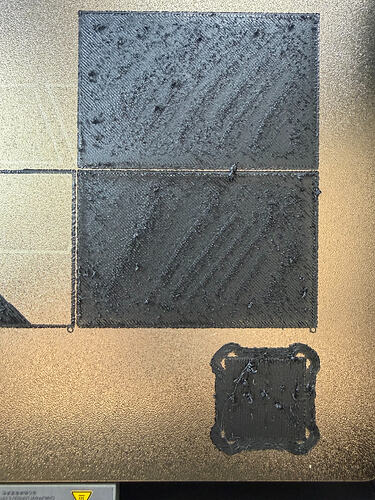

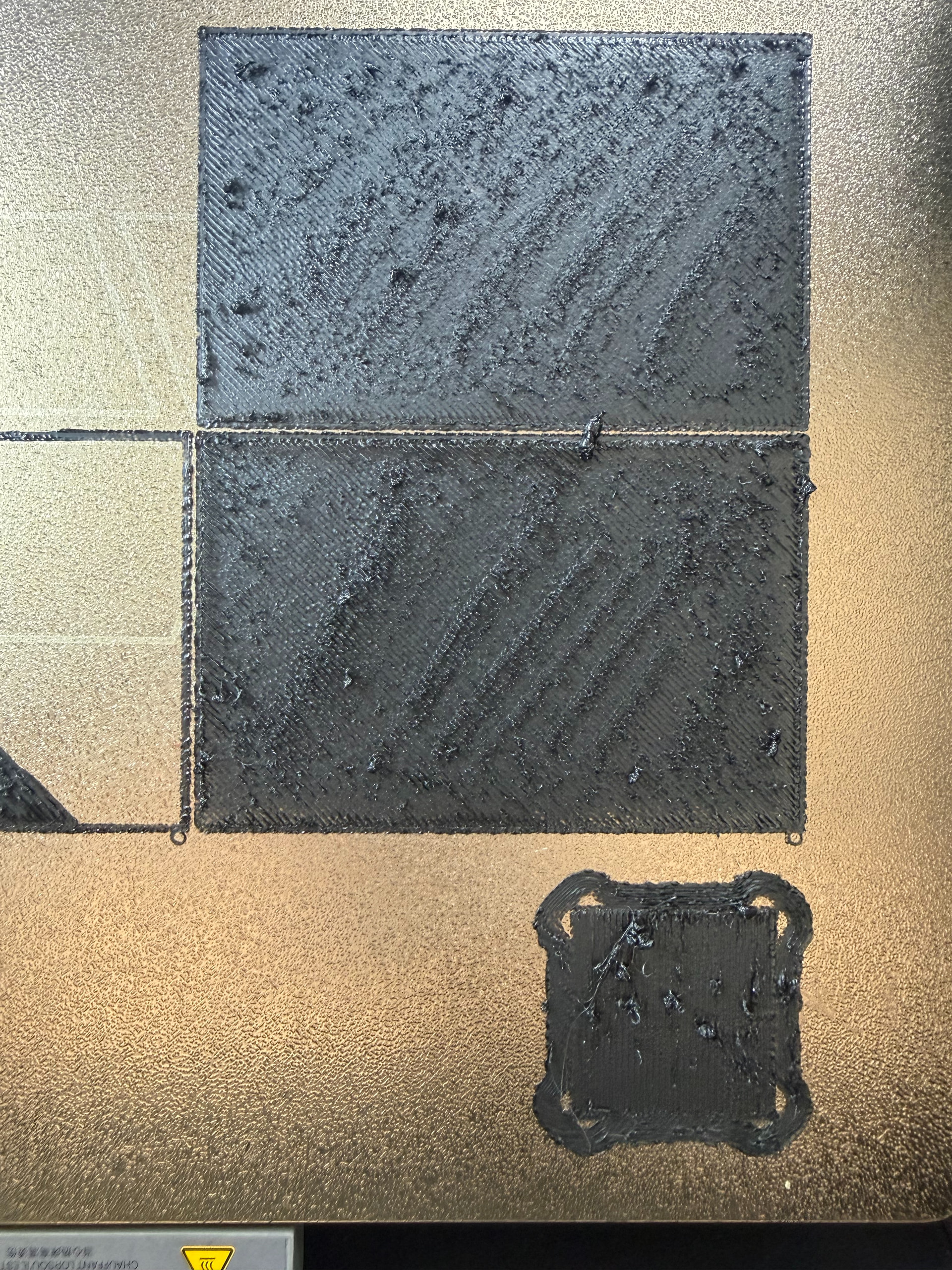

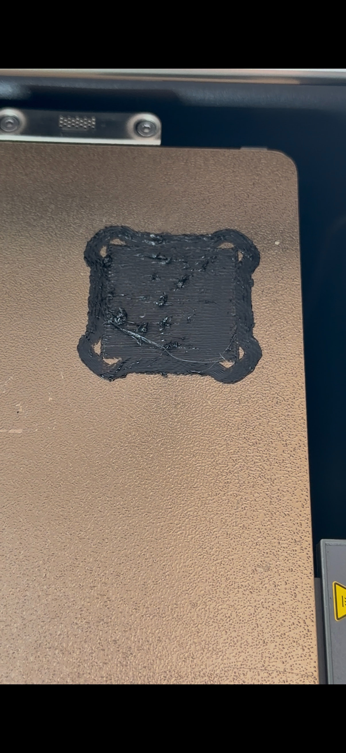

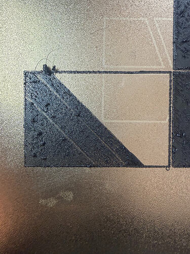

Problem

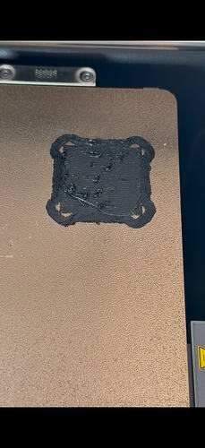

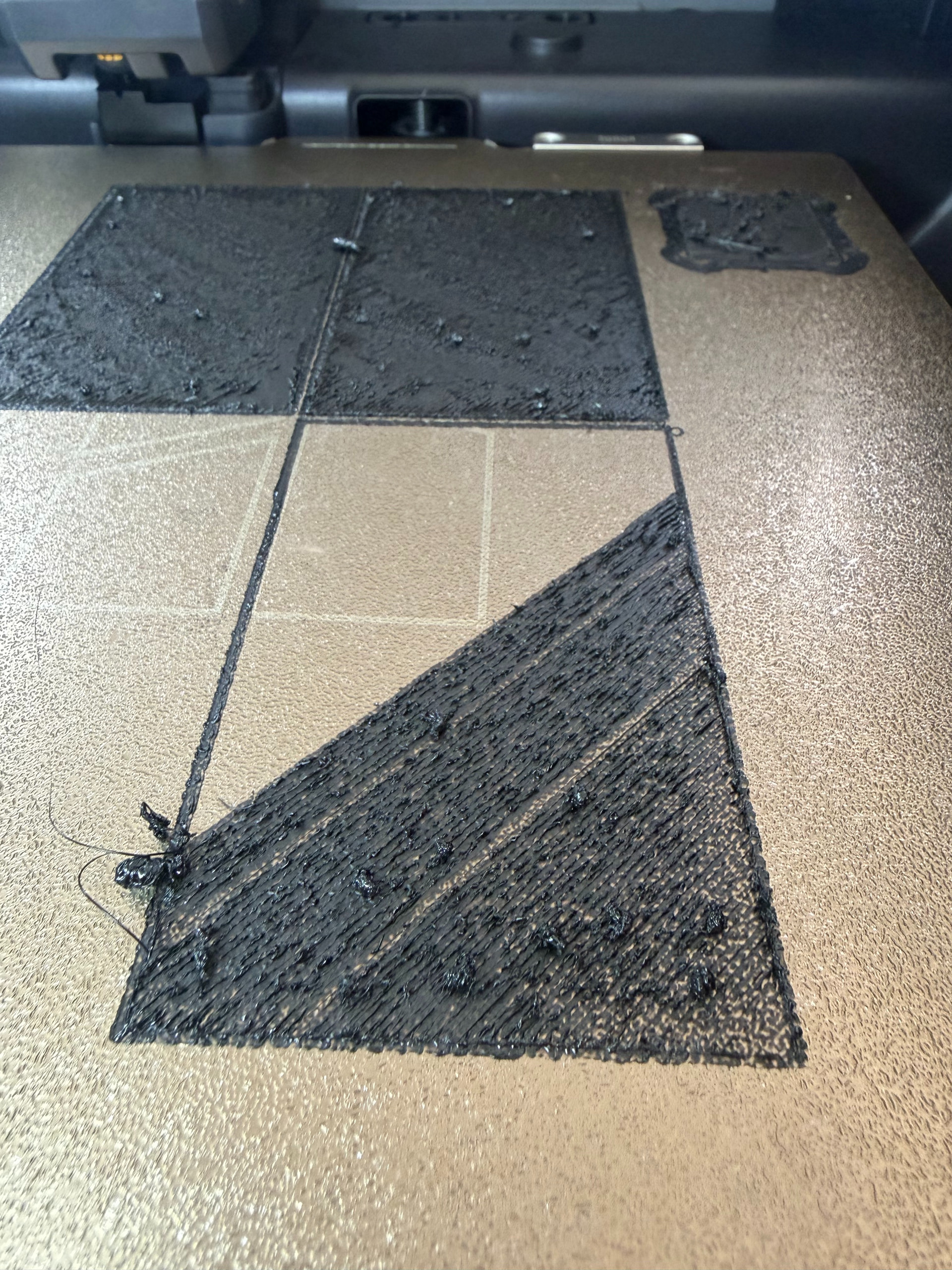

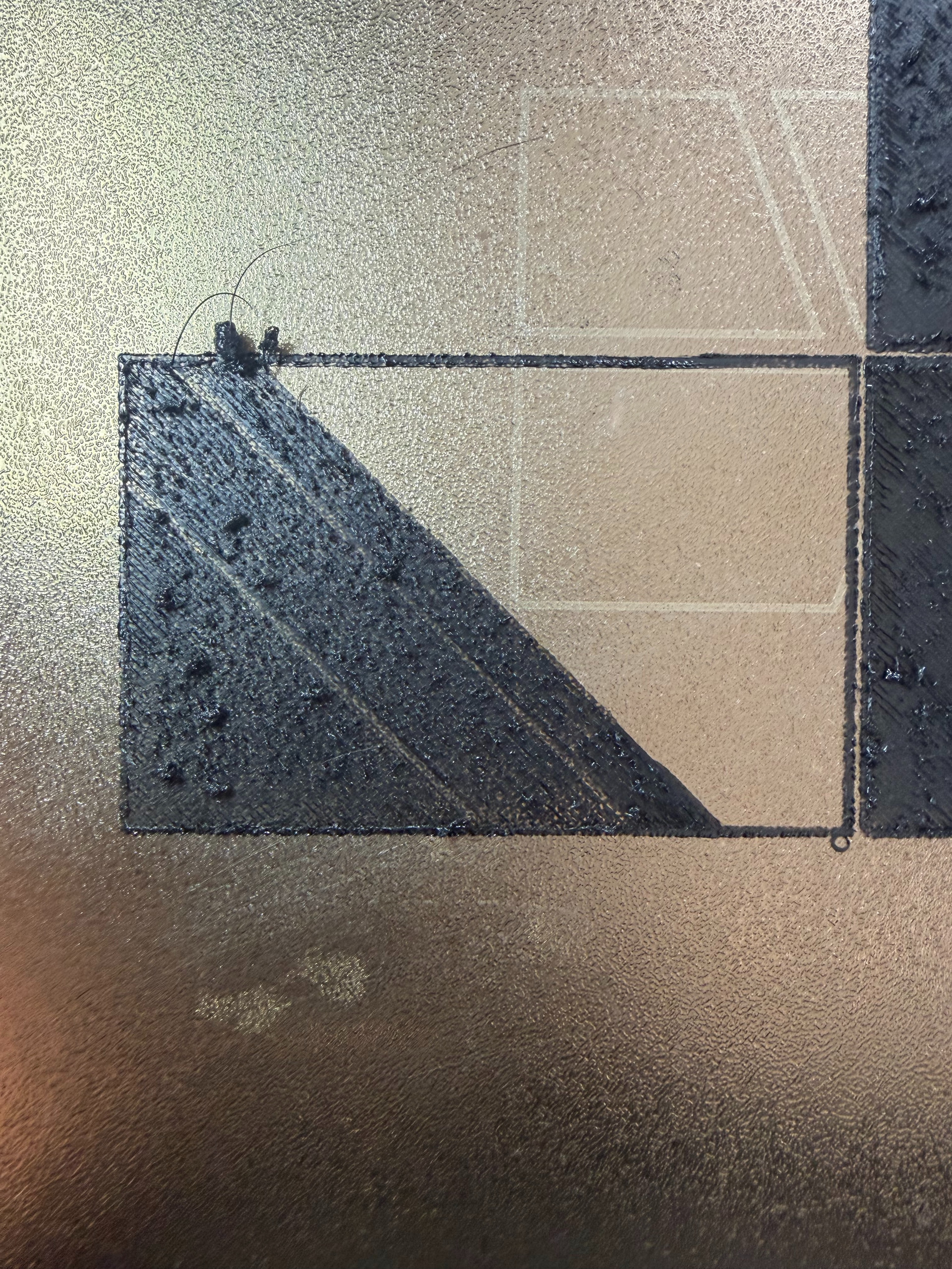

The first layer comes out badly on every PETG print, regardless of part size.
It over-builds material and creates blobs across the surface, which the nozzle
then drags around. I also get recurring “extruder motor overloaded” errors,
sometimes mid-print.
Key observations:
  • PLA prints perfectly. This only happens with PETG Basic.
  • A Benchy had the same bad first layer, but finished acceptably — except the
    embossed lettering on the underside is completely smeared over and unreadable,
    and the whole bottom surface looks wrong.
  • Large flat parts are worse, since there is more first-layer area.
  • Sometimes the print still finishes fine despite the bad first layer.
  • Same behaviour with the old nozzle and with a brand new one.

Questions
  1. The lost lettering on the Benchy underside suggests over-squish / over-extrusion
    on the first layer rather than a clog. Does that match what you see in the photos?
  2. Is the stock PETG Basic profile on the P2S known to run too much first layer
    squish on textured PEI? What Z-offset and first layer flow values are people using?
  3. Is the “extruder motor overloaded” error just backpressure from the squished
    first layer, or should I be worried about the extruder itself? It never happens
    with PLA.
  4. Has anyone adjusted the stock PETG Basic profile since the reformulation from PETG HF? Specifically first layer height, flow and Z-offset.

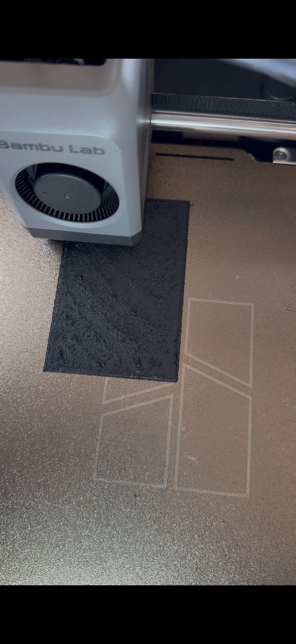

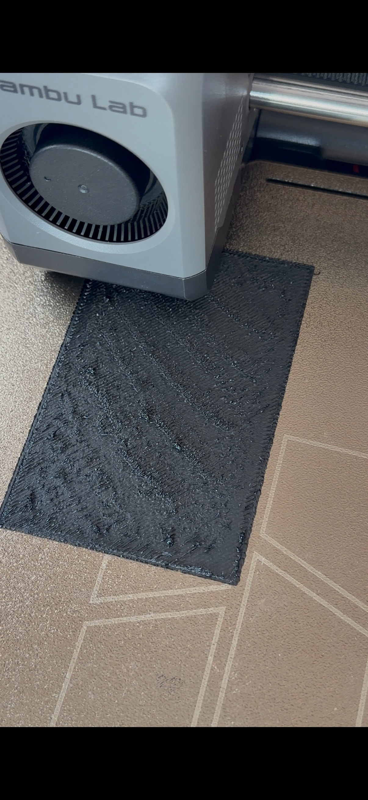

Hello,
Same problem here : PETG basic white on H2S and H2D.
On my side, first layer is OK (bottom layers), but exactly same problem as you in terms of aspects during infill
I am trying to print big parts.
Any solutions here ?
