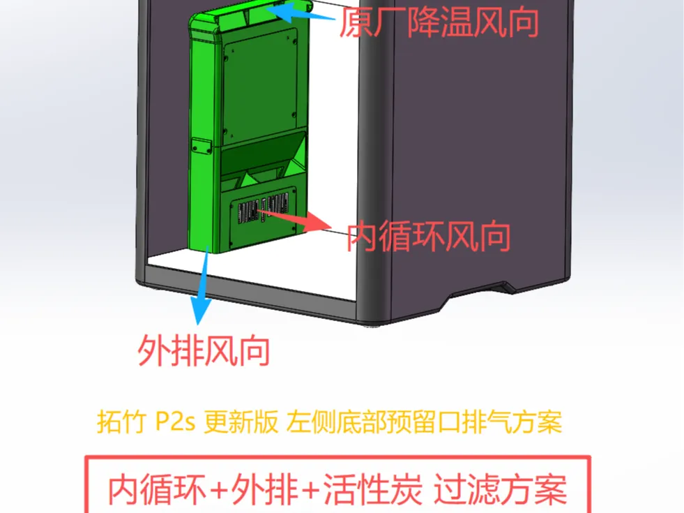

For example - there are vent holes (covered with an extra piece) on the bottom left. An exhaust filter could be set up to exhaust out of there, through some filters. This will need an extra fan.
Or: the cold air intake fan could be made to pull air through the left bottom vent (and/or the poop chute) through ducting and some filters, to create a recirculating system - that way the intake and exit airflow are somewhat balanced. This would then no longer be a cold air intake but the air will still cool down from going through a duct outside of the printer. This method requires no additional electronics and no new control method.
Thoughts? Other ideas?

Ok hear me out:
No additional electronics, the main fan pulls from the unit below, which in turn, pulls from the duct on the bottom right. Airflow is balanced (there will still be some leaks but much less).
Heat exchanger is air-to-air and could be passive or with another fan, and cools the recirculating air.

Ok idea #2 -
This fixes 3 issues at once
  • aux fan warping parts near the aux fan (so people install deflectors)
  • Recirculating mode air hits print bed and print due to its exit vent
  • Unfiltered air escaping the printer with PLA/PETG
replace the entire fan housing so that the air is always drawn through the filter. Then the air either exits back into the chamber but at the bottom OR exits out through the bottom right hand-hold. If the air is made to exit the printer, then cold air will be drawn through the MC board vent holes and poop chute.
The toggle could be manual and the motor could be disconnected or, with a bit of tinkering, automatic.
You’d lose the aux fan obviously but you could add one on the left if you really want one (I do not)

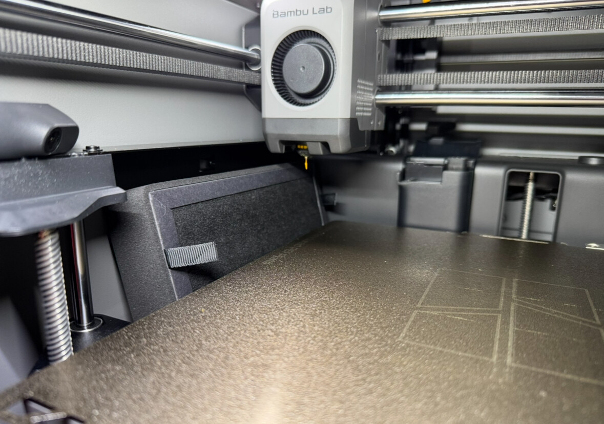

Ok i see, so we need something like this =) the reverse bento
The P2S filter fits here hmmm…
I’ve had good performance putting the filter intake at the nozzle height like this
