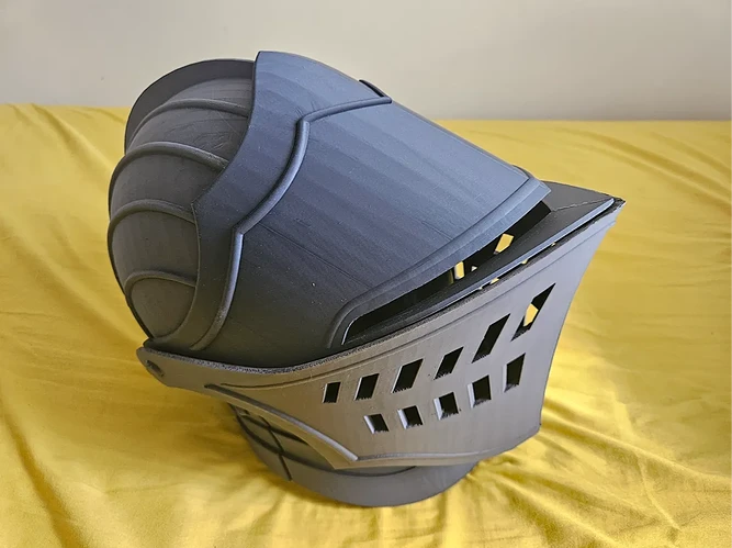

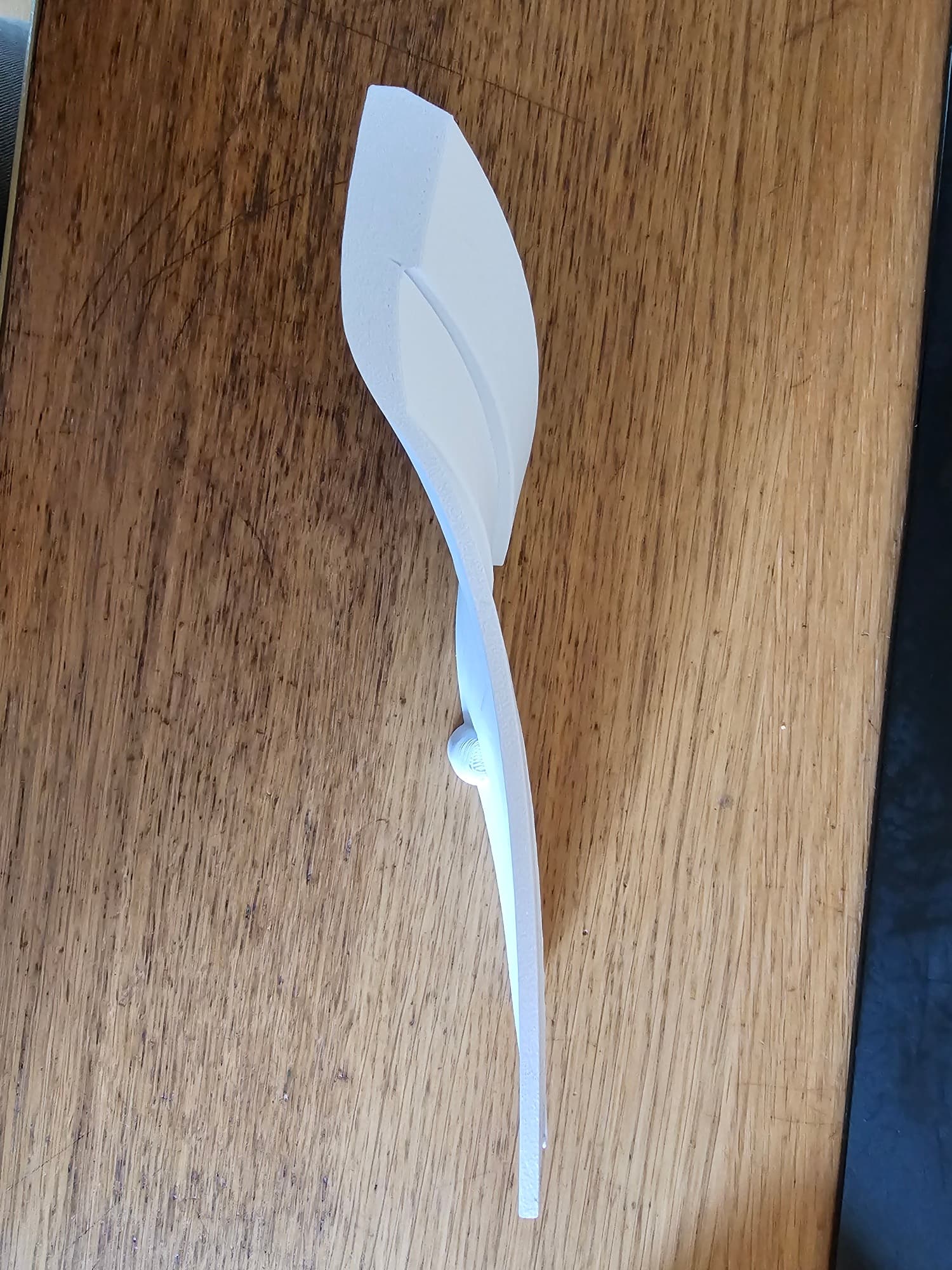

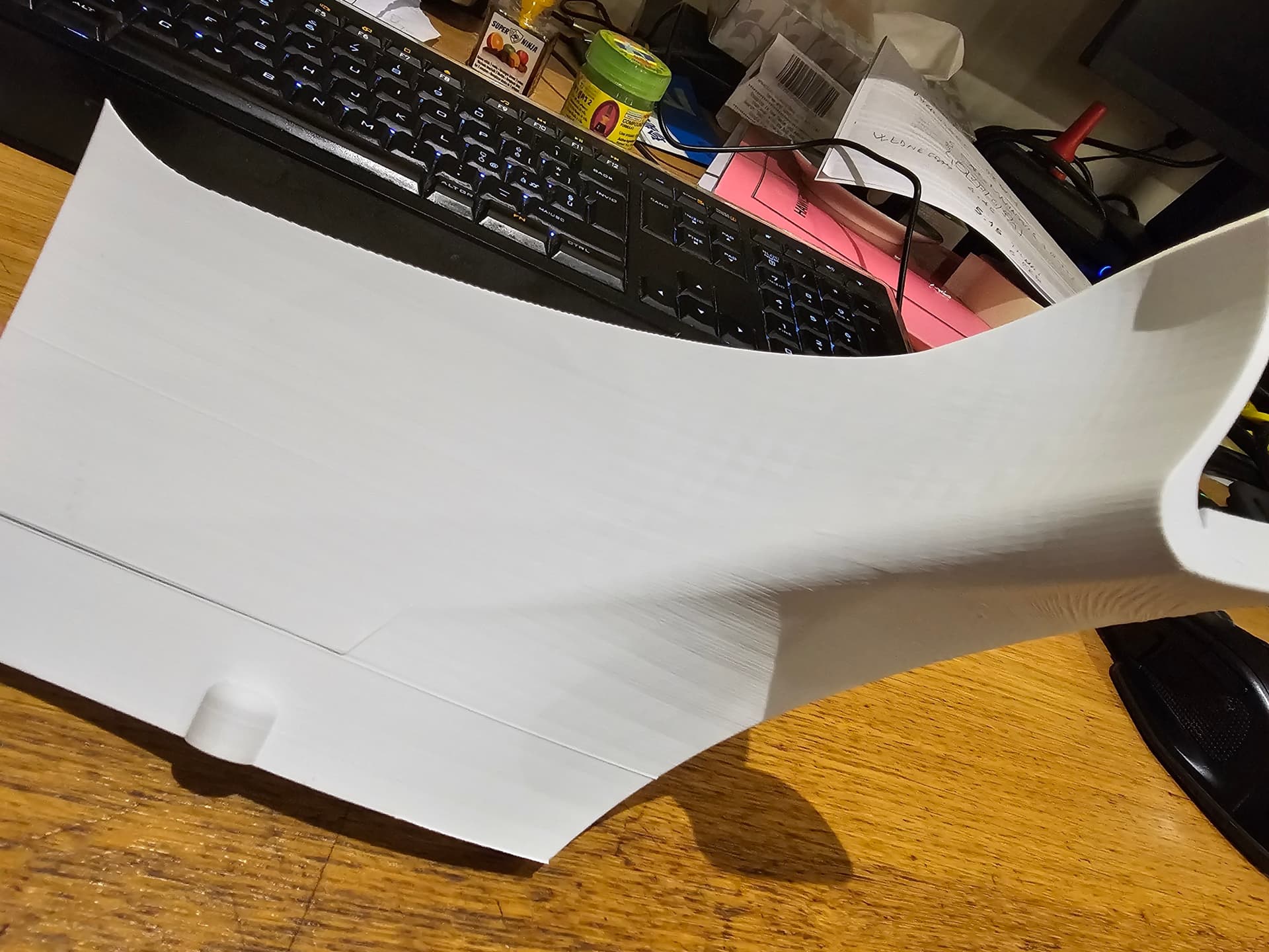

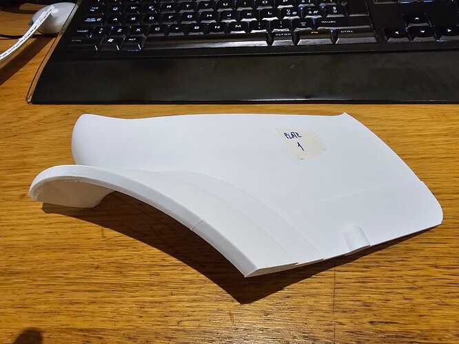

I’ve been trying to print this model with mixed success:
Plate 1

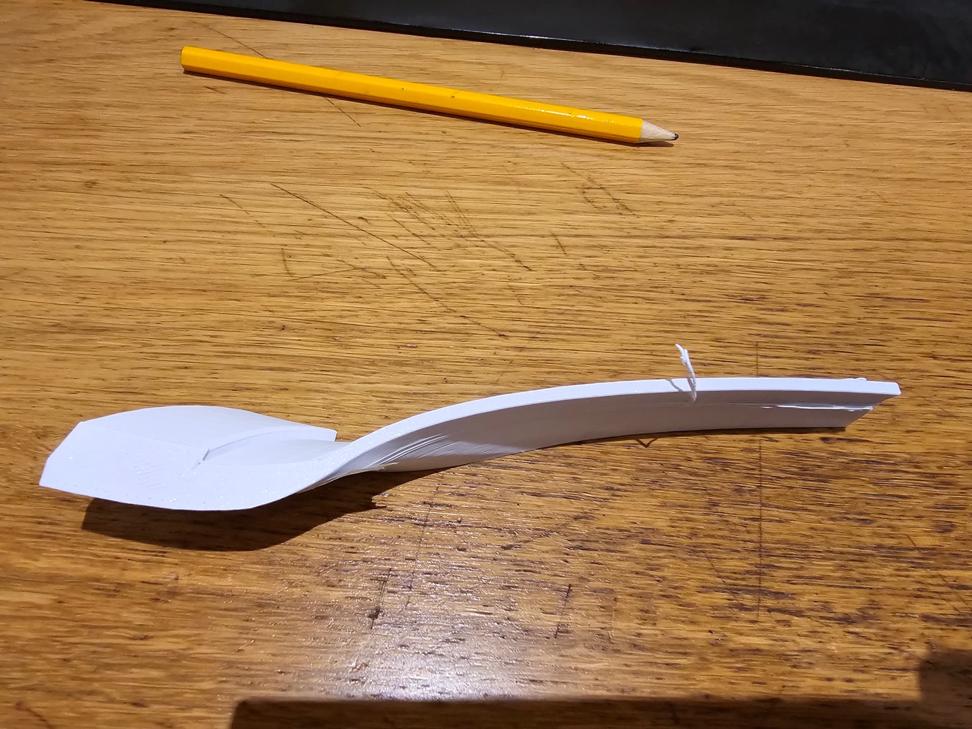

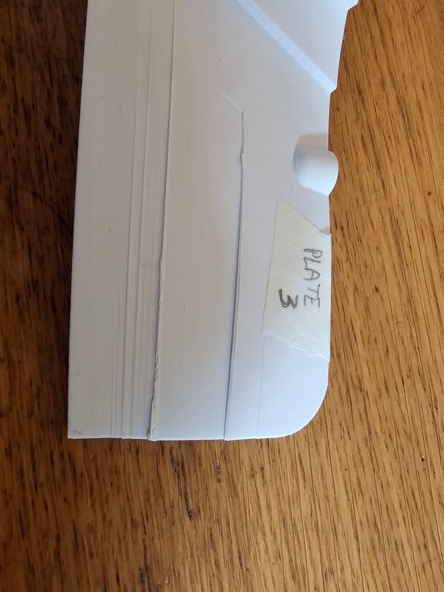

Plate 1 failed a couple of times because when reaching 50%-60%, the supports lost adherence to the plate. I overcame the issue by adding a 20mm brim around the object as well as the supports and using glue on the plate. The result was ok-ish (horizontal line in pic 4 did not bode well)

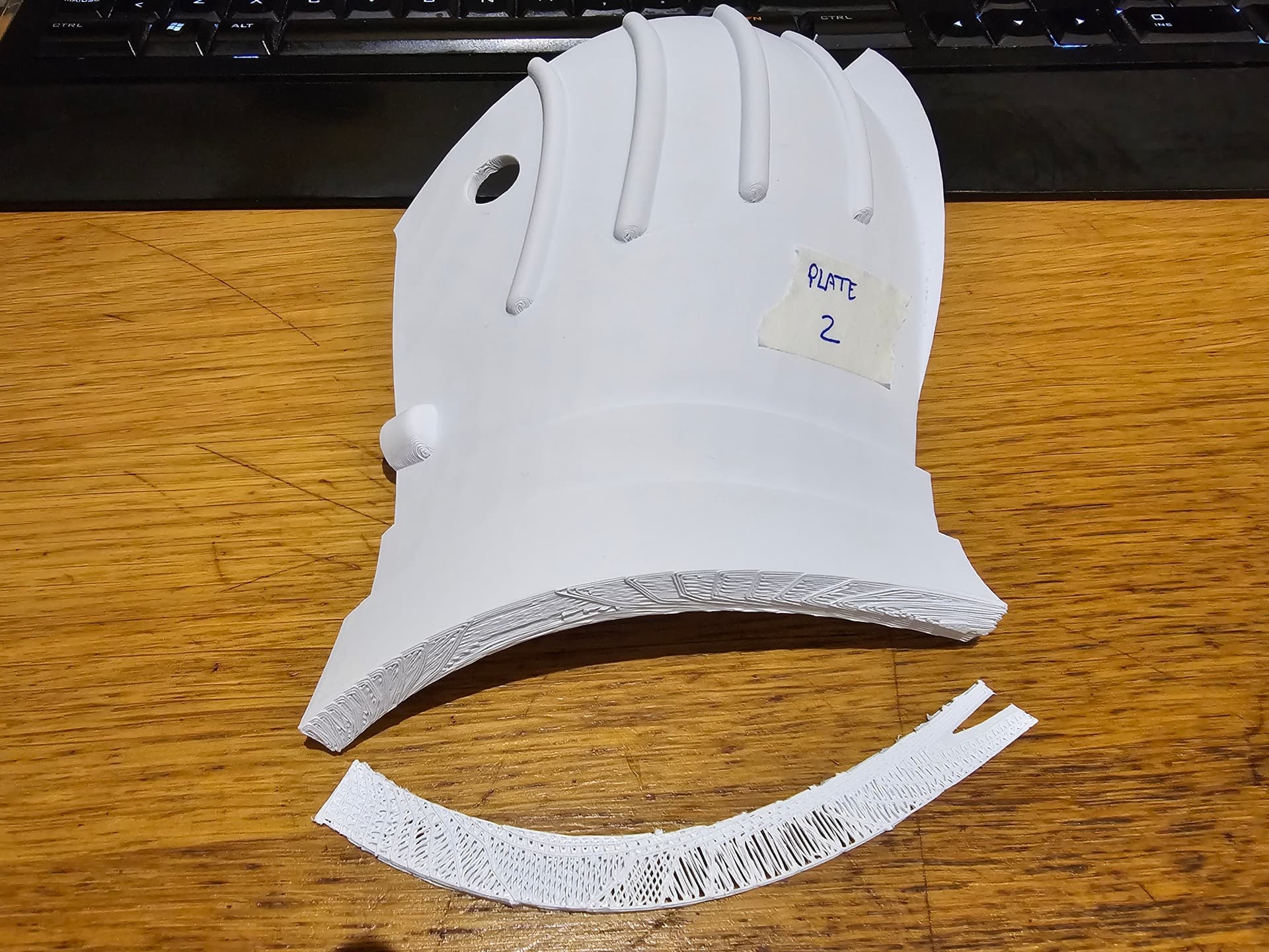

Plate 2
I did the same for Plate 2 but got a separation shortly after the initial layers, I let it continue as it wasn’t visibile at the beginning and I thought to fix it later during post processing.

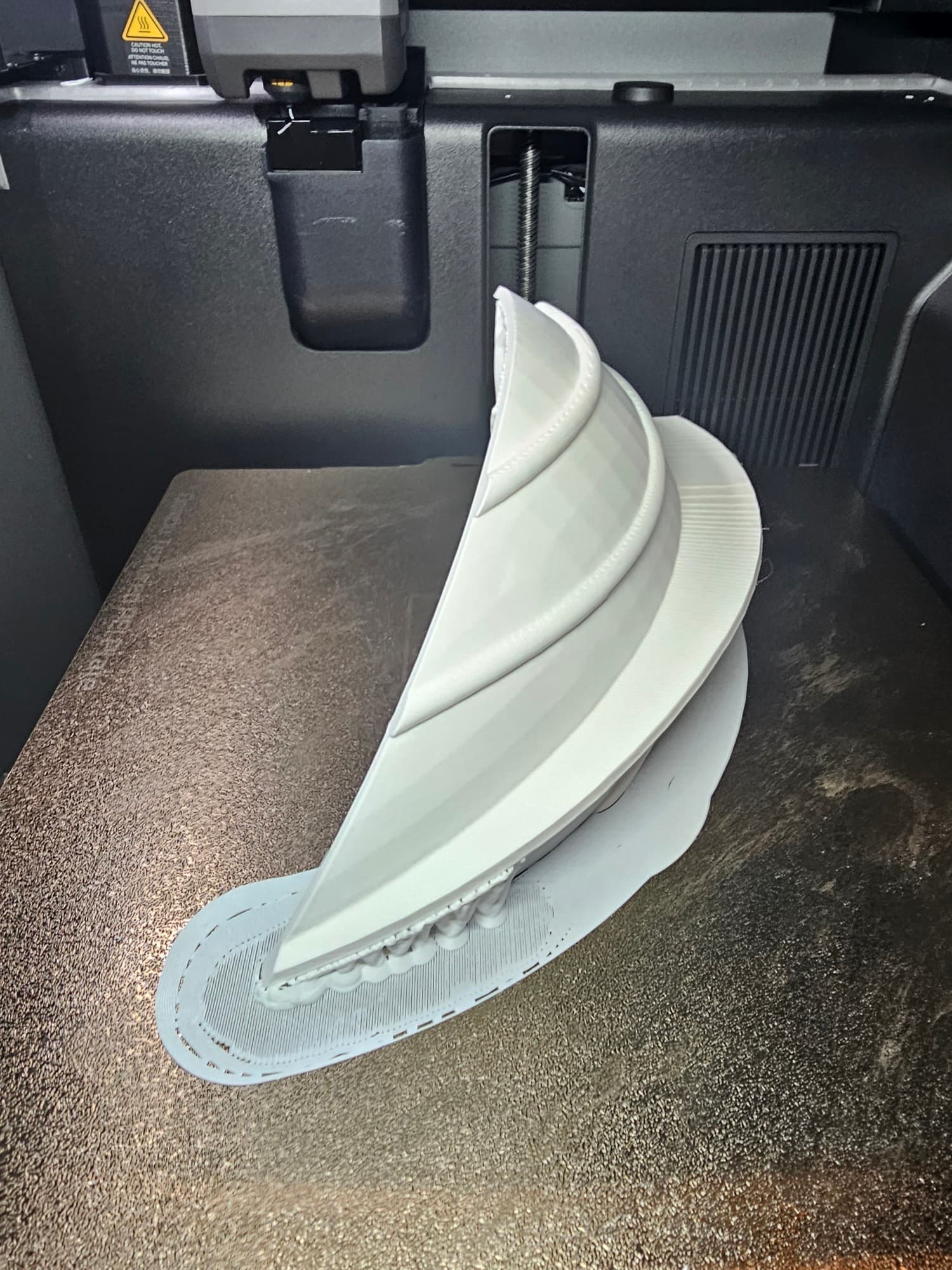

Plate 3

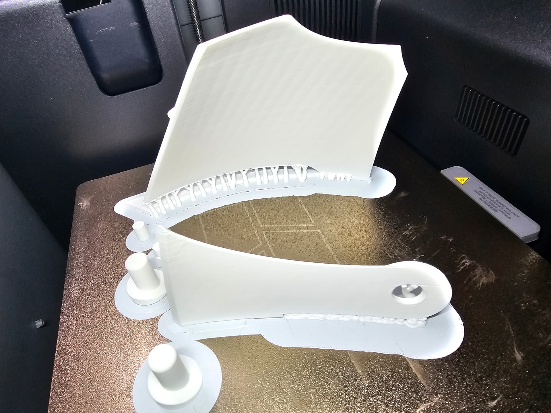

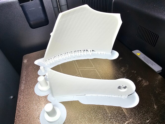

Went on to plate 3 but it started a weird clumps around 50%, so I stopped.
Retried with 0 settings to the brim distance for the object but midway I still found the brim was spot on the pat but the object was separating, paused and helped as much as I could with blue tack and duct tape just to finish the print but the result is far from optimal…

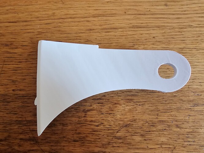

Plate 8

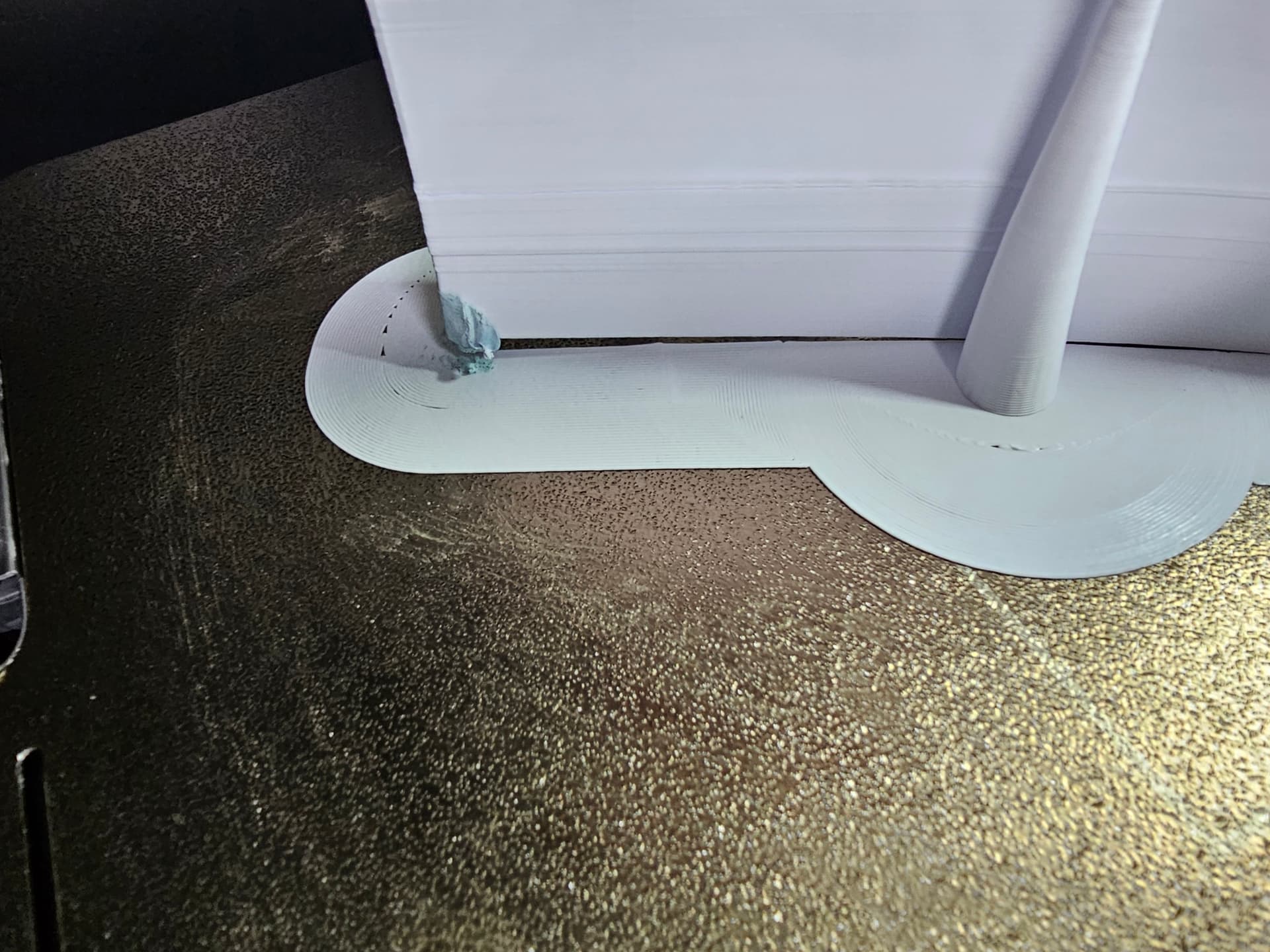

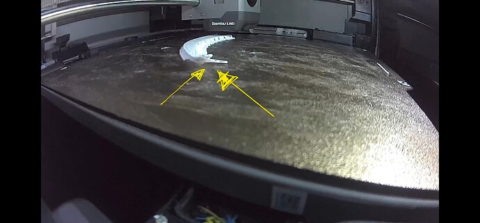

Plate 8 is made of two objects, I’ve tried printing first the small one with a raft and glue instead of brim as I noticed that even with a 0 distance from the object the brim still leaves a small gap, the result was good and I thought I had found the solution:
However when printing the second, much longer, object from the plate, the sticking issue came out shortly after the raft was printed:

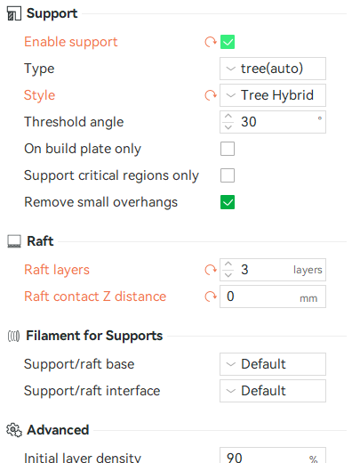

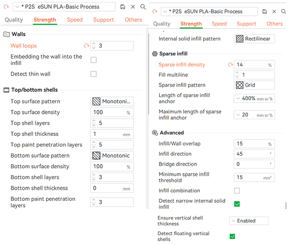

These are my settings in Bambu Studio:
Quality
Strenght
Speed
Support (with Raft)
Support (with Brim)
Others (with Brim, when Raft is selected in the Support, Brim for the object is ignored)

I’m sure there are a lot of settings that could help achieve the same in a different way, this is what worked for me on tall prints which kept losing adherence and fell over mid-way:
  1. Use glue stick for better adherence
  2. Increase Outer and Inner Brim size to 10mm
  3. Increase Support Initial Layer expansion to 15mm
  4. Add Custom supports to make tall prints more stable

Judging by your pics this isn’t so. You have one part that is smaller than the massive amount of glue/something on the plate.

You’re looking at the end result, when starting the plate was clean, with glue applied where the print would be, sometimes I went “happy” with the glue or, hence the additional smear.
PLA was also properly dried, so it’s was not humid filament issue.
Anyway, The settings I mentioned above worked well and I did not experience further disconnetions, so I’ll stick with those and hope they can help others.
