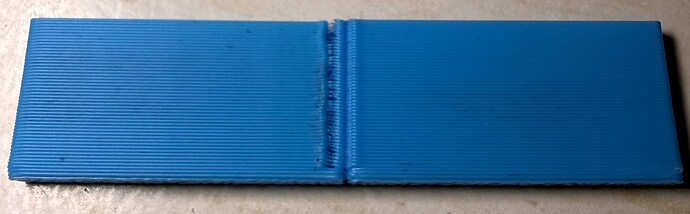

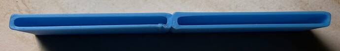

P2S Severe Under-Extrusion on Speed Transitions
Symptom: Line width varies 0.3-0.65mm (target 0.42mm)
- Occurs ONLY at sudden speed changes (10→200 mm/s)
- Consistent and repeatable
- All PLA filaments
- No mechanical clicking/grinding
- New nozzle
Pressure advance works perfectly for corners without speed changes in slicer. But when sudden speed change is introduced, severe over/under extrusion happens.
Flow rate is calibrated.
I know about extrusion rate smoothing, it helps, but not in every case. And anyway the wall width is fluctuates even with smallest smoothing values.
Have you manually calibrated pressure advance before?
Yes, I tried manual calibration, it looks a little better, but still, the wall is very thin.
And this is what happens if I set travel distance threshold to 1 instead of 0.

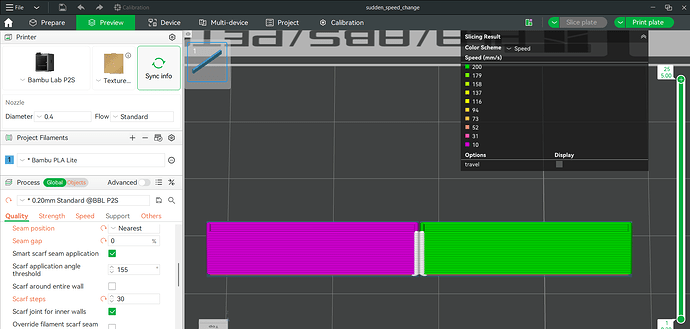

UPD: better minimal example is below
Thanks for posting this, and it’s interesting going through all of the changes, but I should have provided better instructions.
Starting with a default configuration and profile (for everything, printer, model, etc), reproduce the problem behavior with as few changes (preferably zero) to the default configuration as possible. Also note if it’s an orcaslicer or studio save and the version used (don’t say “current”, determine the actual numeric version).
Thanks, I tried to make a minimal example.
sudden_speed_change_minimal.3mf (25.9 KB)
Just in case, I’ll send screenshots with all the changes, there are only 5 of them. You can also increase max volumetric speed, but even with the standard 12 mm3/s (which limits speed to 159 mm/s), I get a hole.
Bambu studio version: 2.4.0.70
That is much better. Now are all of those (few) changes absolutely necessary to reproduce the problem?
I have had a look at the first 3mf you uploaded and there are quite a lot of puzzling changes.
  • Denoting your PLA as “Bambu PLA Lite”, is that PLA Basic or PLA Aero?
  • What are the Customizations in the Machine and Filament Start g-codes? There’s probably a very good reason for them, but if they affect the calibration, things could get out of control.
  • Your test model is not actually comparing a speed transition.
    You are comparing a modified scarf seam performance at 200mm/s to a modified scarf seam performance at 10mm/s (and many other changes such as a relatively high flow at a really, really low layer time) on two distinctly different objects.
If you want to actually assess a speed change rather than your scarf seam settings, use a single block with a modifier.

This is one of those models where prusa’s newer preview model showing “actual” speeds (aka after accel/je rk and starting velocity are factored into cornering) in regions rather than visualizing the prescribed speeds, would help reveal details. You can half-■■■ this in orca/bambu slicer by putting “extrusion rate smoothing” in, [only to preview - if you print like this you invalidate your tests].
Perhaps also a hint: the auto arrange wants these objects further apart, a seam right next to a seam with 0.32mm travel is going to be essentially a retraction torture test.

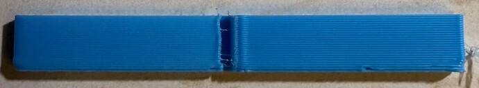

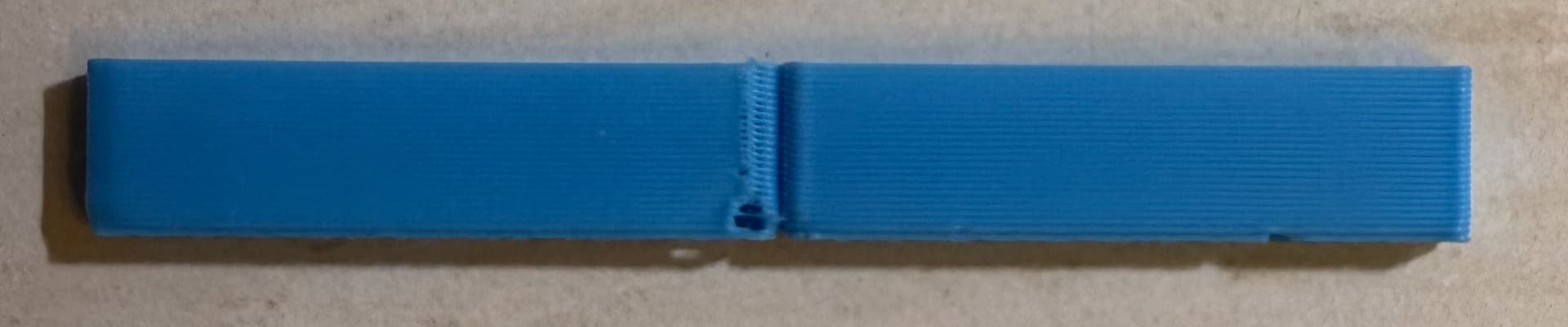

I tried to do this way, it actually makes seems even closer. I couldn’t get continuous line with speed change in it.
Not sure what you mean, these speed changes aren’t “close”, it prints one object layer at one speed, then one object layer at the next.
I mean that in the initial model I left a small gap between two objects, while the model with modifier does not have any gap between walls with seems.
Very interestingly, I rechecked myself again with the second 3mf and got the same bad result. Maybe it is related to P2S or to specific hardware version. Btw, I have 01.01.01.00 version of hardware.
PLA Lite Cyan on the top, PLA Matte Ash Grey on the bottom.
