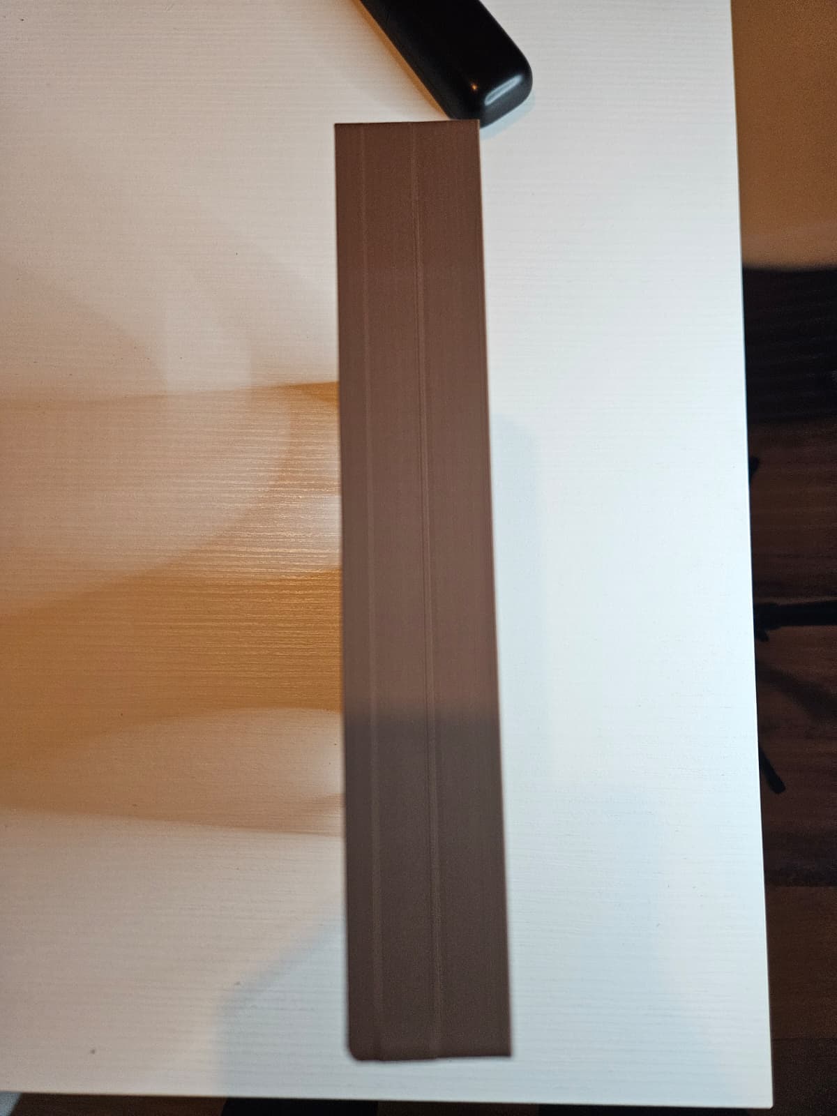

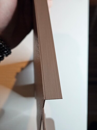

The main issue is related to surface artifacts on the walls, which appear to be a combination of:
  • Z-banding (very visible and widespread)
  • Hull lines, depending on geometry
  • Bad seams
Hull lines appear more frequently where there is a transition between filled and unfilled areas, where shrinkage, cooling, and layer time differ significantly.
I would expect some hull lines in these cases, but not this pronounced.
Z-banding, however, seems present almost everywhere, regardless of geometry.

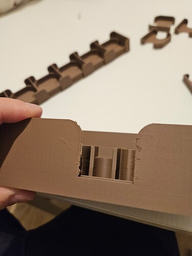

In addition, I don’t know what they’re called, but there are grooves that start from the points where the seams are. (Reference on Photos - Different Object 2)
(If I’m using incorrect terminology or making wrong assumptions, please feel free to correct me.)

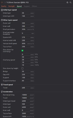

default settings and accelerations are overkill, volumetric speeds up to 25 that will never happen in my printer. you need to post you full settings for the forum to read
these are my personal settings for some filaments I use, they fit my needs and they just work for the materials, but prints come good. (printing asa cf atm, it’s coming very good since I started to lower first layer accel to ZERO)

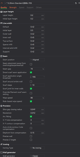

Filament settings:
Quality settings:
Strength settings:
Speed settings:
Support settings:
Other settings:
Age+of+Innovation±+Bambu+Studio.3mf (6,5 MB)

fourth pic I can’t guess why you felt the need for the 1.005, anyway tell us how it’s going like that I am interested
you can leave speeds like that since you reduce the volumetric speed. but I suggest to set outer walls at way lesser than 200, maybe 70 for PLA.

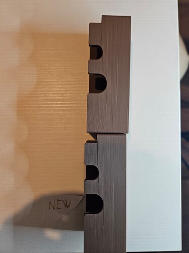

It’s finished now. These are the results with the settings written above.
It seems that nothing has changed…
Any ideas?
Good. It is a result. Seems hardware related to me. full maintenance with greasing and lubing and checks… let me notice the lines at the bottom tip of the semi holes…. seems also artifacts are the same in every print.. but it’s too bad
