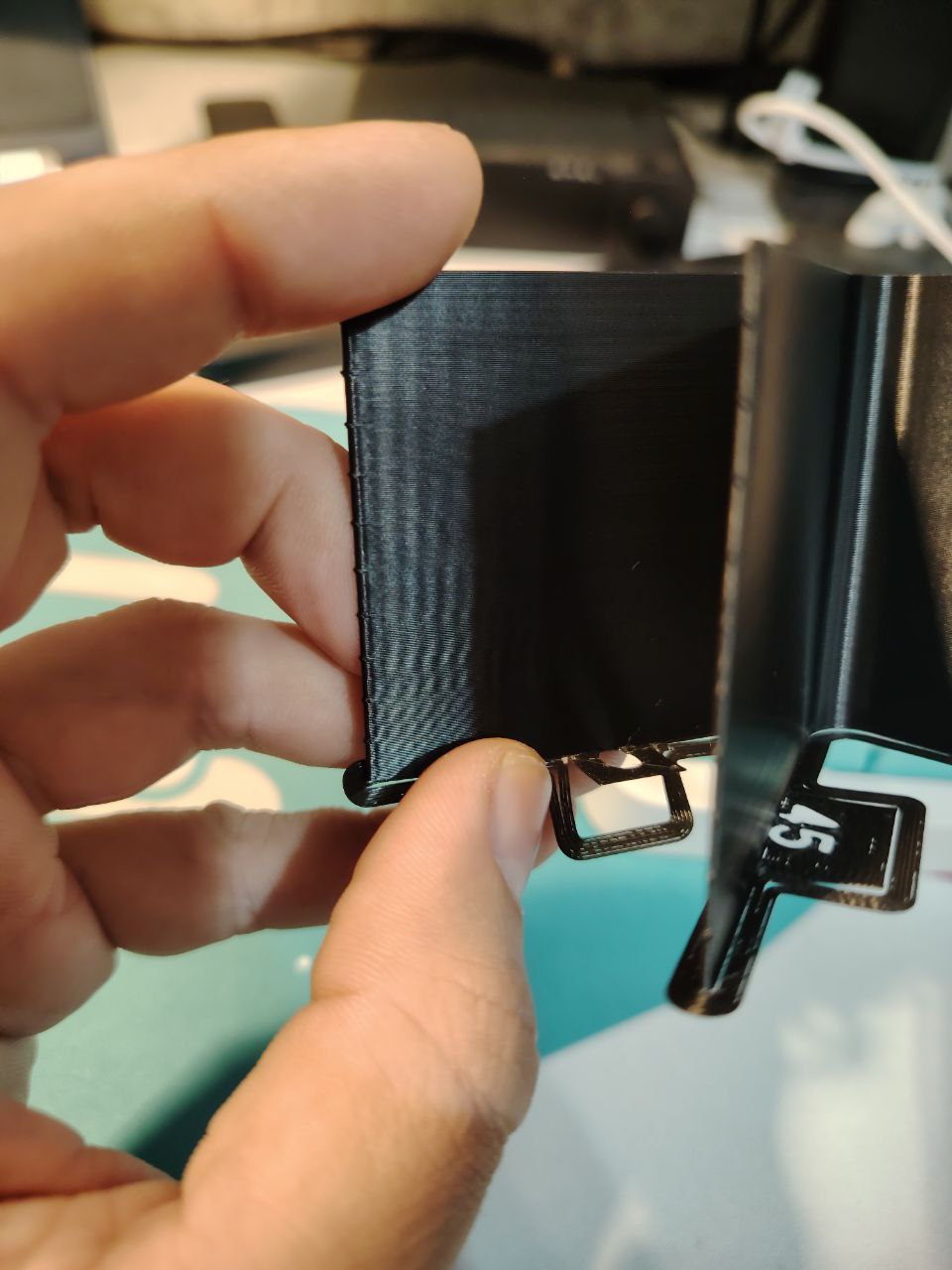

Hi, I have absolutely terrible VFA on all materials, especially on the X-axis. I tried re-tensioning the belts, lubricating them according to the wiki, but nothing helps. Did Bambulab really make such a bad printer?
In the photo PLA and ABS (black), speeds 150-200 mm/s

The previous P1s printed better. I also noticed the problem is almost always on the back side of the X. Here’s a cube that was printed, showing how much worse the wall facing the back of the printer looks.
I think there’s a mechanical issue here, or Bambulab has broken something in the vibration compensation. Reducing the print acceleration to 3000 doesn’t solve the problem.
If disable K calibration and enter the values ​​manually, you’ll get roughly the same result. And I see this on all the printouts, always on the back side of the X.

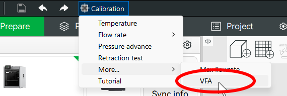

How do you do the vfa test i cant find it at bambustudio
Enable Develop Mode at the bottom of Preferences (Ctrl+P).
Another calibration menu will become available on the top line:
It worked awesome thank you
It looks like the p2s is just a faulty printer. And there’s been no response from Bambulab. Maybe they’re aware of the problem and it’s software-related? Or maybe it’s defective and a recall is needed. But I’m increasingly tempted to return it.
Ill dont think an software update will fix that, it seems to be an mechanicel issue .
I agree, it looks very much like a mechanical issue. That said, yes, there are a few that print quite well. But judging by everything, good printing for the P2S is the exception to the rule. :slight_smile:
