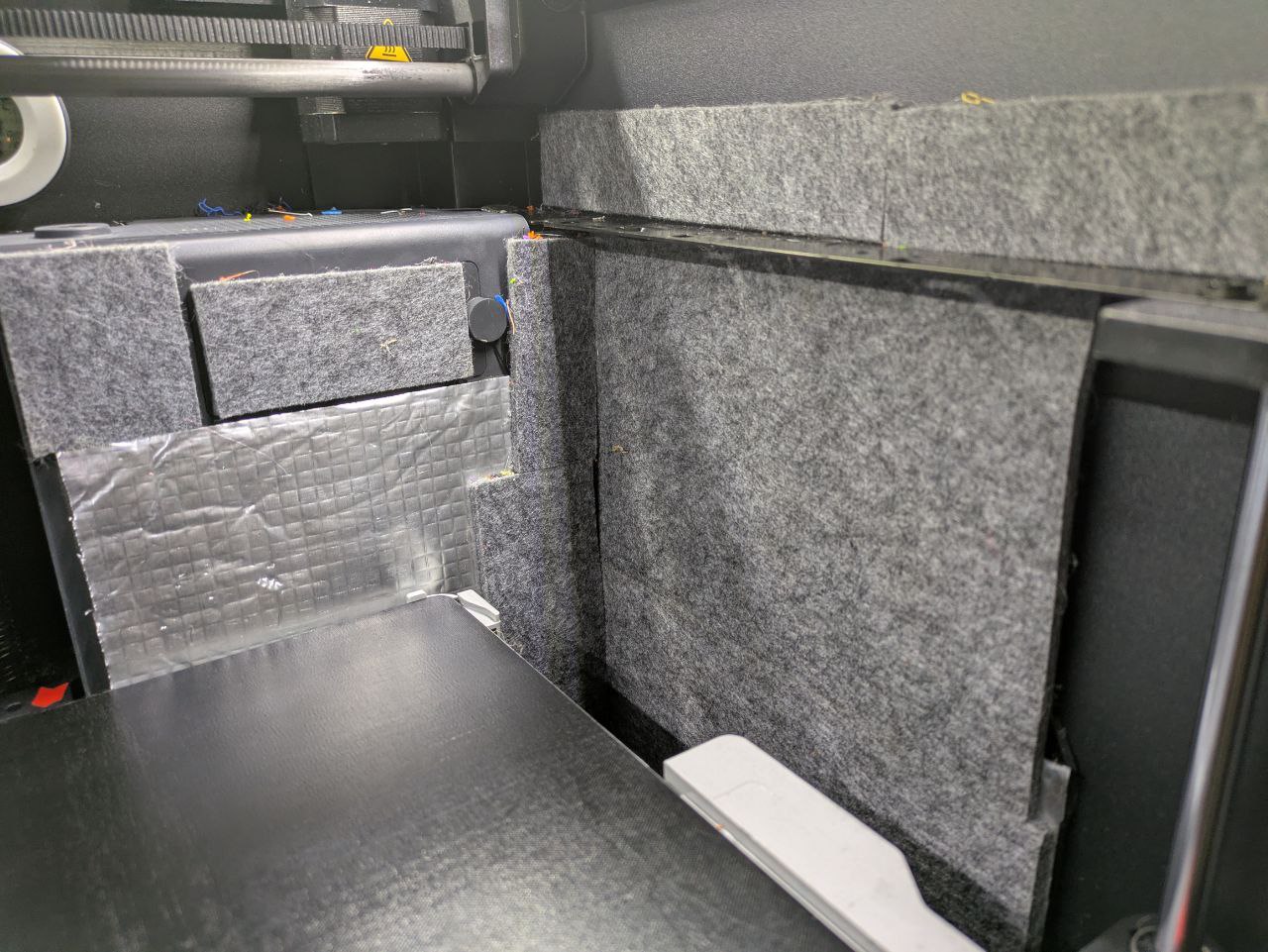

When printen small circular items, the left side of side panel vibrates and make a annoying noise. When printing exact the same thing with my P1S there is no problem.

Yeah the big thin unsupported panels act like speakers for all the vibration.
I’m taping on 700g of PLA to each side to mass load it. I did a similar thing for my P1S’s.

Problem is resolved, it was a 1 in a million case where the ‘harmonics’ of the vibrations where perfect in sync with the left side panel :laughing:. When printing the piece at different place on the plate is was almost zero the noise :grinning:.
The firts thing i printed is a circular piece and OMG the noise of this vibrations it’s horrible i work in the office and with P1S and H2D at same time printing is only a little sound without problems.
But this P2S OMG!! when finish this print i start to put sound panels inside the printer for try to reduce noise.
like this (1 year ago i put this for avoid a little vibrations in my p1s):

The fact that the leftside panel is thin plastic, it easly takes the vibrations and amplify them (just like a drum). So if you put some extra weight are add some reinforcement on the left panel will already help a lot to reduce these vibrations. Even just putting the 2e fan will help a lot ;-).
