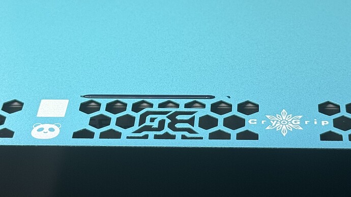

Hi, just buy P2S and already have some disappointment. I use PETG (by Sunlu) for printing, and it was good and no problems with A1 and P1S. But now with P2S i can’t understand what is happening - just attach a photo of that mess.

You could edit your prime line’s gcode to be Y + 1mm… or see if you can shove the plate forward just a smidge. You’d have to watch it IRL to see, but Im guessing it’s spitting a purge into those holes, and Various Things© are going bad from that
It looks the same on the Textured PEI Plate as well. The calibration line doesn’t go into the holes — it runs along the edge, staying about 1–2 mm away from them.
I’ll take a photo during the next print using the Textured PEI Plate.
That looks for me, like the purge is sticking on the nozzle instead of getting wiped. Is the cleaning rubber in right position an the sock on the nozzle?
Might be a stupid question but have you cleaned your bed(s) in that spot? Often if you pick the purge lines off with your fingers you will make the beds excessively dirty in that area, and nothing will stick to it.

Yes, everything is in place, and you’re right — the purge was sticking to the nozzle instead of getting wiped off.
Additionally, during the nozzle cleaning process, some of the filament was simply being ejected onto the bed.
However, everything is back to normal now and the issue is no longer happening.
I reduced the PETG printing temperature from 255°C to 245°C and added the P2S Nozzle Wiper by dedge.
Now everything works much better than it did at the beginning.

I think it’s quite clear in the photo that there’s a small piece of filament stuck to the purge line, which wasn’t cleaned off by the cleaning rubber.
