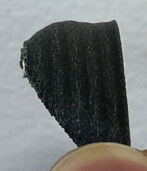

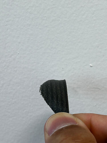

Having some wierd issues printing with Bambu PA6-GF. I’ve tried many variants:
Nozzle 0.4mm and 0.6mm (worse results)
Temp- from 265 - 290c
Speed from 30 - 100mm/s
Fan OFF - 40%
inner-outer and outer-inner sequence
Dried the filament using Ams HT for 24h.
The darker lines are slightly narrower(last picture is very noticeable), which led me to believe there may be some thermal-related factors involved… but so far, nothing has really solved the issue.
Printed the same file in PLA, no issues. Any tips? starting to consider some hardware problems, perhaps a inconsistent fan. But so far, no warnings or errors.

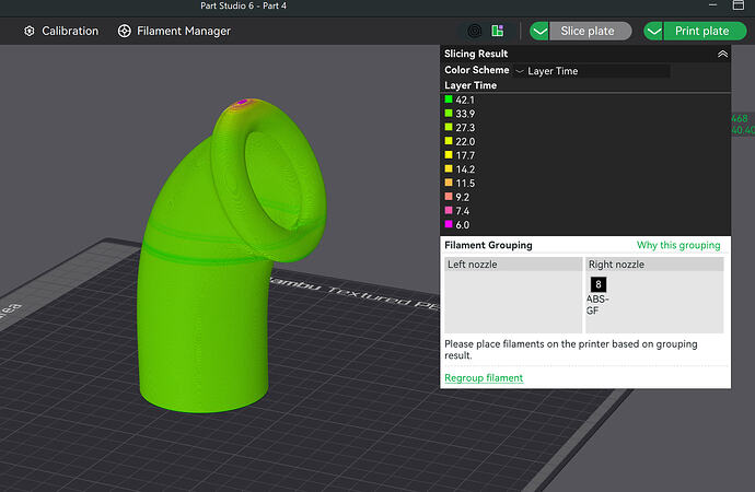

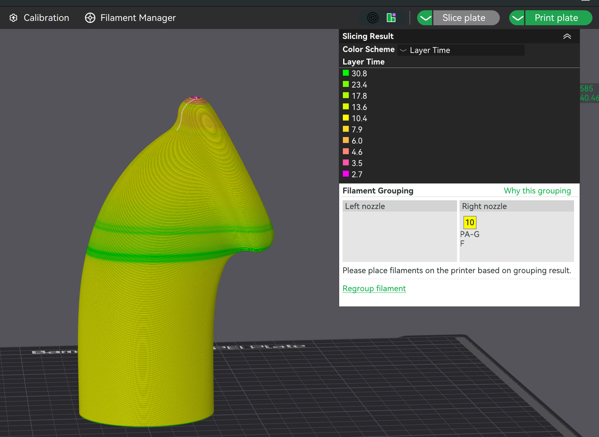

Open the file in Studio and cycle through the preview options and see if any one option looks to have a similar pattern.
For example, I created a shape and sliced it with PA6-GF and found the layer time preview revealed odd lines that could show in the print. And I’m thinking when you do the same it may be similar or identical to your lines.

layer time is really all over the place, but this is the best I could get. I increase minimum layer time to 10 and overall speeds around 30mm/s.
If that is the result for your layer time change, you might have moved the wrong minimum. The one that should make a difference will be the Maximum Fan Speed Threshold. This is what my layer time preview looks like when I change it.
However, in all honesty, I was expecting your preview to look just like your print with these lines all the way up and down the model. Your problem is likely something else. However, I would still try to get a more consistent layer time for consistency.

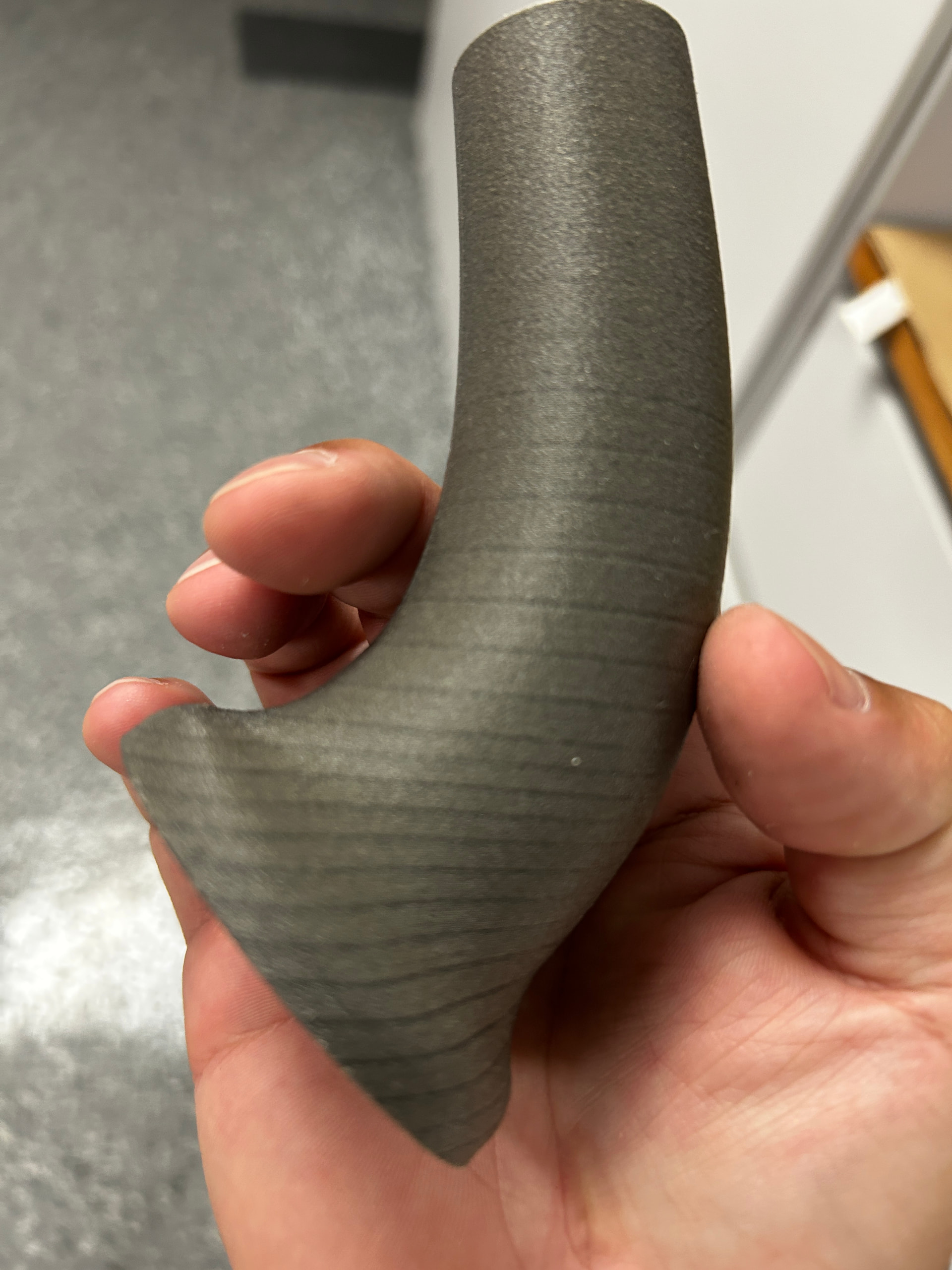

I will do more test during the week, but for now I printed the same part with ABS and it is flawless. Thanks for helping me.
What color is this filament actually supposed to be – gray, brown, or black?
My observations:
  • Bambu Lab recommends a drying temperature of 80 °C for their own filament. In my experience, this temperature is completely sufficient.
  • If the filament were actually affected by moisture, the prints would show a very different type of defect.
  • The geometry of your parts is relatively simple and should print without any issues using this filament.
  • In one of the photos, you are holding what appears to be some kind of elbow fitting. It is noticeable that the spacing between the prominent lines seems to increase proportionally as the part tapers. This could indicate that there is an issue with the filament itself. One possible explanation would be a manufacturing defect, such as an inconsistent material composition or other material variations.
filament issue. Some filaments with bad QC would print just like this. Color pigment mixing issue.
What you’re seeing is essentially the raw color of nylon (PA6).
The dark color pigments didn’t spread well enough, causing the filament to print like this.
Another potential reason is moisture. If the filament was not dried evenly, some part of it would print slightly over extruded (raw material would expand more after extrusion, causing the raw color to show more), and some part of it would look just fine (dried, so no expansion, color pigments would look even and uniform).

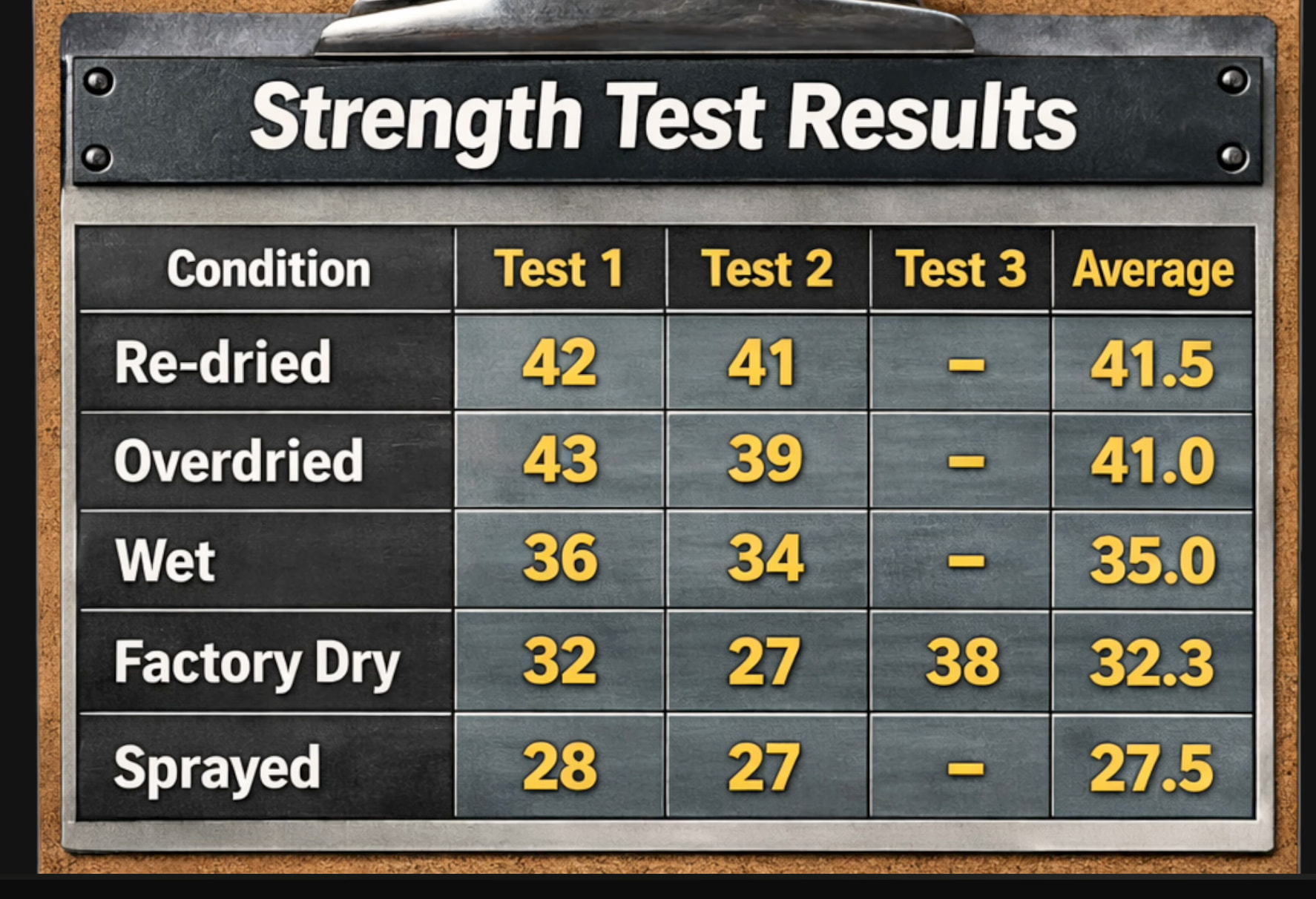

Point me to the exact video that claims dry filament is more brittle. Or any claim that any filament need some water to be not brittle.
Igor from MyTechFun mentioned multiple times that wet filament would be more brittle. I’ve been a Patreon supporter of Igor since very early days, and I don’t think I’ve ever heard Igor said anything about Nylon need some water to be not brittle. It’s always the exact opposite.
Here’s another video about the same topic.
This guy overdried nylon for 24Hrs at 80C, no it didn’t get any worse.
Unless you dry your filament with inappropriate temperature, otherwise, no you’re not going to ruin the filament.
