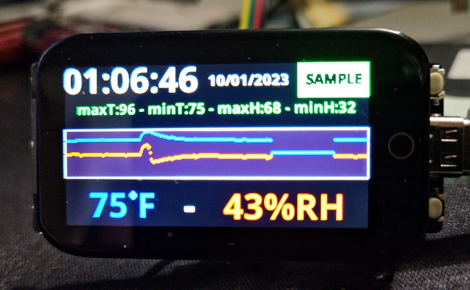

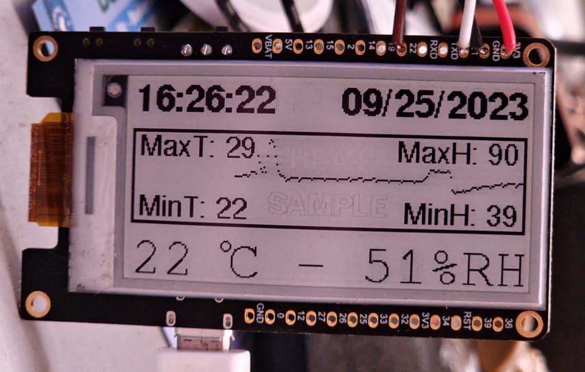

Decided I didn’t particularly like the e-Paper display, switched to color OLED.
There’s a bug in my graphing code, it leaves a gap where it should wrap. Figure that out tomorrow.
This little display is actually a touch screen. Not sure how I’ll make use of it. Maybe have some different pages with a taller graph, or perhaps an Absolute Humidity calculation instead of Relative… I have options. :slight_smile:
Upper right corner box flashed green when the data is being sampled for the graph, and it flashes yellow when the humidity sensor’s heater is turned on. So most of the time that corner is empty.

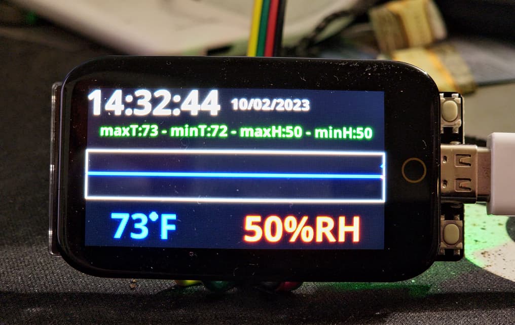

Fixed my bug with the graphing of data on the color display.

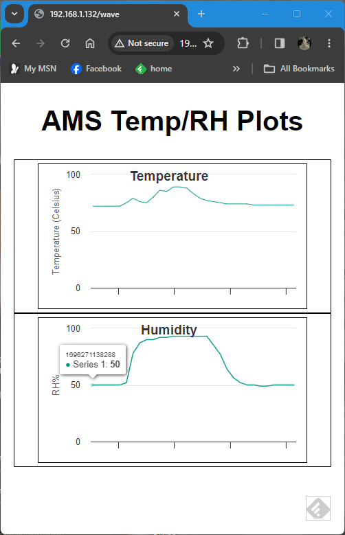

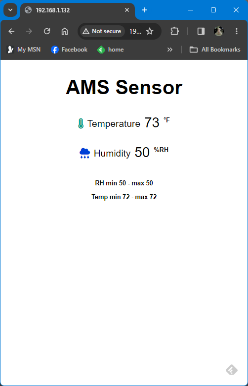

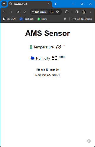

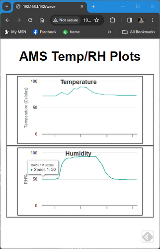

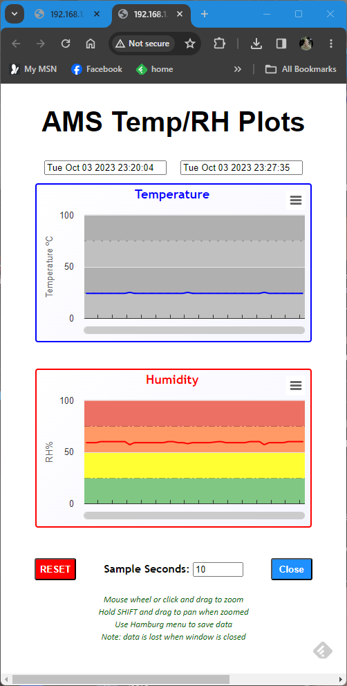

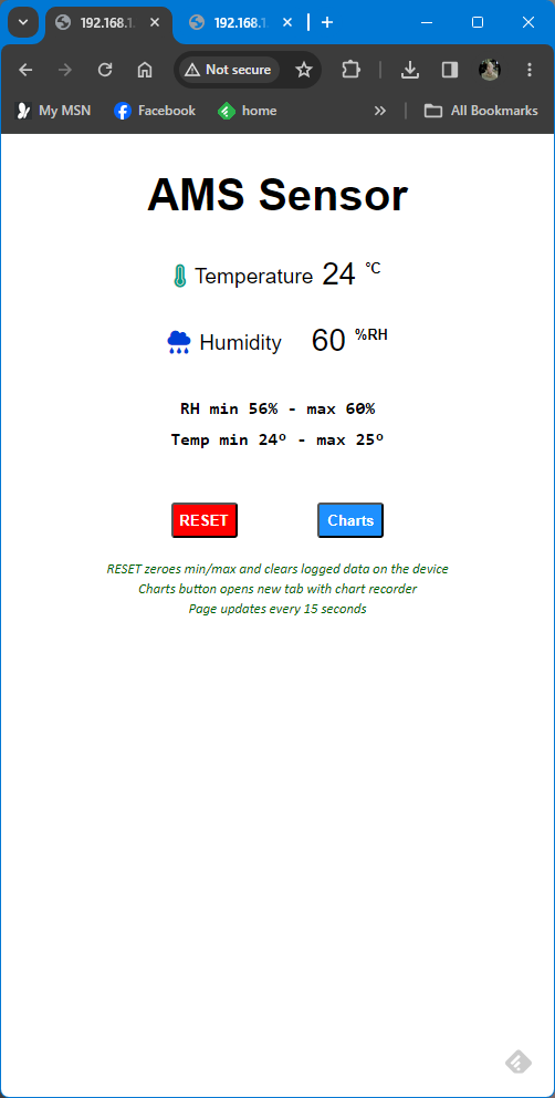

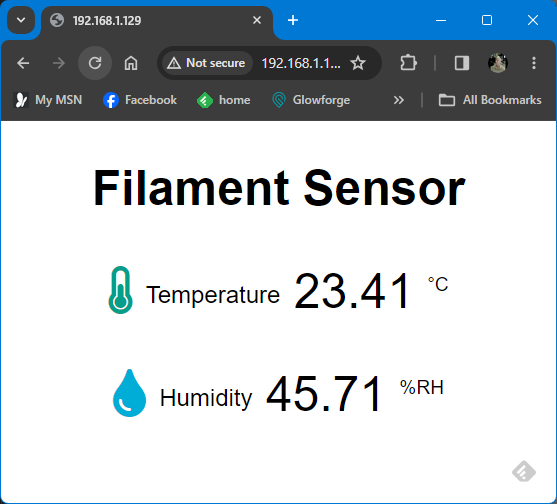

Added a webserver component. Two pages, one displays real time data with mins/maxs. The other will graph the temp and humidity data. Chart starts recording when the page is opened, and it will accumulate data for as long as it is allowed to run (compressing the existing data on the horizontal axis as necessary).

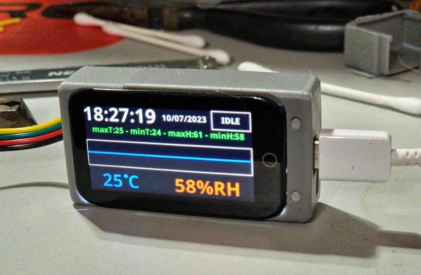

My project is almost done! Next major step is designing and printing an enclosure for it.
I realize I probably could have just bought something that does all this. But it was something to keep me distracted during the day, so I did it anyway. Pretty pleased with my results, given I had only the barest idea of how to do any of this when I started last week.
The standalone functionality with the built-in color display is unchanged from a few days ago. All my recent effort has been on the webserver functionality for the remote interface.

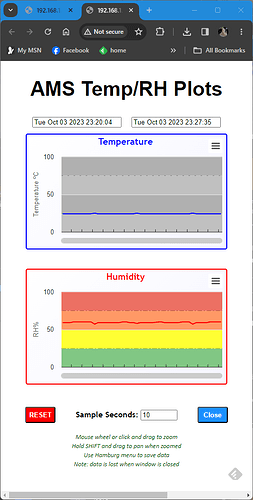

The web interface opens to the real-time front page, which updates every 15 seconds.

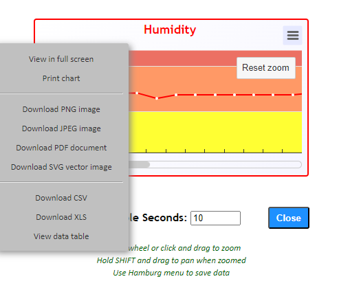

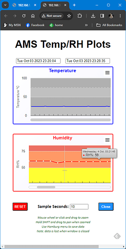

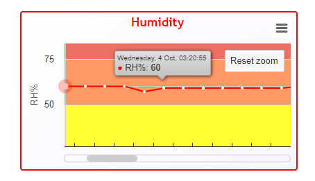

Clicking the “Charts” button opens a new tab/window with the chart recorder page. The starting time and current time are displayed at the top. Followed by a separate graph for temp and humidity. Both graphs are “zoomable”. They’ll display 320 samples, but each is just one pixel. So you can either drag a zoom box out on the graph or use the mouse wheel to zoom in, and then shift-drag to pan inside the zoomed window. Each data point on the graph pops up a tooltip box with the point’s time and value when you hover the mouse over the plot line. And there’s a popup menu to save the plots in various formats. And you can set the sample rate with the text input box in the bottom center.
The chart recorder functionality is handled in the browser. The ESP32 processor keeps track of the same data for display on the built-in OLED, but I lacked the motivation to implement code to be able to transfer all the data. Easier to just do all the work in Java on the computer displaying the data…

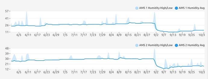

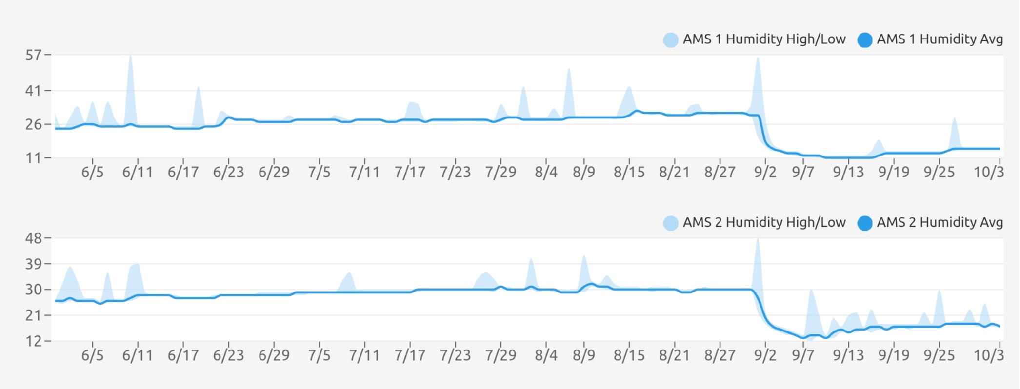

Then i can pull up the data with software from the weather station to see trends and stuff. It looks this
You can see in the trend a drop in humidity. That was a changing of all desiccant in both AMSs. All the lightblue spikes are me opening up the AMS to change a roll of filament.
Just wanted to share another way to gather data with the tools that you have at hand.

I’ll hard wire it instead of using the USB connector. But the plan is to mount this to the front of the AMS (I’ll make a hole to pass the sensor through to the inside and grab power that way, too). Need to tweak the case design a bit - it’s a download not my own design.
Did a quick test, though, slipped the sensor inside the AMS. Couldn’t close the lid tight so I didn’t want to let it sit that way long. But ambient RH was 60% and I was reading 30% in the AMS after only about 10-15 seconds (so it was actually lower). Since the temperature was the same inside and out, the AMS is actually better than 50% less humid. I was surprised it was that low. But it could be lower.
