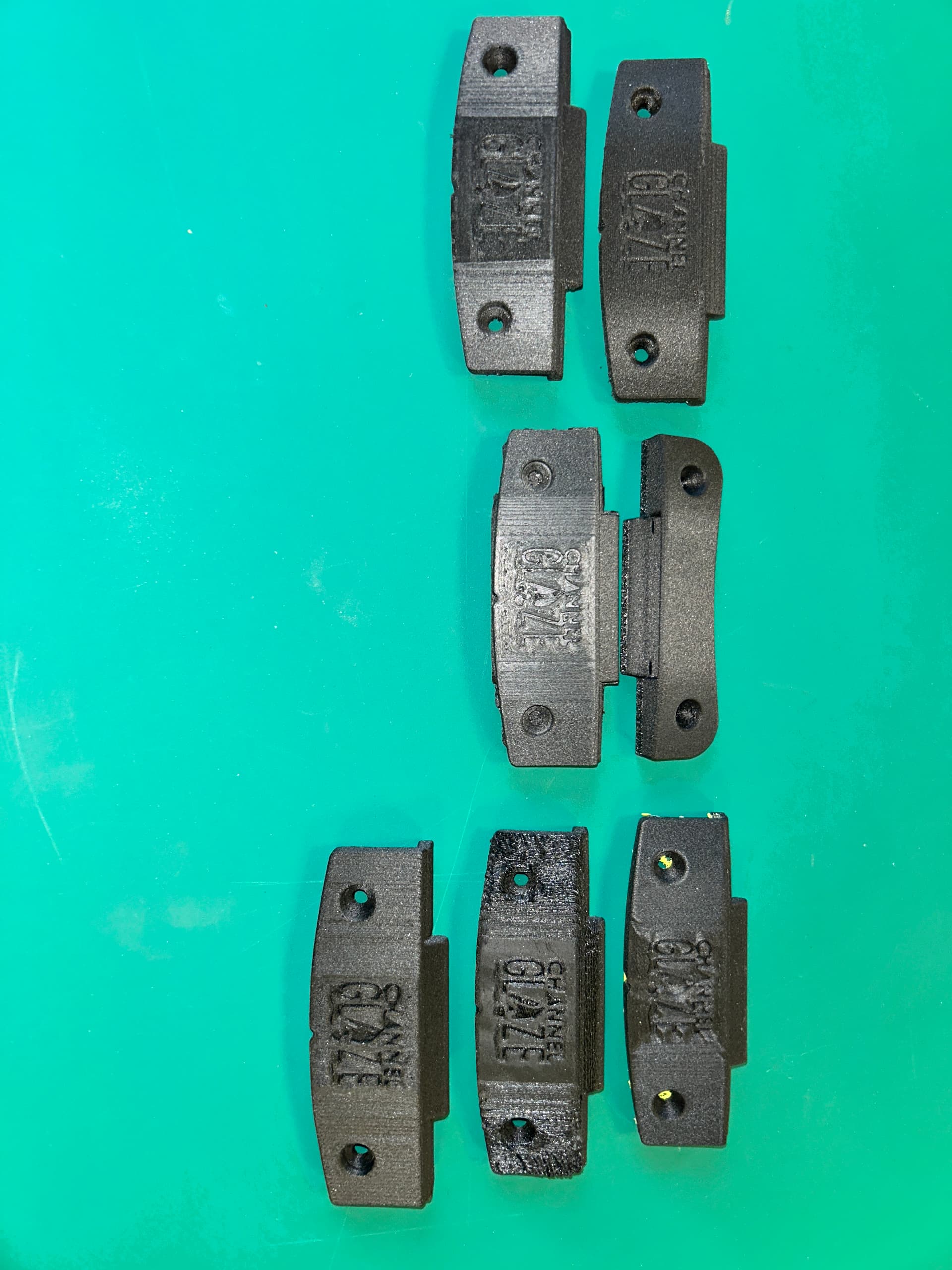

I have been trying to print our hinges which printed fine on our Stratasys Fortus 380. The issues seem to lie with our logo and a curved top surface, however another curved part of our hinge prints fine.

Just looking for advice regarding setting etc. I have printed 6 hinges now, utilising the Bambu support and also online videos to no avail.
I am also really struggling with the Bambu Support for PAHT-CF. It is incredibly stringy and seems to go everywhere but also impossible to remove even within the recommend time from completion.
Both the main material and support have been dried as per instructions 3 times now.

Filaments have been dried as stated. 60mm/s & fine 0.12mm layer height. Still not great. See image. More help required :slight_smile:
Support for PA/PET can be tricky—if it absorbs moisture, even after printing, it can be very difficult to remove. Applying some heat while removing it often helps and makes the process much easier.
That said, aside from the temperamental support material, I’ve had zero issues printing PAHT-CF on either my X1 Carbon or H2D. I’ve gone through several kilos without problems.
If you’re comfortable sharing the model, I’d be happy to test print it between jobs. I’m using a CFX plate, so I run slightly adjusted nozzle and bed temperatures, but otherwise the setup should be comparable.
Many of my PAHT-CF spools needed longer drying time than expected BTW.
IMO that last pic you posted looks good for paht-cf

It’s strange that one part is lovely and curved and this model steps rather than curves.

I dont see any problems with that print. What are you trying to improve?
