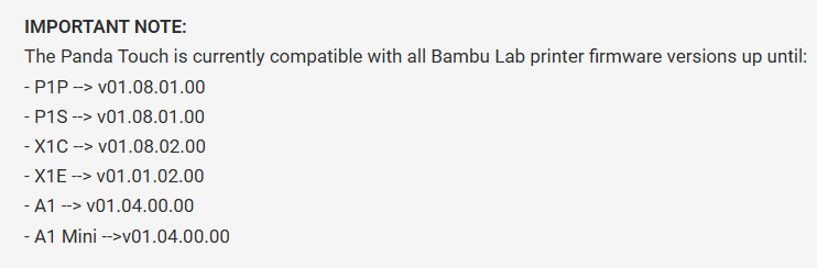

I have the bambu P1S with
firmware 01.09.00.00. and the Panda touch with firmware v1.0.5.
problem is I’m not able to control anything on the panda touch except the light on the printer.
Thanks, I’ve try this but still can’t get the panda to work.
I had to go back to 1.07.00.00 to get mine to work, with this firmware everything works fine.
It will work until you upgrade to 1.09xxx
If you want it to continue to work stay under that firmware. Go over it and it’ll show you what’s going on with the printer, but won’t allow you to actually control the printer. Doesn’t seem to be a fix in sight for that.
