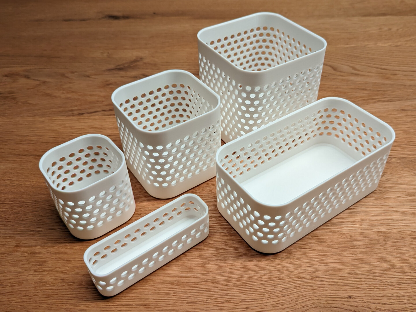

If we take this example:
The current generated filename is “Organizer Box.3mf”.
The desired filename would be “Organizer Box 150x80x60mm - Corner 20mm.3mf
This way we could generate better matching file names according to the user’s input. This could be done via a template during the upload process so we could for example reference parameters / variables that should be used in some kind of placeholder format.
