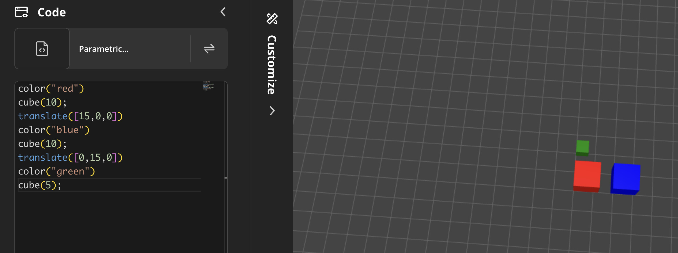

The ability to put multiple objects on the same plate
Currently, we can only place one object per plate, meaning the user has to assemble all plates into one if per-object settings are required.
Unless I’m misunderstanding what you’re saying, you can definitely put multiple objects on a single plate. If multiple objects are visible in your OpenSCAD preview, they’ll all be on a single plate.
