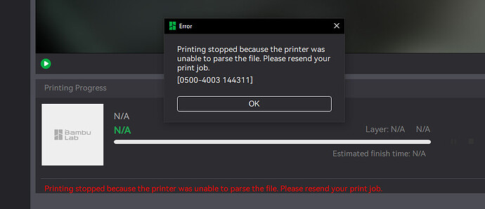

Parse Error
I have this problem lately…
Welcome to the community.
Generally this error is caused because of a corrupt G-Code file. If it’s happen often, that could be an indicator of a defective SD Card where the files are stored during print. Two remedies exist for this, the first is to simply reformat the card using the printer’s format utility accessible from the printer menu. If that doesn’t solve it, try another SD Card.
If this happens on more than one sliced job -
format SD card, try again
If still fails, replace SD card.
If its only happening on one sliced job -
attach gcode here for analysis

What about when not using a SD card. I am printing directly from the Bambu Stupido app on MAC. I will periodically see this error once in a while. However, I resend the file to the printer and not works fine. I don’t replace the file just resend and it works. This has to be a Bambu Network printing issue, no?
For the P1 series at least, that is not an option. The printer uses the SD card for cache in the same way most embedded systems would use either a local disk or NVRAM. Try pulling the SD card and see if your printer works. On the P1, you will get a message to insert an SD card. I can’t speak for the X1, P2 or X2 series.
As a side note, I believe this is part of the reason in addition to an underpowered MCU, that the P1 is so slow in uploading and downloading files over WiFi. I benchmarked it at one point and the write speed was under 1Mb/s. That’s cell phone modem speeds by comparison.
Makes perfect sense as you describe it. Thank you very much. I will try that and provide an update in once I have an opportunity to test.
Thanks I didn’t realize it used the SS card that way. I changed the ad card and problem appears to have stopped. Thanks again.
