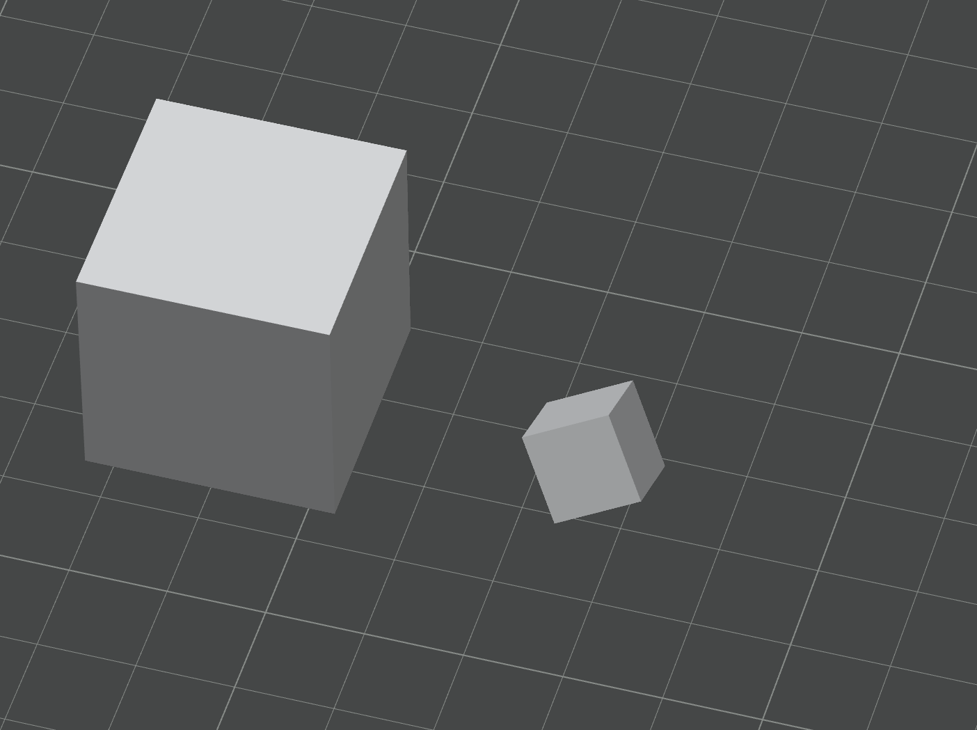

Prior to any matching

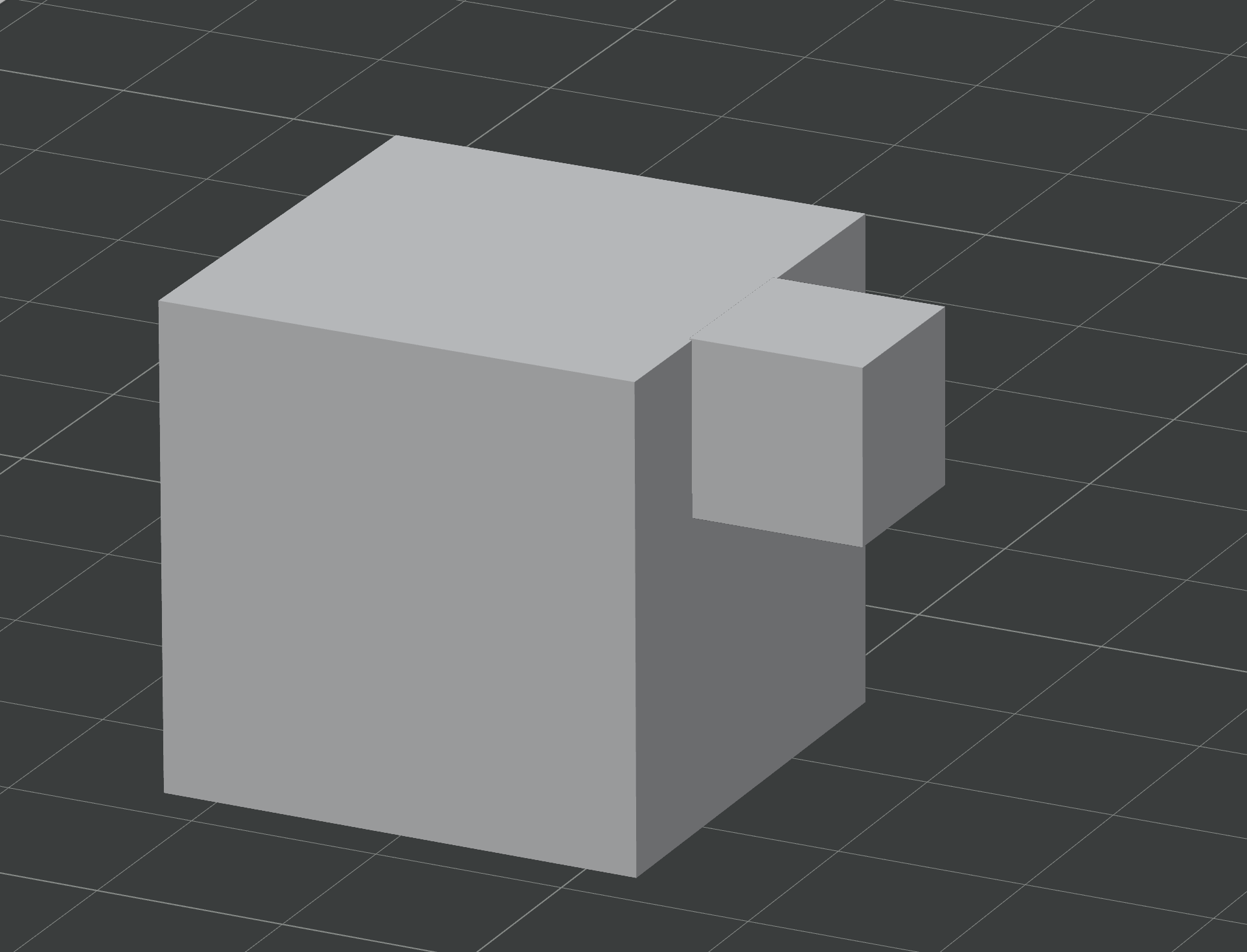

After face match

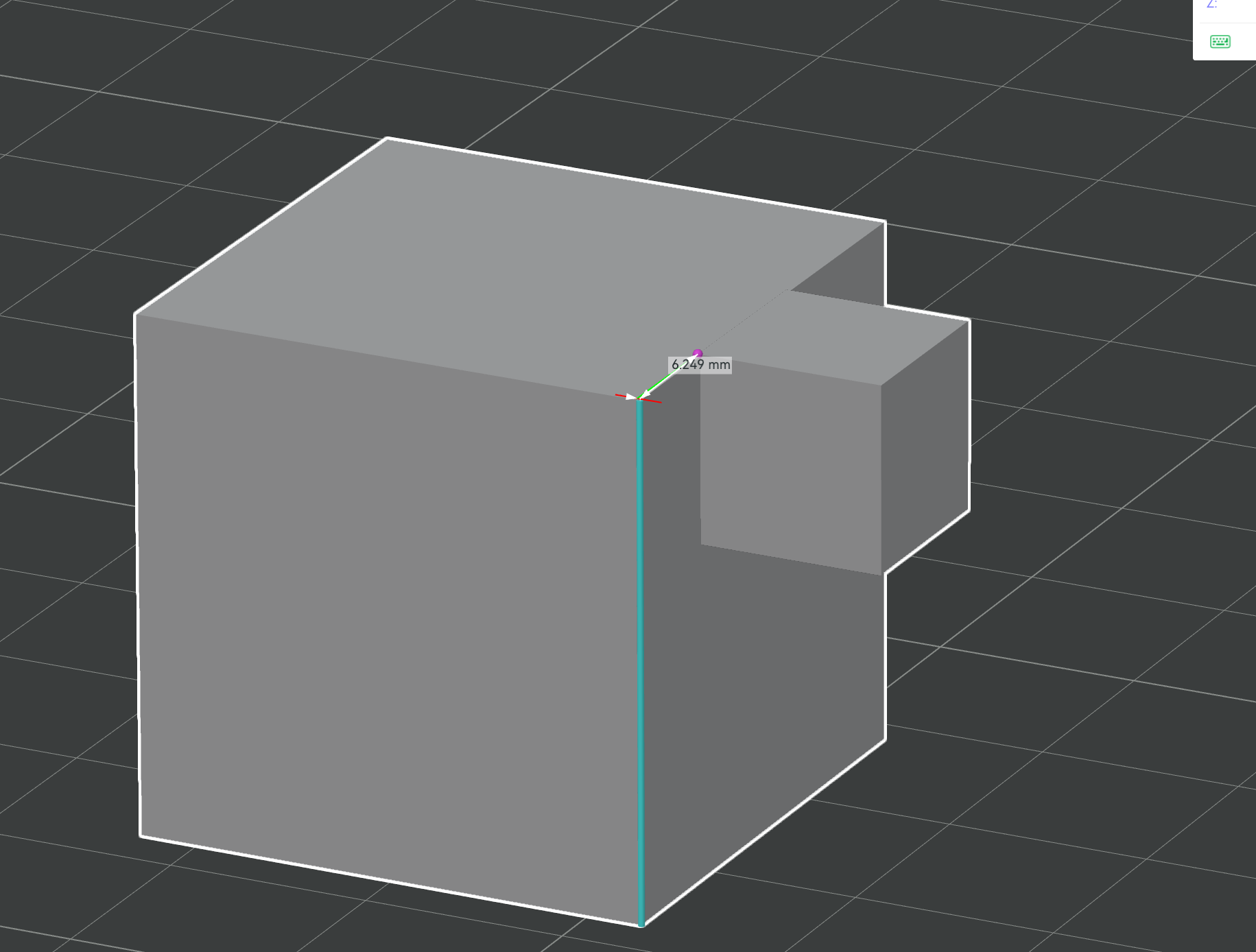

Preparing a edge/point match

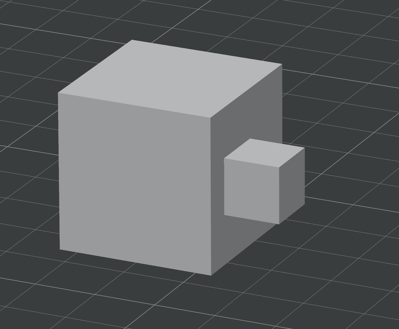

After edge/point match by setting distance to 0

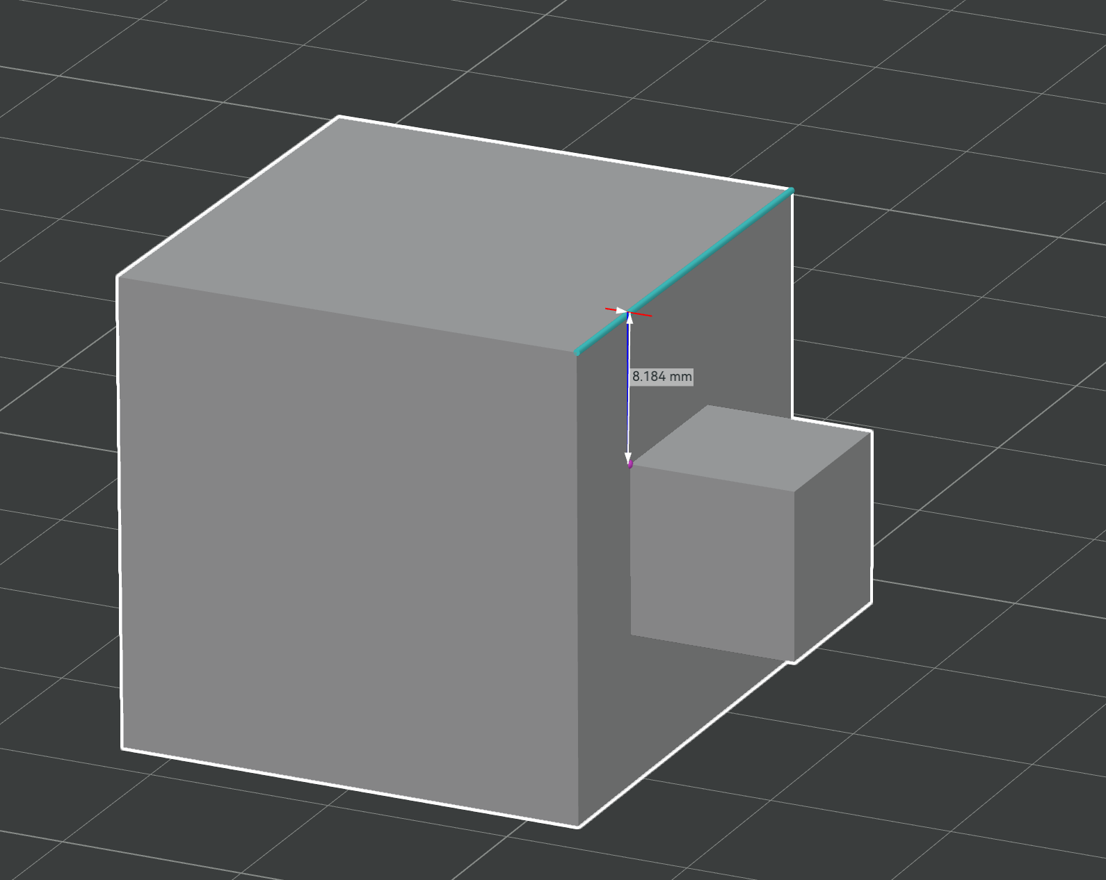

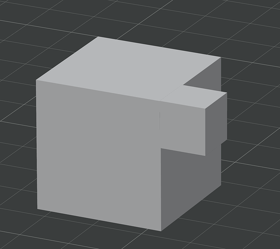

Another edge/point match

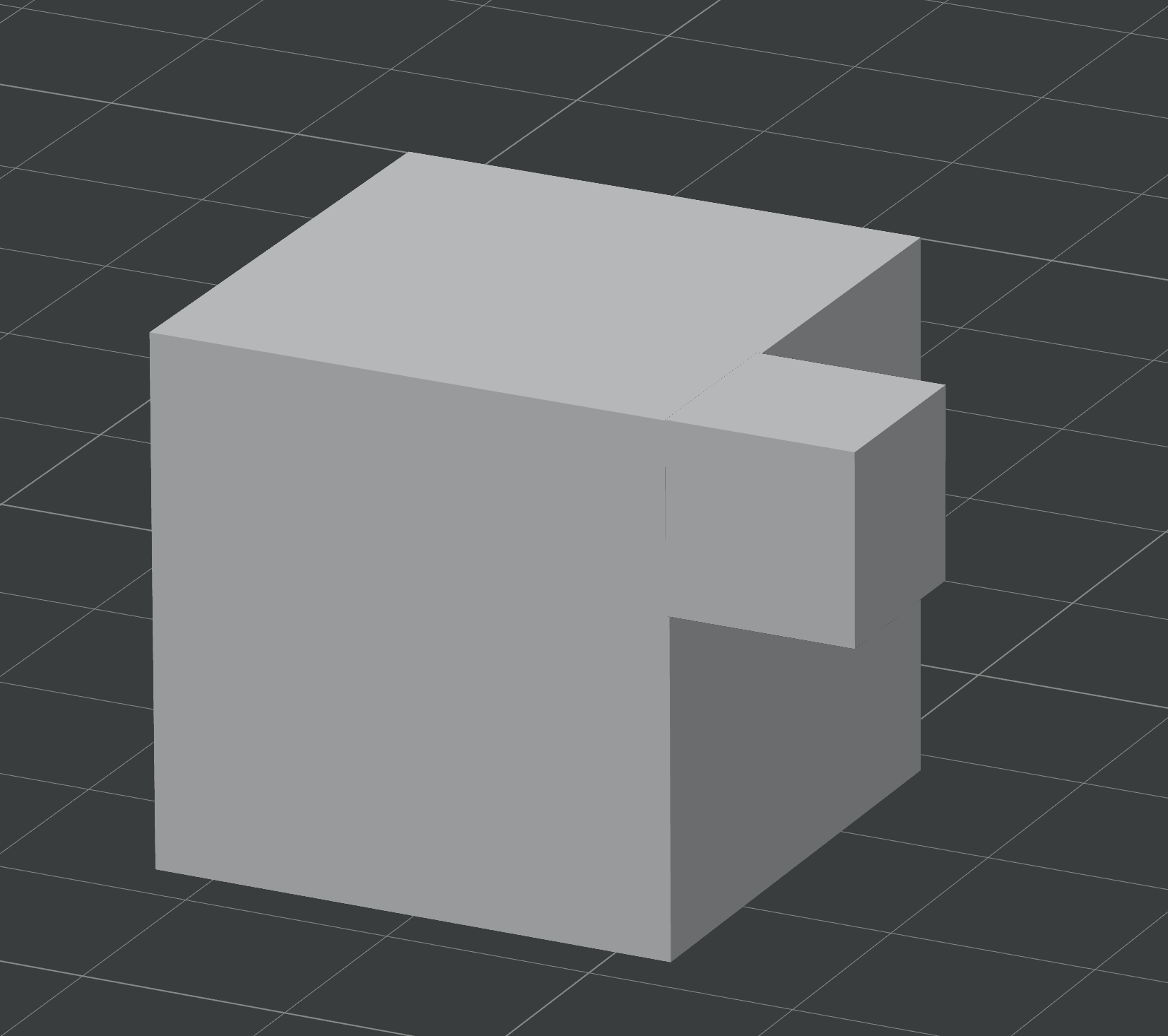

Finally, fully aligned, setting the other distance to 0 too
