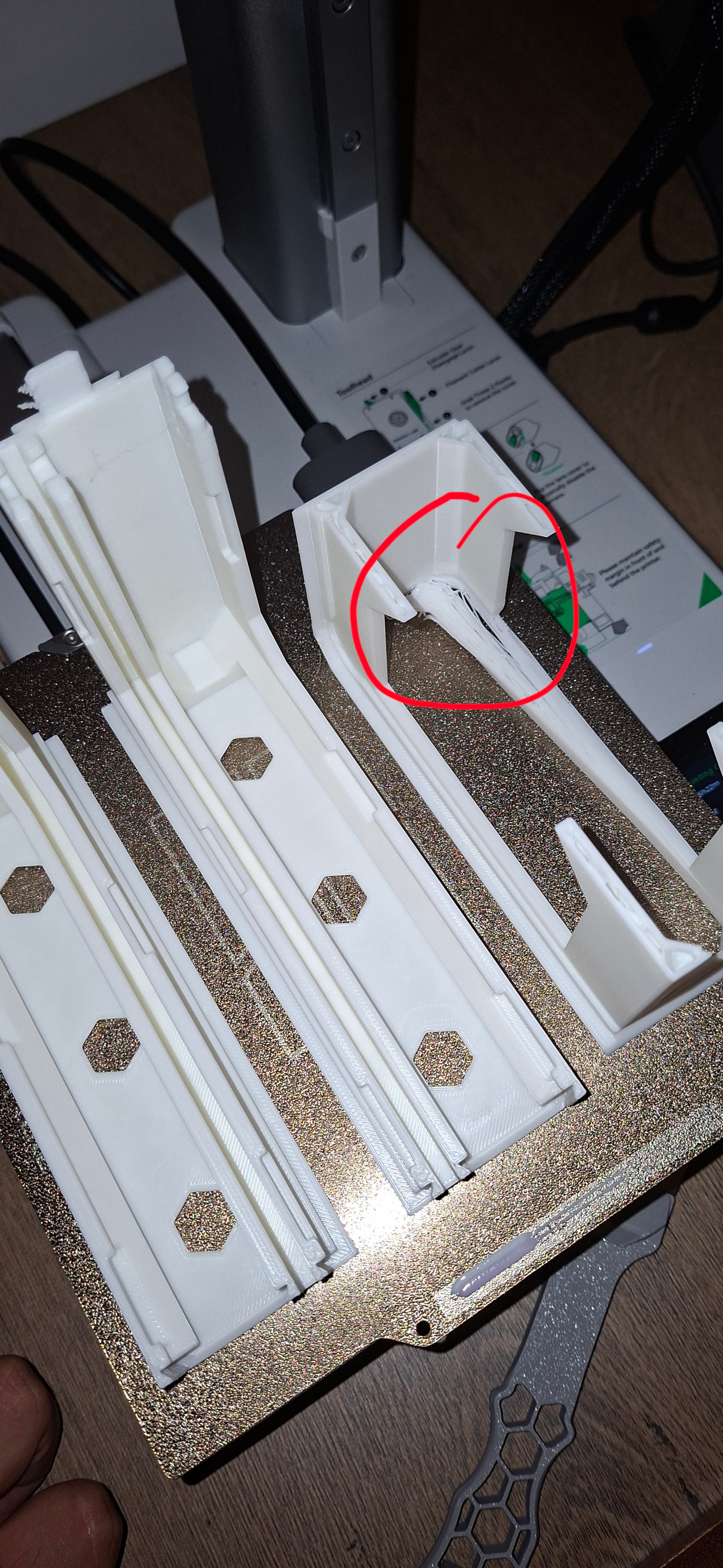

I’ve been trying to print the A1 Mini Storage Stand V3. I’ve printed a few of the parts flawlessly, but one particluar part keeps failing. The Rear Left, included in the 3rd plate.
I’m using the designer’s profile, in Bambu’s white PLA basic, feeding from the AMS lite, with a PEI textured plate.

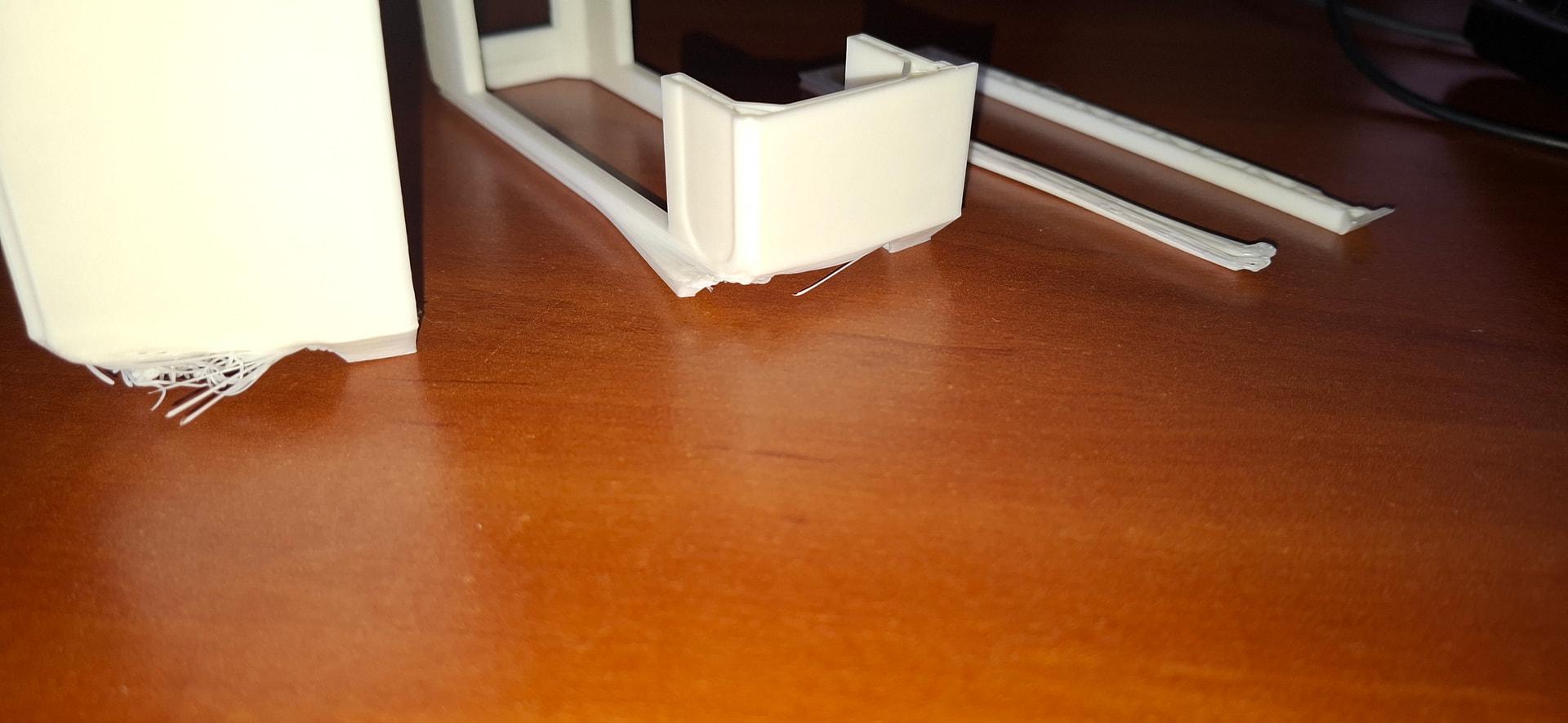

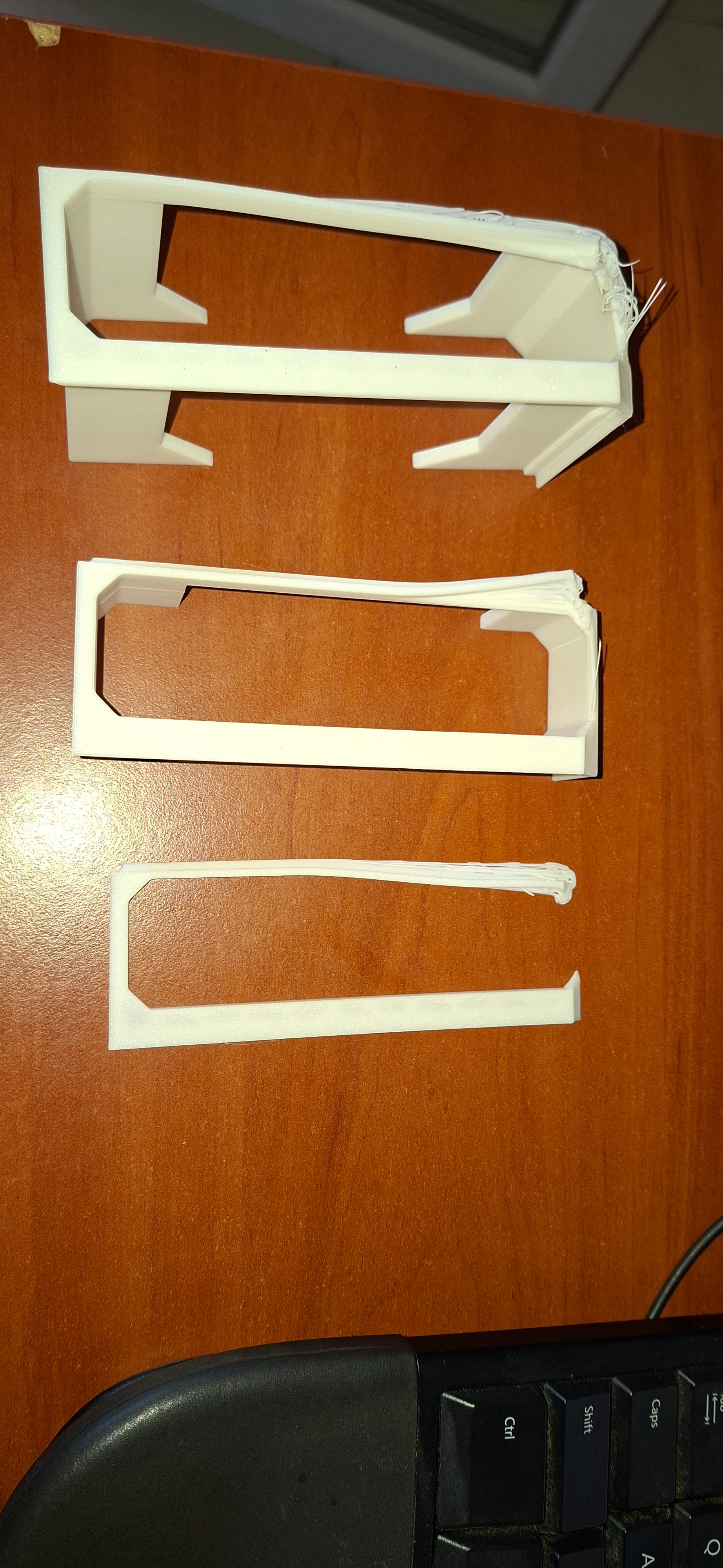

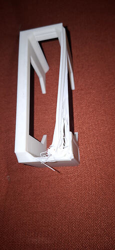

I’ve tried this 3 times and it keeps failing at the same spot. I’ve tried printed it on its own and together with other parts. I’ve used two different PEI textured plates as well. Everytime the same area fails.
I’m including photos of all the failed parts as well as one side by side with its mirrored part (rear right) for reference. The mirrored part printed flawlessly first time, btw.
What could be the cause of this? Is this first layer adhesion issues? if so, why the other parts that were printed with it, using the same material had no issues?

On PEI you can also increase bed temperature a few degrees to help keeps parts stuck down.
Also brims and mouse ears can help keep corners tied down.
Adhesion can be spotty for various reasons like fans locally cooling part of the build plate, hand oils and fingerprints, or just lots of use in a particular area.
And there the universal advice on cleaning the plate - warm water and plain dish soap and don’t touch the plate where models get printed. Oils from hands can really cause problems with adhesion.
There’s also abrasive approaches that remove a bit of surface gloss to help adhesion but that takes more care and I see it only as a last resort.

I’ve started the print again using a belt and braces approach. freshly cleaned plate, 3 degrees higher bed temp for first layer, brims.

Finally it printed correctly, with the raised bed temp and brims. Thank you.
I was not close to the printer, i wasn’t even in the room, but perhaps there was a draft from the open windows that affected it.
