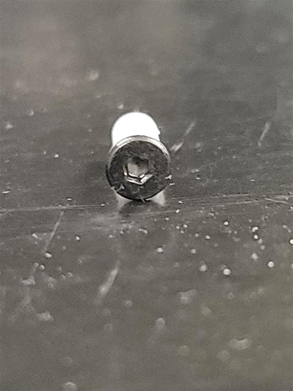

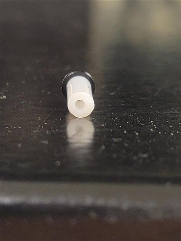

Part fell on print bed
When printing a small white post with a hex screw fell on the print plate. I can’t seem to identify where it came from.

Possibly one of two posts holding the part cooling fan to the front print head cover. Seems to be a common failure for the X1C.

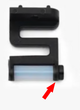

Looks like it is from the nozzle wiper that is at the side of the purge chute.
If the nozzle wiper broke, there would be a bit of black plastic under the screw head.

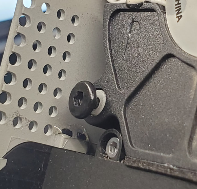

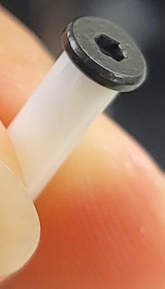

The fan mount posts are different. The fan slips over the post, and the screw should only keep it from sliding off the post. I think that sometimes a difference between the post height and the fan thickness puts too much tension on the post, causing a break. When the post fails, there is no material between the broken piece and the screw head.
Screw loosened to expose the post:
A couple of similar problems:
This is definitely the issue. Looks like the Front End Housing Assembly cracked. Front Housing Assembly - X1 Series | Bambu Lab US Store
