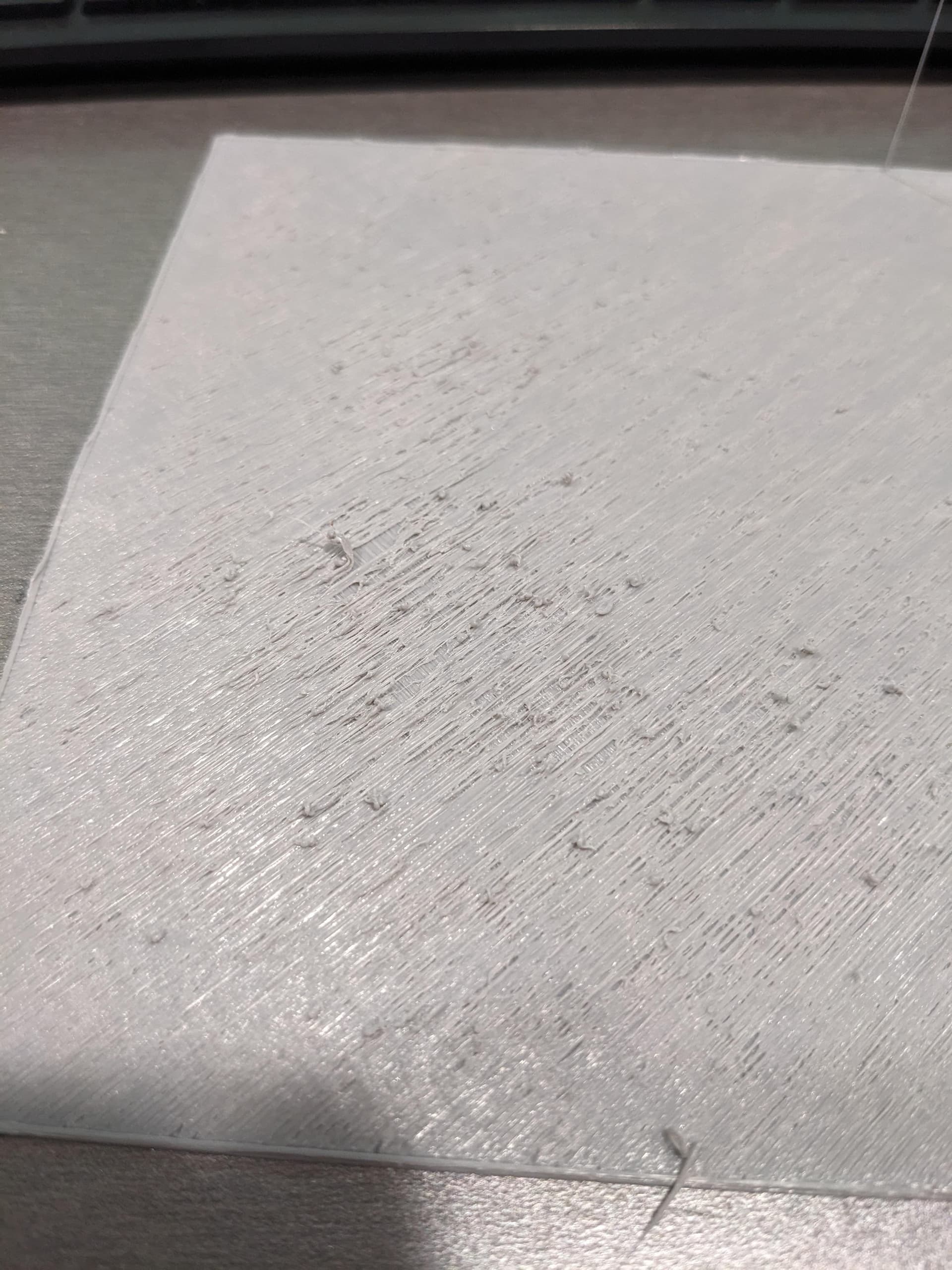

P1S PLA with default PLA settings: 220C nozzle temp. I’ve been using the Bambu Labs filament and it printed flawlessly. I switch to Overture PLA and the print quality went horrible. I used to have an Ender 3 and this brand of filament worked fine on that machine.
You will need to dial in your temperature for printing this filament. Have you tried printing a temp tower yet? The P1S prints a fair bit faster than an Ender 3 and so the filament printing settings will need to be adjusted accordingly.
Is there a temp tower in Bambu Studio?
Not to my knowledge. Makerworld has a plethora.
Alright, I’ll try. Thanks
Could start with the preset profile in Studio
