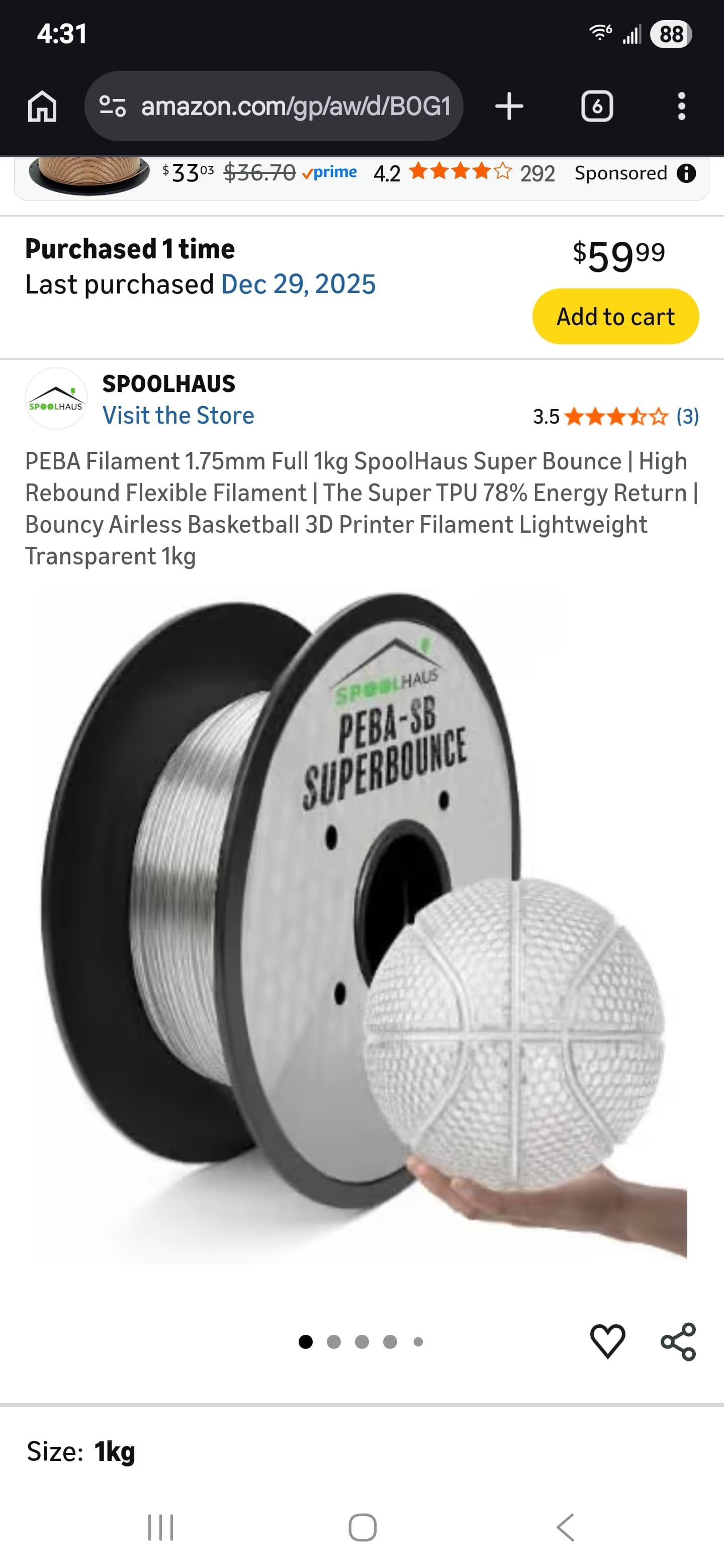

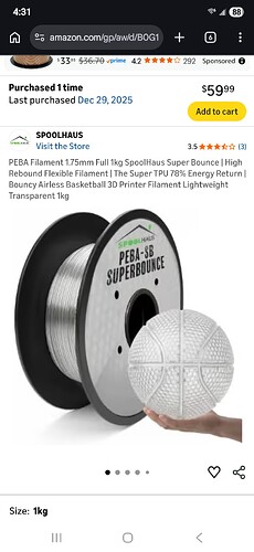

I used this peba, and concentric infill. It bounces like a basketball. I did not follow any directions. Just ran all the calibrations first.
