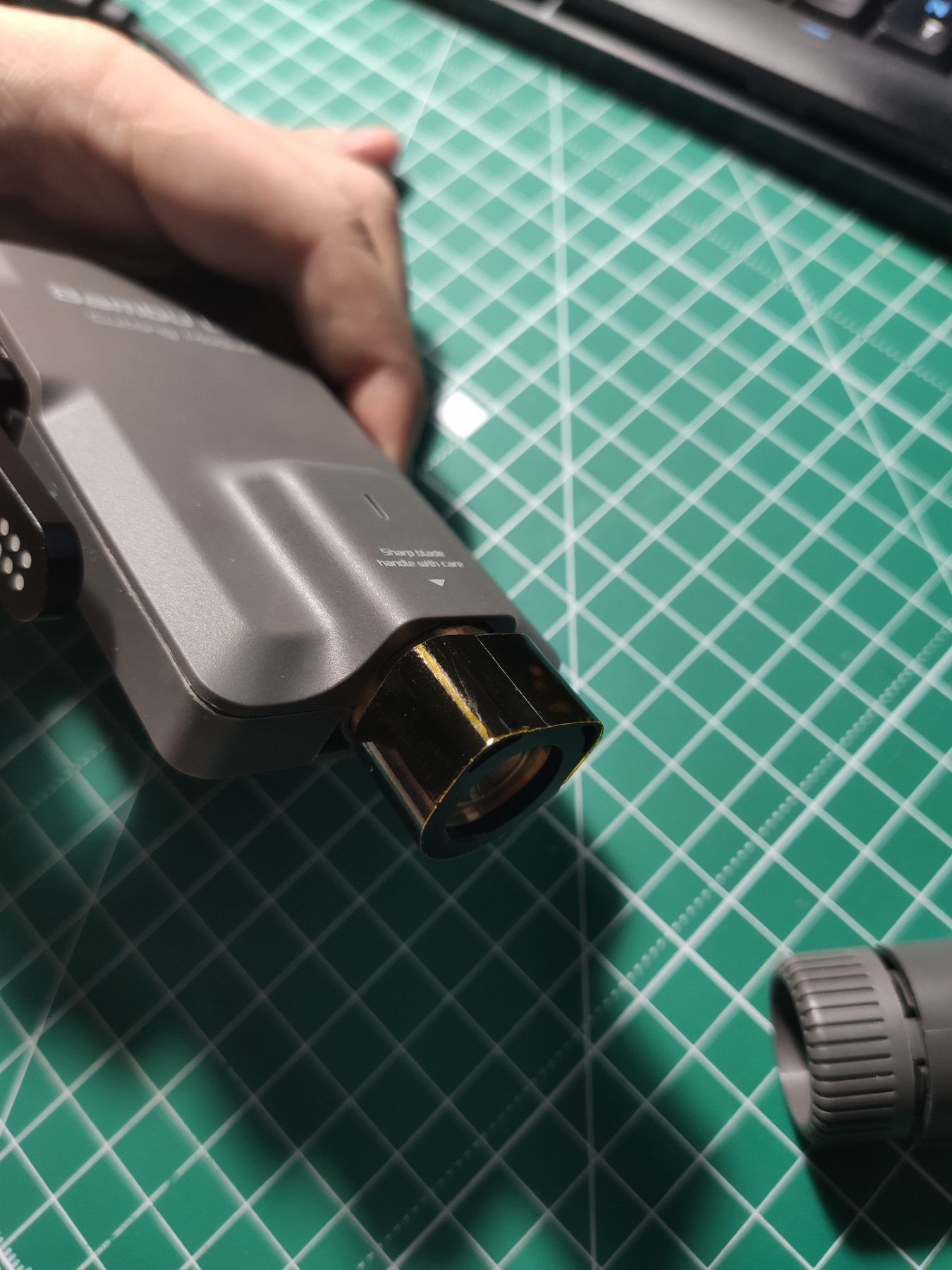

Pen Module wobbling
I significantly reduced the backlash by wrapping 1.5 turns of Kapton tape (because it was at hand). Teflon sticky tape would obviously be better.
