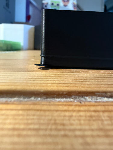

I’m printing display stands that I’ve designed myself and intend to sell. The prints are generally quite large rectangular parts (200mm x 150mm~), and I’m consistently getting one or two corners lifting during the print. The finished parts are usable, but the warped corners make them look far less professional than I’d like, which is incredibly disappointing after spending so much time designing and refining them.
The issue appears most often on corners towards the back of the machine, particularly the back-left corner, nearest the Auxiliary fan, which leads me to believe it’s an issue related to the fan but I’m trying not to tunnel vision on that because in reality it could just as likely be something else.

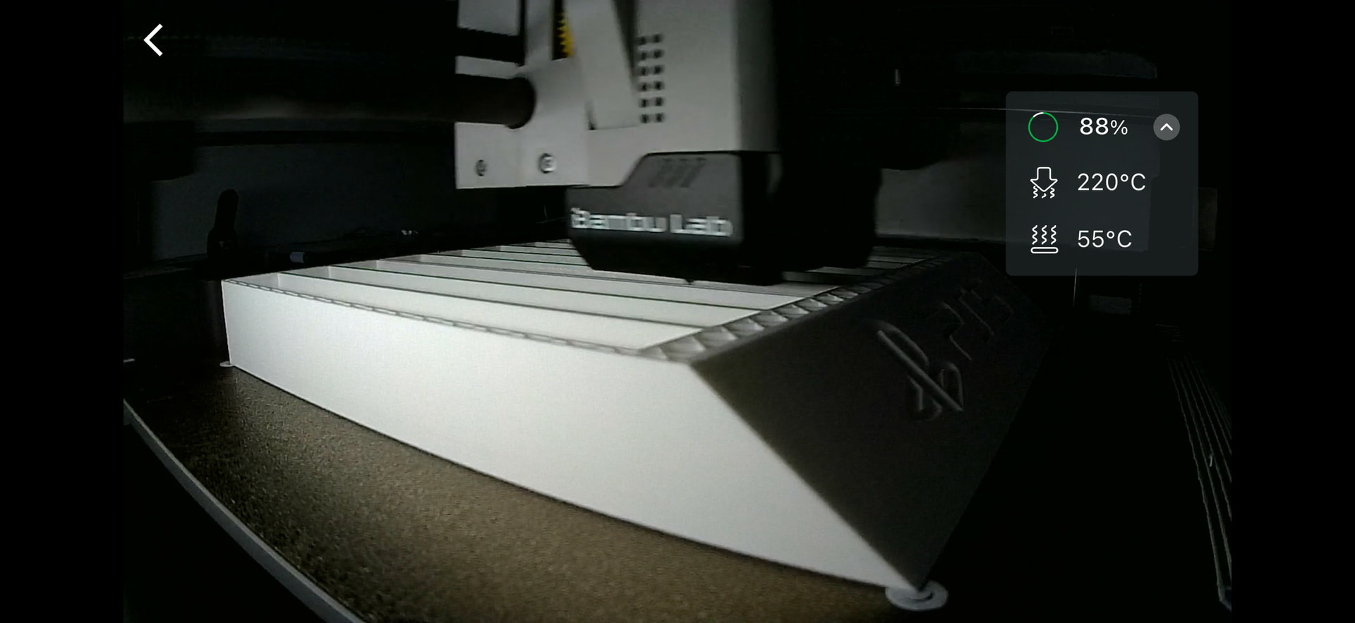

Here’s another shot of one of the stands mid-print - as you can see the front corner has lifted this time despite using mouse ears
What filament manufacturer, and what filament profile are you using?
Temperature related adhesion issue, and note the X1C does not heat the build plate evenly, it is hotter in the middle than at the corners…
My resolution to this issue was to gradually increase the build plate temp till all four corners adhere… I also use a 5mm brim set to .5mm off the build… But of course I print exclusively in ABS, it was what the X1C was designed to print… I would upgrade to professional materials as well, get away from the hobbyist materials like PLA…

AUX fan is for PLA but only for tiny items that need it, thats why its aimed at the middle of the build plate, for anything larger it should be turned off. I have custom profiles and for PLA the AUX fan is always off, I turn it back on for small items.
BL Basic PLA, and I’m using the 0.16mm Optimal preset with a few first layer changes (0.08mm with slower speed)
Thank you for the advice, I’ll try raising the bed temp by 5 degrees C each time and see if I can get the corners to improve. FWIW the first layer seems to adhere pretty consistently but it starts to raise after maybe layer 4-5(?). I haven’t watched it always the way through as it’s such a long print but the first couple of layers seem perfectly fine.

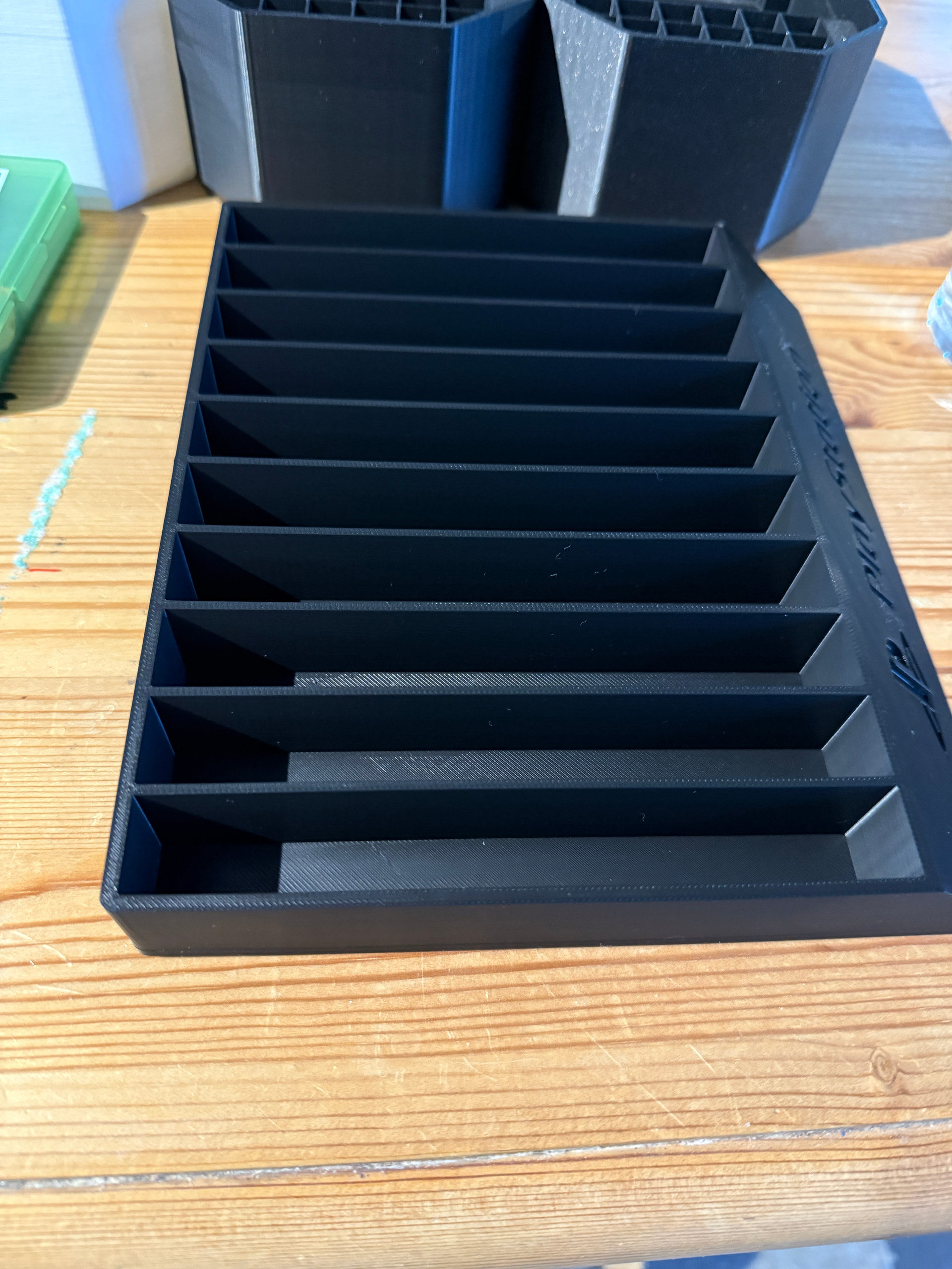

Of course, these are display stands for game cases. They’re still a work in progress but this is an example of the latest iteration:

For PLA Basic the AUX fan on 0 is the only change. For Generic PLA and PLA High Speed I also bump the max flow slightly higher on HF nozzles, no other changes. The main purpose of the custom profiles is to kill the AUX fan to get rid of the warping.
Ah okay thanks I’ll give that a shot and just keep it on for the smaller prints. Sorry, just to clarify because I think the Cooling interface has changed recently - do you just set the ‘ramp up to’ to 0%?
Yes, you just change the 70 to 0.
