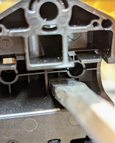

Okay, new X axis assembly arrived and I tore it down.
I actually found a way to remove the idlers without drilling an additional hole in the end brackets (do drive out the axles).
The only modification needed is to carve a bit off the carbon rod, so it can pass the idle axle. A cross cut carbide burr in a dremel makes very short work of this:
I got the assembly set up in my vise with a gentle grip using soft jaws, and importantly, the bottom of the bracket sitting solidly on the vise:
Here is where the axle terminates against a rib of the plastic:
You will want to find the largest flathead screwdriver you can, that will fit between the adjacent ribs, and get it resting on top of the axle:
Then, get something solid to support the tail of your screwdriver, so that it is just a little above horizontal. An extra set of hands would make this a lot easier, but I did it alone. You will then strike the screwdriver with a hammer, as close to the bracket as possible. You could even use a punch so that you can get extra close. The closer you get, the less elastic the collision is, so less force needed in the hammer blow.
Once the axle moves, you will feel/hear it. Stop. You can only knock the axle down flush with this setup, but it’s much easier from here. I reached in with a smaller screwdriver and pushed it down a little further. Then, I pushed it the rest of the way out with a 90* pick:
Be careful, as the axle can drop right out, spilling the idler and its tiny washers onto the floor.

Didn’t you damaged the little plastic rib that stop the axle ?
I drilled the hole at the opposite to avoid this, and to avoid to have to use force to extract the axle and damage something.

No significant damage:
I was more worried about damaging that rib by drilling through the entire bracket, entering on an angled surface, and not knowing where exactly the drill would break though.
When you follow my approach, you just set the screwdriver tip gently against the rib, and then all your impact force goes down into the pin. It’s very low risk when done correctly.
I plan to put a drop of superglue on the end of the axle, so that it gets bonded back to that rib. What did you do for retention?

Good to have an alternative approach to remove the axle.
I didn’t do anything special for retention, I just pushed the axle back in place.
