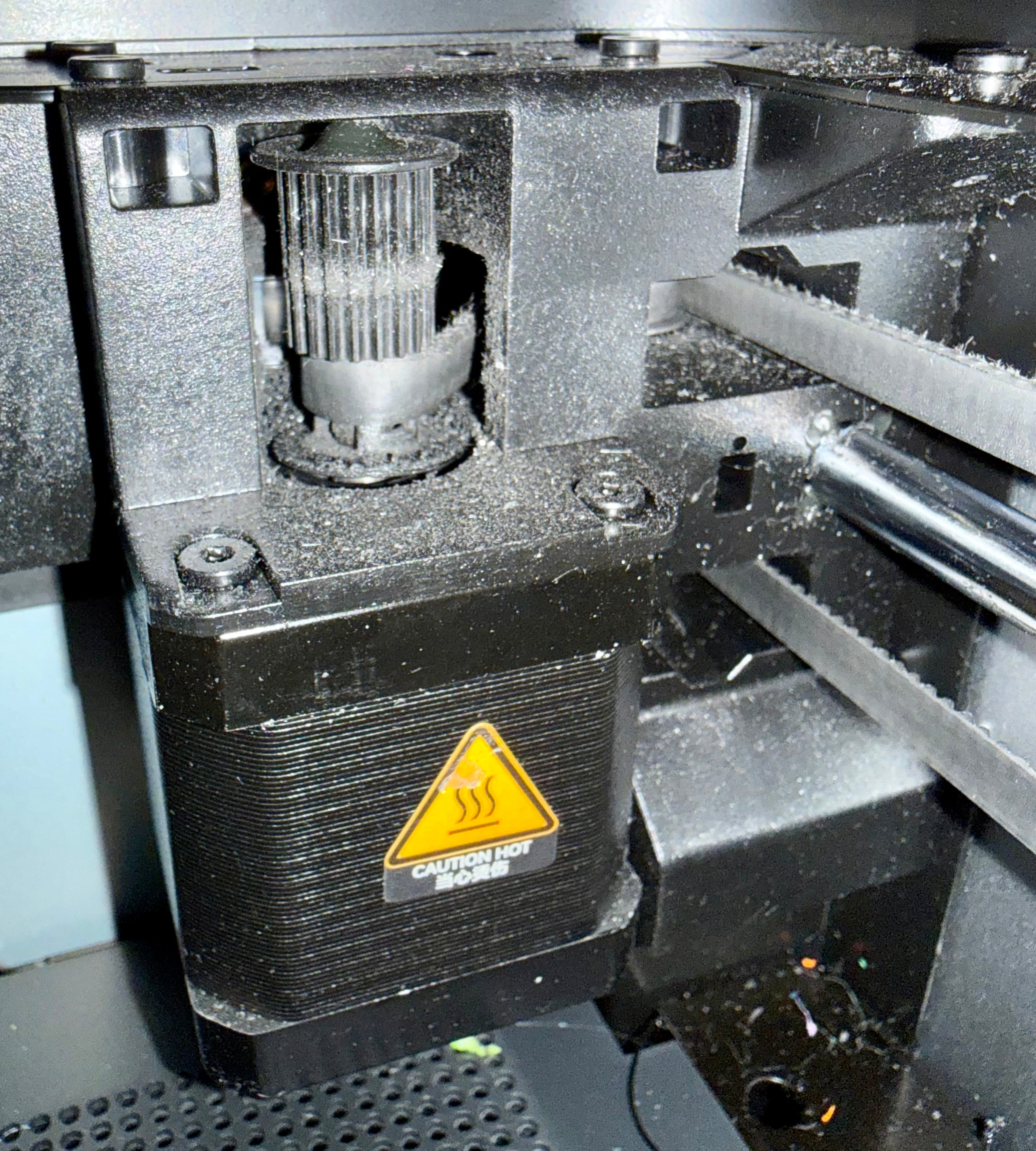

I experienced persistent XY belt wandering on the rear right tensioning idler, together with the associated squeaking of the belt rubbing against the tensioning idler flange. Officially documented belt tensioning and idler alignment procedures, as well as community guidance for slightly biasing the tensioning idler at a minimal angle did not result in a long term solution; the issue would recur every 48 hours of printing or so.
The root cause turned out to be axial migration and partial separation of the XY motor drive pulley on the stepper shaft, which created a destructive feedback loop that worsened belt tracking over time and eventually caused the belt to hop off the pulley.
This failure mode does not appear to be covered by existing Bambu documentation, despite being consistent with symptoms many users report.

  4. Belt debris accumulated, identified as such by the reflective fiberglass shreddings in the debris
  5. Eventually, the printer had a spaghetti failure of a special kind, when all regular gcode movement only resulted in diagonal movement at slightly different angles across the print bed, resulting in a very interesting failure.
  6. After a restart of the printer and an initial attempt to home all axes, it was clear that even linear X or Y movement resulted in actual movement just a few degrees off of 45º, suggesting a CoreXY failure with one axis decoupled but not moving entirely freely, either.
  7. With this in mint, I could clearly track it down to the belt having hopped off the drive pulley.
Key finding
Upon inspection, the XY motor drive pulley had migrated axially on the motor shaft and partially separated. In the below photos you can clearly see that the belt is no longer on the pulley, but also that the pulley appears to be a multi-part assembly where the bottom flange has separated from the toothed center.
For contrast, the other motor which doesn’t have this issue:
There are no visible set screws; retention appears to rely on press-fit, the pulley assembly clicking together with retaining clips, and/or adhesive.

I was able to temporarily restore function by carefully pressing the pulley back into position (although i was unable to press it all the way down; there remains a minimal gap between the toothed part and the bottom flange), cleaning all debris, and reassembling. This is clearly not a confidence-inspiring or permanent fix but will let me keep printing until I can order a replacement belt and motor.
