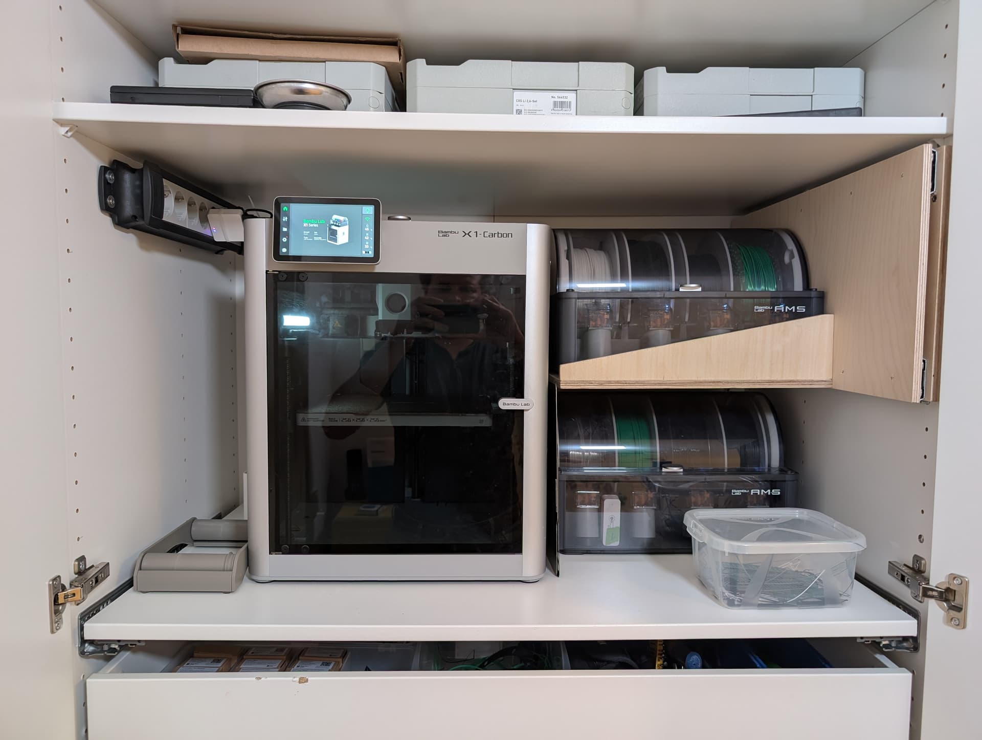

My setup has to live in a IKEA PAX wardrobe that that is 1m wide. There I have a AMS-HT for drying and as extra spool holder. behind it is the bucket of the poop chute. then comes the printer and then two stacked AMS 2 pro. That really is super crammed. I have a reinforced board on heavy duty rails, so that I can pull it out completely. But it is still a chore when I have to do something at the back of the printer.
Of course having it inside a wardrobe makes it extra difficult to access, so please just take my example as a worst case. But even on an open surface, I would see 1m x 50cm as the absolute minimum for a setup with AMS on the side.

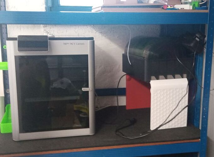

my X1c is on a metal rack, stuck under a basement window
my choice was very limited, so I 've bolted the metal rack to the wall, and redone the window peripheral insulation : no wind I can feel, but the temp goes quite low in winter.
dimensions are 120cmx60cm (50cm would be enough) and height is about 5 cm more than the printer

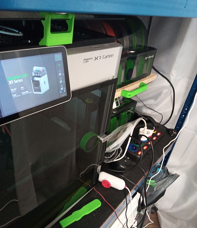

only positive is I’ve got access from the left side, and can lift the upper shelf when I need to reach through the top of the printer
to change the AMS spools , space was so limited , that I was struggling even with pulling the lower AMS on rollers
I had to creat a shelf system moving the upper AMS forward and downward
I used some table hardware and a few printed parts :

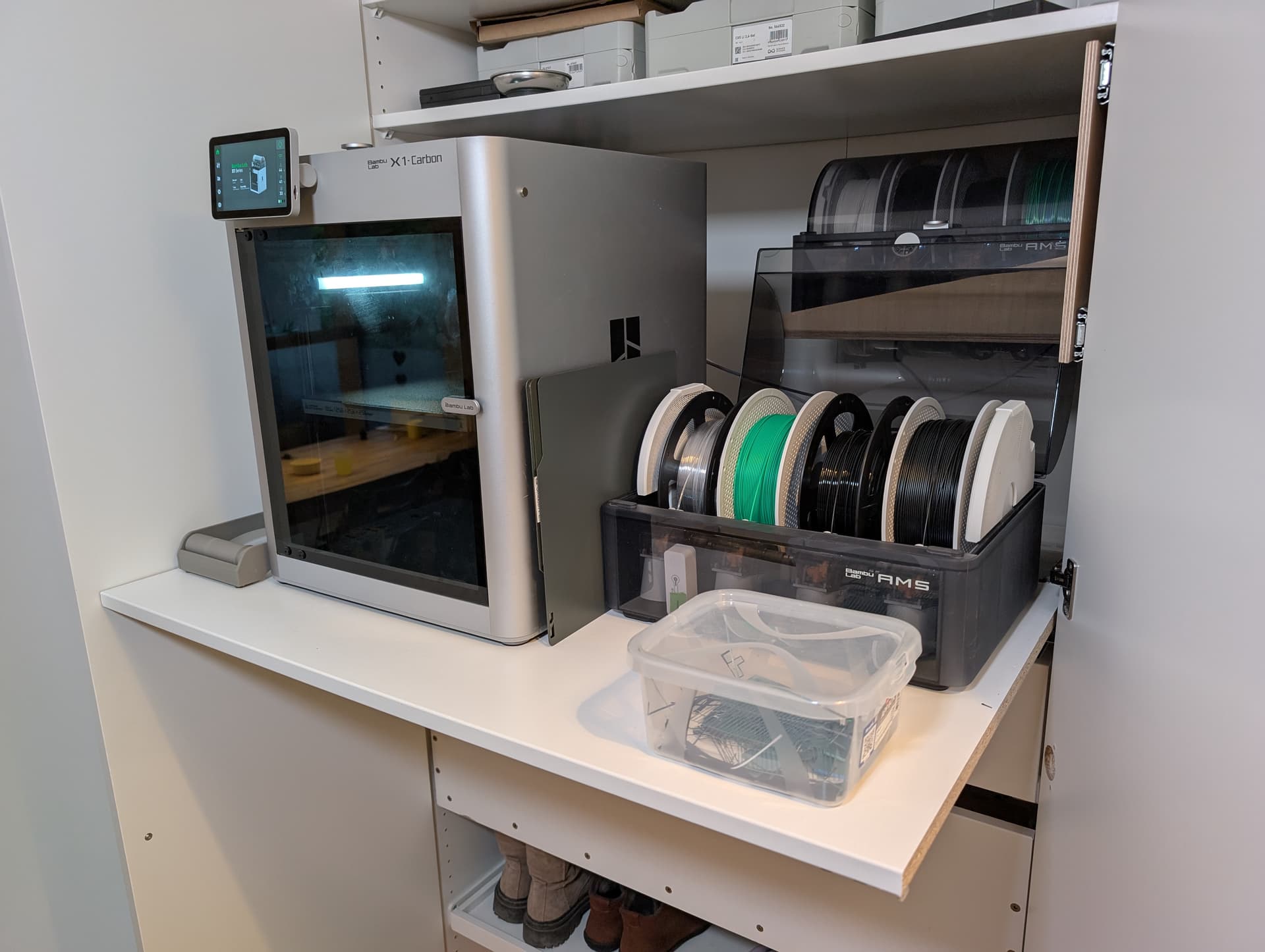

I have tried to optimise space usage as much as possible:
The spoolholder on the left now has been replaced by a AMS-HT.

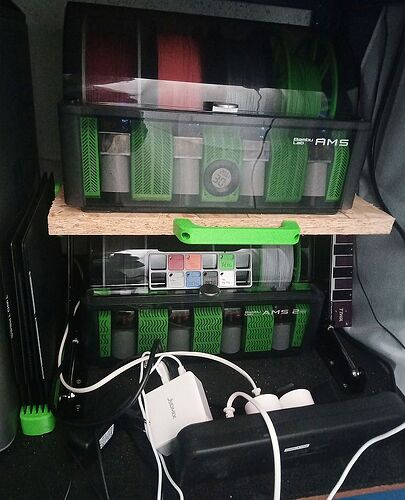

The rack is 60cm deep, and the mobile shelf stand is screwed about in the middle (I’ll get more accurate measurements)
The idea is to keep some room at te back to be able to stack the power supply , and reach easily in the lower AMS
When the mobile shefl is pulled, the upper AMS is further than the shelf itself : I’ll try and get better pictures in the open position

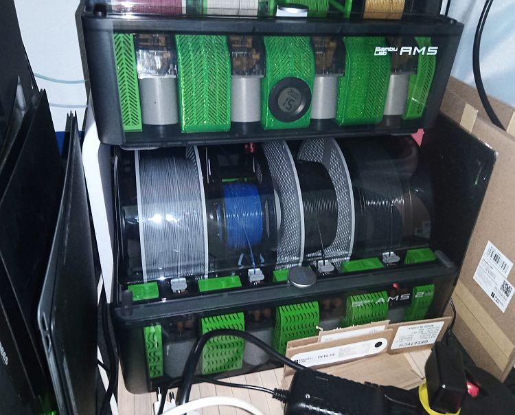

upper AMS in normal position
upper AMS in forward / low position
upper shelf is 20cm from the front of the rack
when pulled forward, the upper shelf stands about 10cm in front of the rack
