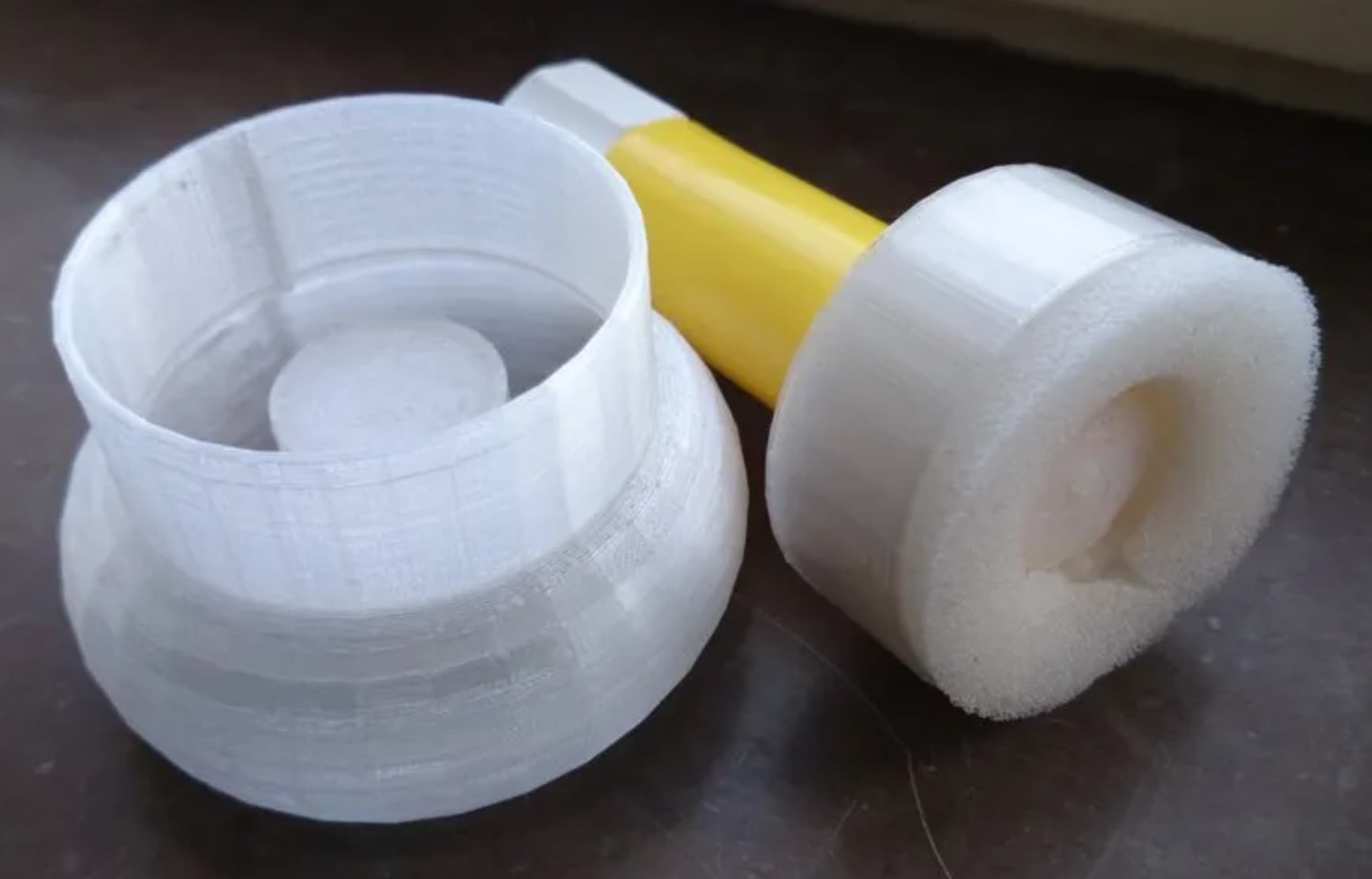

If you decide to use a glue stick, try using a very wet paper towel or sponge to spread the paste glue around. This will smooth out the white paste and give you a very thin coating, which in my experience is just the right amount.
There’s even a clever applicator that one maker created on printables.com. I have not tried it myself, but I like the concept.
