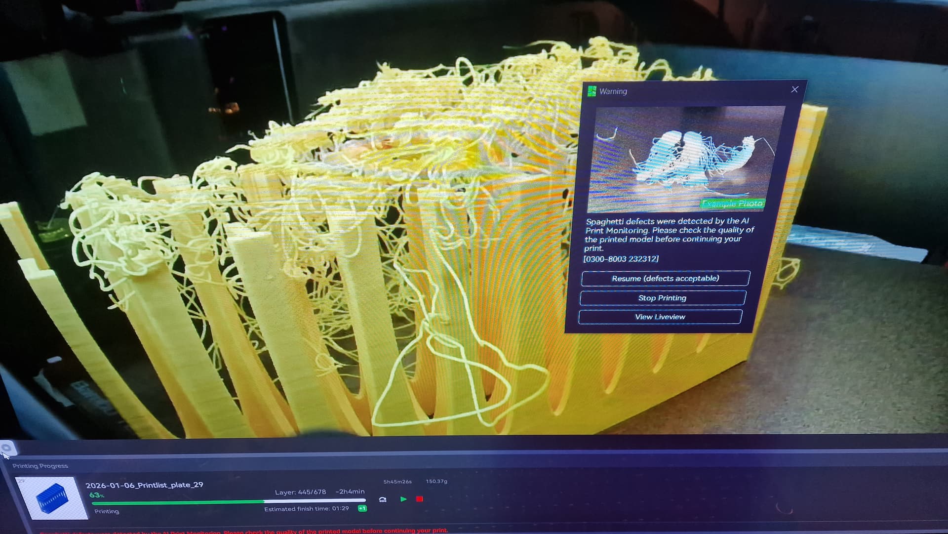

PetG buildup on original 0,4 nozzle X1C
First the obvious, it is high quality filament and it is dried. Cracked open new rolls and rolls of different colors, all dried. Still get buildup on nozzle and end up with horrible malformities and have to ditch the prints (every other) as some are beyond usability.
Howdy mates, suddenly starting to get blobs on the nozzle printing out the same PetG brands I printed out since the dawn of my dual X1C’s. (Easily have +700 rolls PetG through the set pair, maybe a few rolls other filaments the first printer/first week.)
For settings I have run over 700 rolls with 3-4 walls, 25% infill with the only real toggled alternative support or not support and different kind of supports if necessary. Standard speed, pherhaps 2-3 rolls on Sportmode for the heck of it to impress our buddies to upgrade to Bambu printers. But nothing more exciting than that, not that I can think of anyway. Mostly been interested in great print qualities so thats about where stayed within my comfort zone/limits. And it worked so far…

They both started behaving this way at the same time a couple of weeks back.
Pre-emptively dried and tried eSun, Stronghold, AzureFilm, Radius, RED and Sunlu and ALL with different rolls/color within each brand…
Might add blobbing occur in both current and prior firmware, using the standard setting 0,2 OR my tweaked setting for each filament. If temp is the issue this it is so both in prior and current FW and in different nozzle settings, standard and fine tuned settings, also occuring in both printers at the precise same time. Feel like I’m missing something bloobby obvious, but like I said on a migraine since thursday. So mates youre definitely the bosses of these printers and printing whatsoever at all, nothing you cant figure out (learning from this awesome forum) and I really need your sharp minds if you so kindly would share your thoughts or what next step you would take?
Thus I turn to you mates, am at my wits end, and I need your expertize.
How do I solve the blobbing issues and make them behave as wonderful as they have up till recently?

You say you’ve dried the filament but don’t give any details how. The problem is many use procedures that don’t actually dry filament well. The key things you said are that you saw multiple printers exhibit problems at the same time and PETG. PETG loves water. If you didn’t update firmware or software, it is likely something else common to both printers like filament. PETG shows water effects easily if not well dried. It also gets sticky and curly and can stick to nozzles. Thing is your issues line up a bit with water.
New spools aren’t a fix/known either. The plastic bag is semi-permeable to water and the silica gel they pack with a spool may be “wet” by the time you open the spool. There’s an easy humidity test you can use to see where your filament is water-wise. Seal a spool and hygrometer in a ziplock bag and check the humidity after it stops changing. Ziplocks themselves are semi-permeable but short term for this test won’t matter. Curious what numbers your filament generated if you are willing to do the test.
No idea on the build plate strikes. Maybe it’s something else for that or all related.
Given it is happening to all filaments then:-
Definitely worth a fallback to previous firmware just to prove it is firmware or not.
Also check that all your settings in BambuLab are as previous BambuLab version. I always keep a copy in Excel for quick comparison.
Check your strength/ infill wall overlap is set to 15% or less. Sometime you get a bulldozing effect over x layers; this will lead to a build up of filament, especially if a tall project.
You do not say which brand the filament is but check the purging / flushing is as before or pressure.
Only if firmware was updated recently though and it could fit with before and after issues appeared. If no firmware update was done then it’s likely not a firmware issue.

I can tell you one thing for sure, wet petg gives bad walls and some stringing but nothing like that.
If I have to place a bet, I bet on a crippled custom gcode, not in the printers panel.

theres actually two issues from the buildup etc 1 is the grinded golden textured plates 2 is that the sudden blob issue hitting the scene messes up my prints and turn them in to various spaghetti monsters/layershifts/knock objects off the plates.

Status quo; I ordered some silicone pads for the A1 and printed out some version of upgrades “Nozzle Wiper 3.4” asf, will try these and see if they help out any. (Now the wiping is only in the start of the print but that slow blob buildup seems like an unstoppable happenstance thus fear these will not help. Well that and possibly damage new nozzle assemblies?)
Prints are somewhat better now, but I’m not getting those shiny perfect top surfaces, but the spaghettimonster does not appear with the same tight intervalls, I can get a pair of printplates out with single objects before whoopis rasta shadows beseiges the smoked door glass of the X1C’s :slight_smile:
