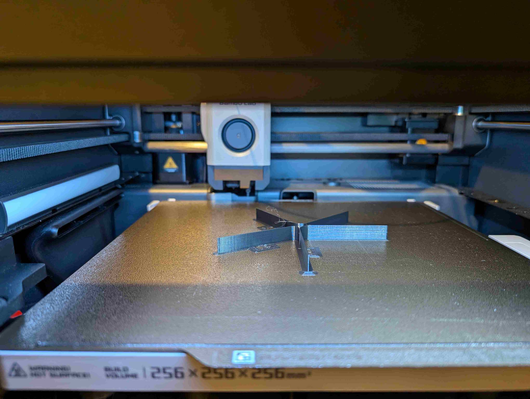

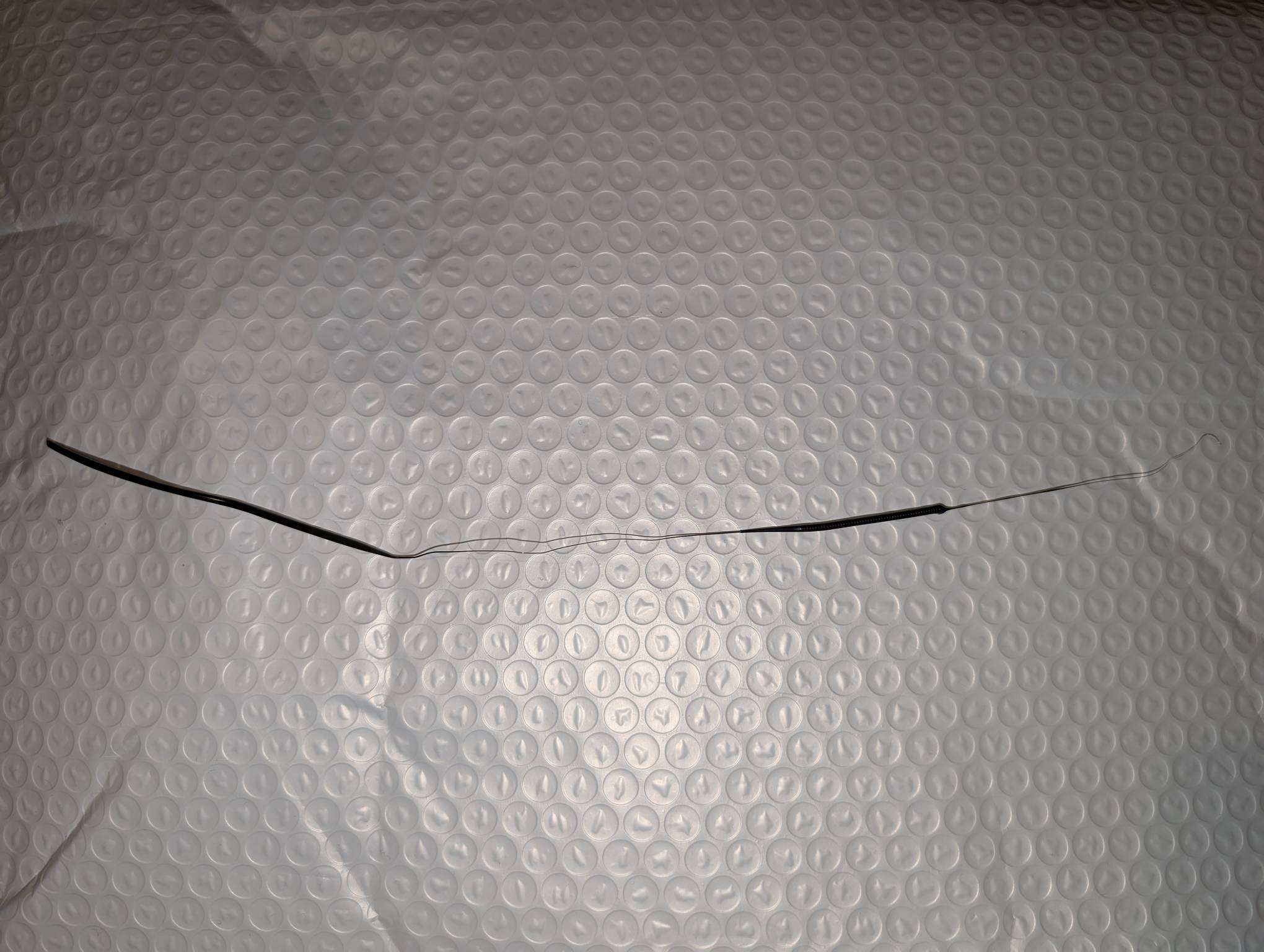

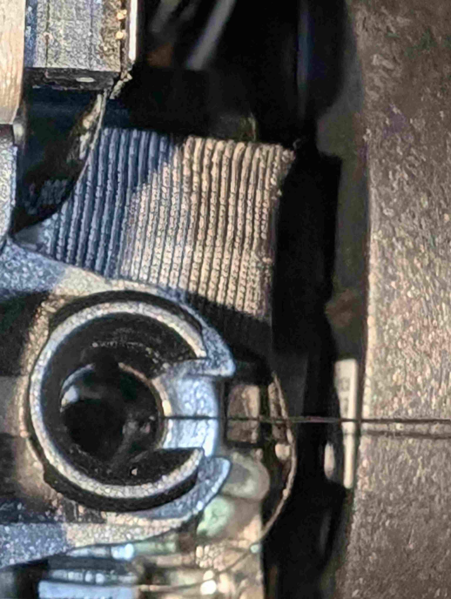

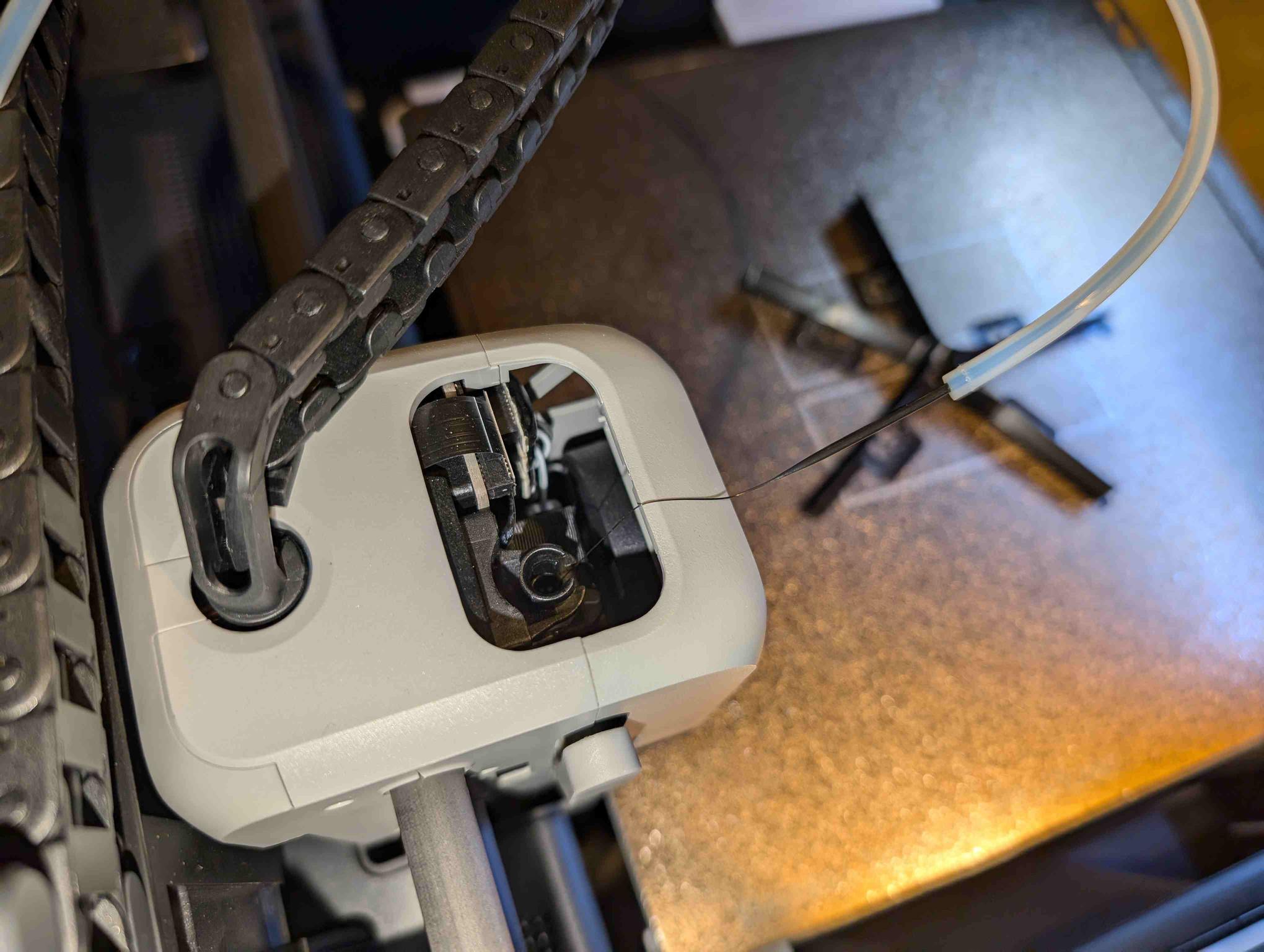

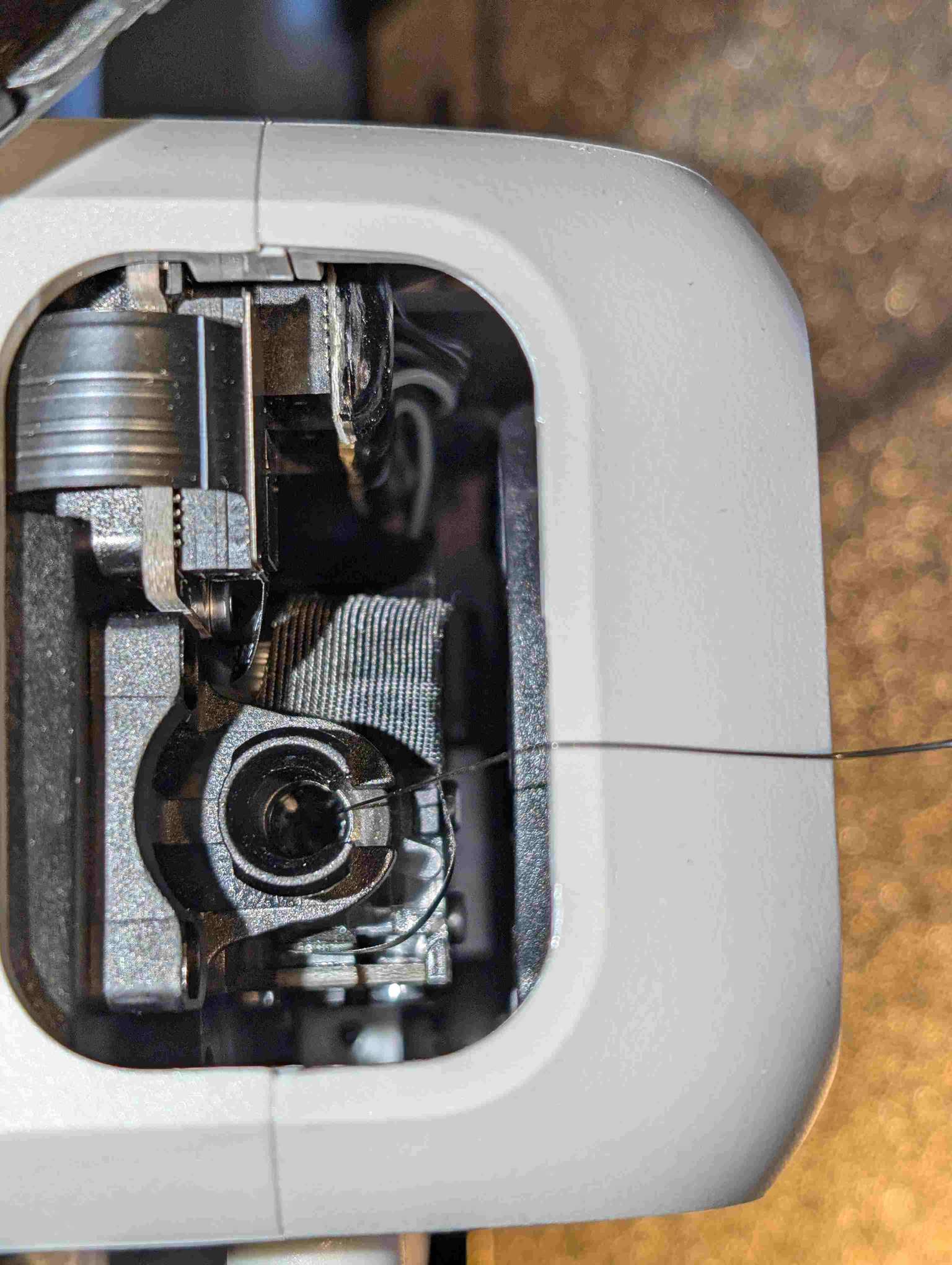

This is where the problem occurred though. The print started fine and after a few minutes I minded my own business. Some 10-15 minutes into the print I heard the printer stopped (it’s right behind me). I looked at it and the X-Touch display I am using said that the filament had run out (!). The spool is essentially still full so on closer inspection I realised that the filament somehow narrowed a lot just as it entered the hot end. I disconnected the PTFE tube and this was immediately confirmed - see the pictures I attached here. I tried to unload the filament, a few times, with no result at all. I tried pulling it out while the nozzle was at ~250C but it didn’t seem to move at all so I didn’t insist to avoid damaging something.

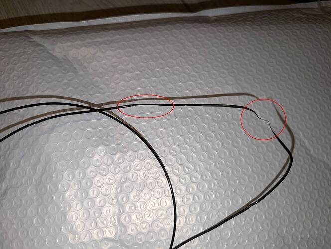

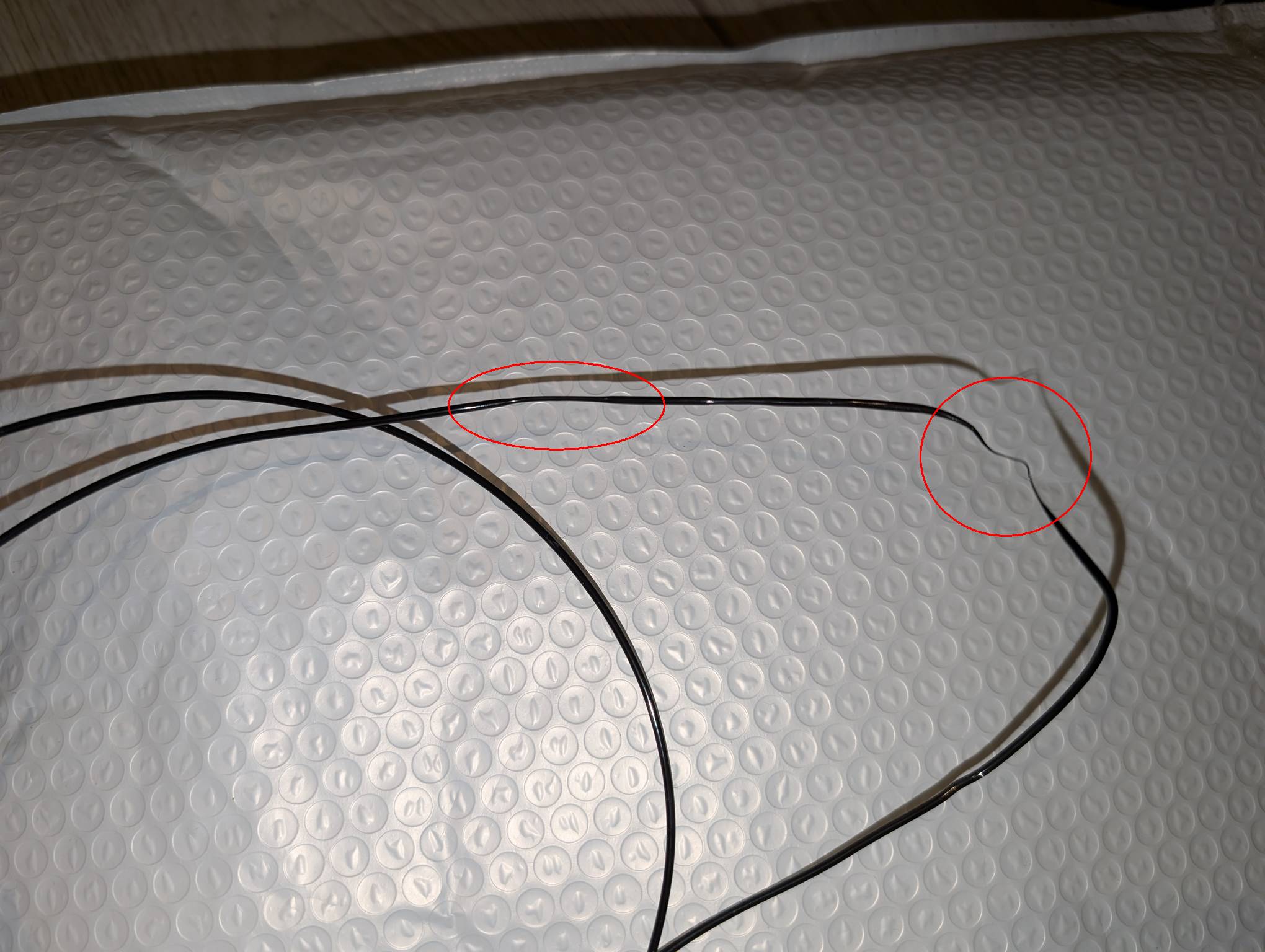

I found out what happened! Not knowing how to get the thinned filament out of the hot end I decided to cut it and respool the ~1m length. While trying to respool it I noticed that it had 2 other sections where it was way thinner than it should have been - see the new attached picture. So a filament quality issue…
Now, does anybody have any idea how I could remove the piece stuck in the hot end? It’s too thin for the extruder to move it and I also can’t just pull it out. I’m wondering if I could pull it out if I manually set the extruder to retract… Let’s see.

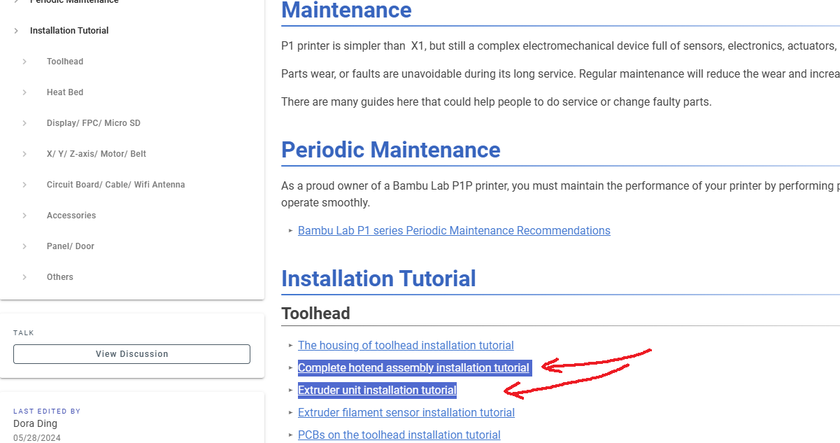

Visit this link
Follow 2 instructions to remove extruder and hotend to remove clog
You should be able to push it out by taking a length of normal thickness, identical filament, heat up the nozzle to print temp using the display, feeding the filament manually to the extruder and the use the display and a little force on the filament to make the extruder grab it and then purge the old filament out.
Otherwise, use the wiki’s hex key cold pull method.
Thanks both for the suggestions. It wasn’t a clog and I could also not insert new filament because of the thin section of filament that was already in there, taking a tiny bit of space.
But my idea worked - I heated the nozzle to 260C and I manually set the extruder to retract, while gently pulling back on the thinned section of filament. It actually came out quite smoothly. This is how the filament that was stuck in the hot end looked like:
