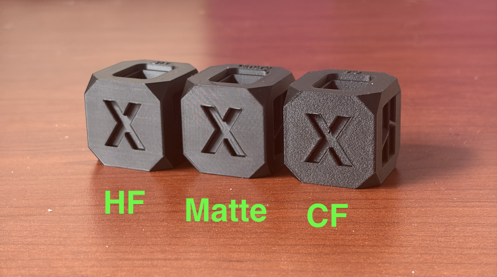

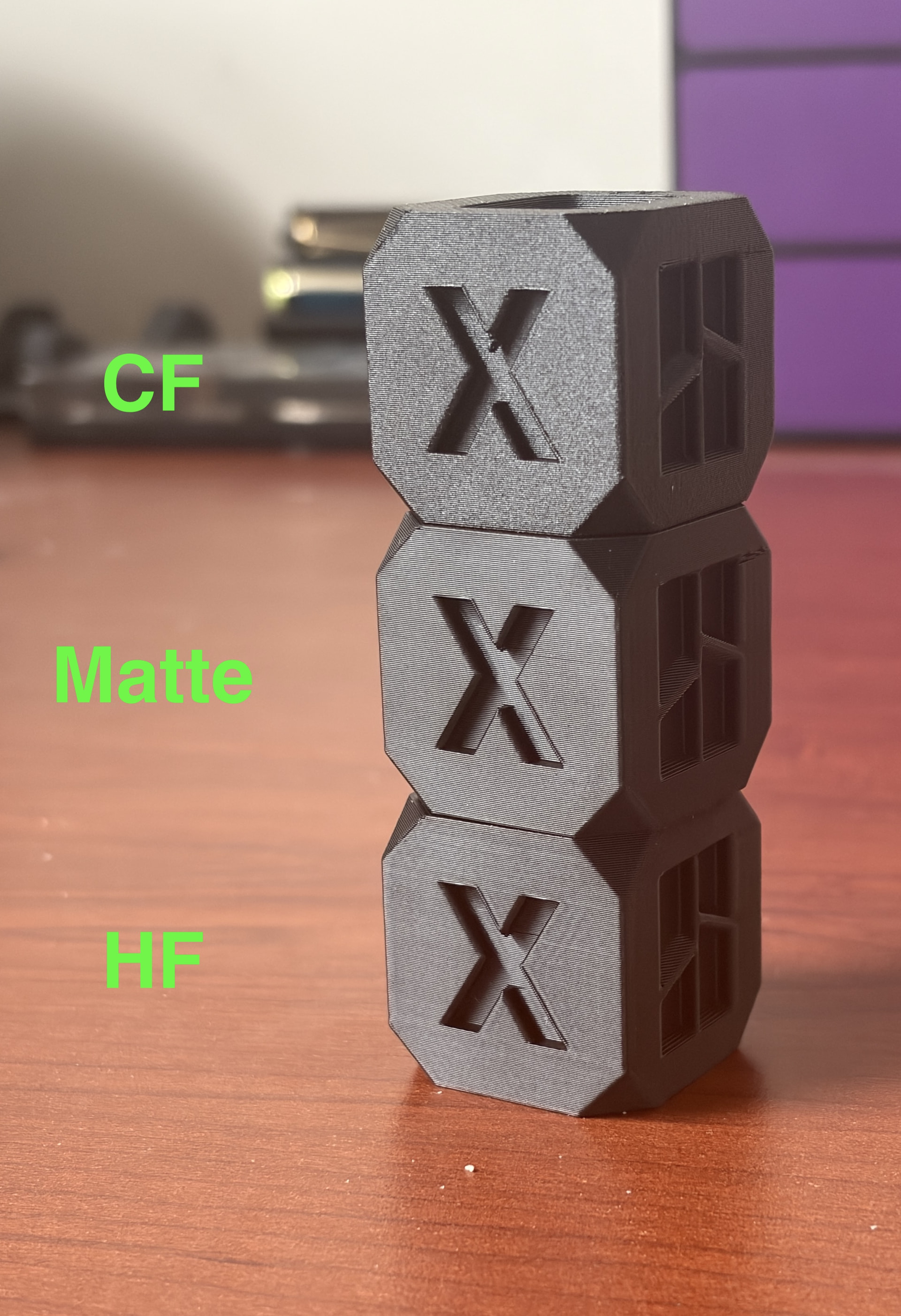

My matte PETG just arrived. I printed some black calibration cubes in HF and the new matte, standard 0.20mm settings … side by side I cannot tell a difference between them in natural or artificial light, they look identical to me from any angle. Unfortunately I dont have any PETG Basic to compare.
Here are some photos, together with PETG-CF since I had a cube laying around.

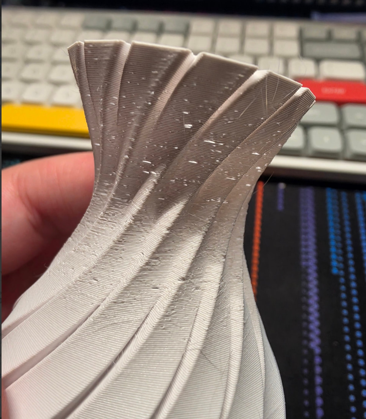

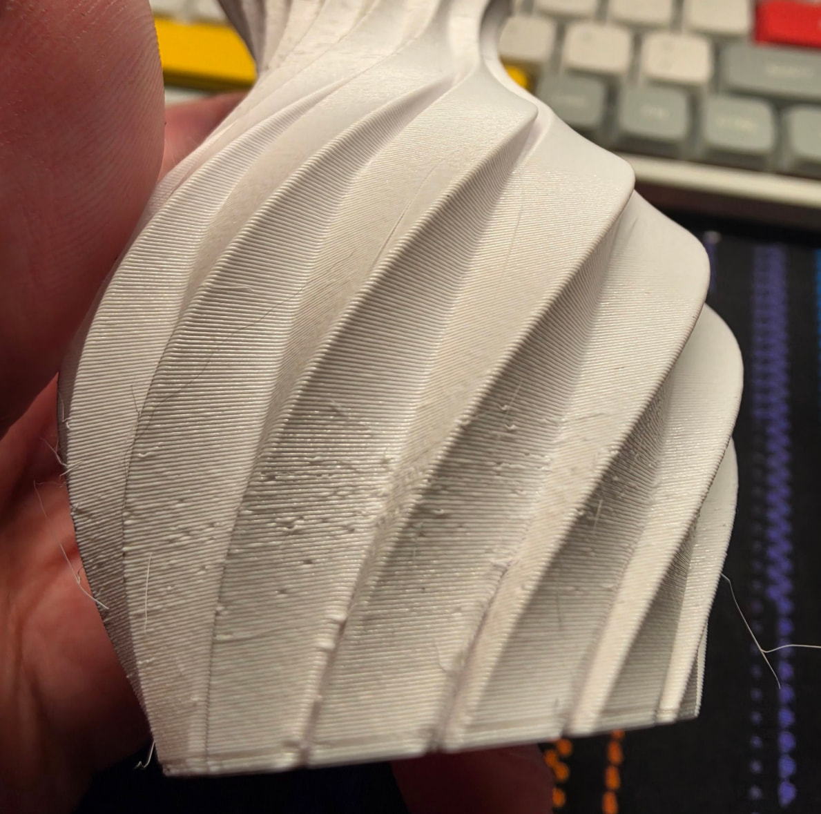

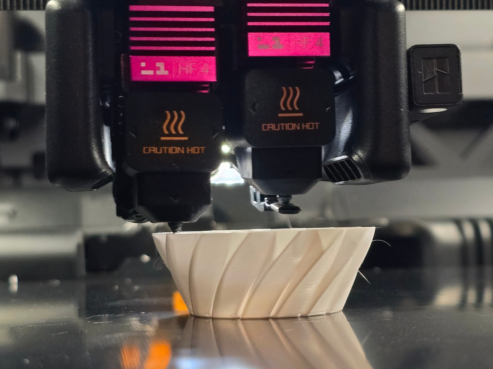

Yeah… out of the box, undried PETG Matte blobs, strings, and zits quite a bit. My nozzle is ObX 500
So far not really impressed by out of factory condition.
That is certainly a false claim.
Hard to tell if you don’t follow directions.
And why isn’t your first test with the Avocado color… :thinking:
Hopefully it’s better after drying. I got mine a couple of days ago but will likely not get to testing until this weekend. I’m hopeful your experience is really just a drying issue the white does look more like the color I’m wanting since they discontinued the HF white.
To be completely fair, I do expect filament to be somewhat dry from every vendor. Because if it’s THAT wet - it’s at a high risk of permanently being damaged from hydrolytic degradation. This process is irreversible and for manufacturers it’s kinda … an one way ticket of spoiled stock on the shelf.
Also, to be honest, don’t remember a day when I had that badly wet common material right out of the box. I mainly use Prusament, Polymaker, recently Inslogic (fancy sunlu) and they all are quite good out of the box.
TL;DR in a pinch, the filament should be printable, minor issues can be expected, but … I’m sorry - THIS out of the box is a complete shiiit.
However, ultimately, I should blame myself - should’ve read all of this.

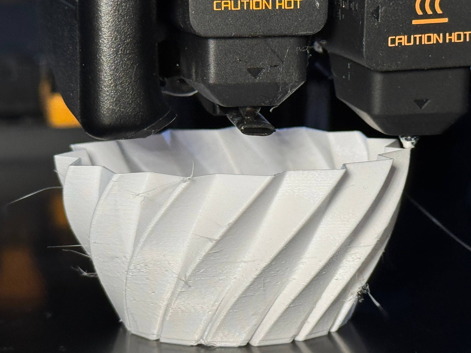

Because I wanted to compare to Inslogic PETG Pro White. Avocado color was in the dryer for the past few hours and I put it into the AMS … a few minutes ago. Let’s see if drying for a few hours resolves the issue or if it needs an overnight drying (which honestly, is likely will make a no go material for me). If I would have to throughly dry every PETG spool like it’s a Nylon … it just wouldn’t make any sense, especially with BL’s claims about moisture and PETG Matte.
By the way, as a side note. I hope that drying also resolves the layer adhesion on this small vase… because it is weak AF on a waterlogged one.
Preliminarily, I’d say that the filament was wet as a dog.

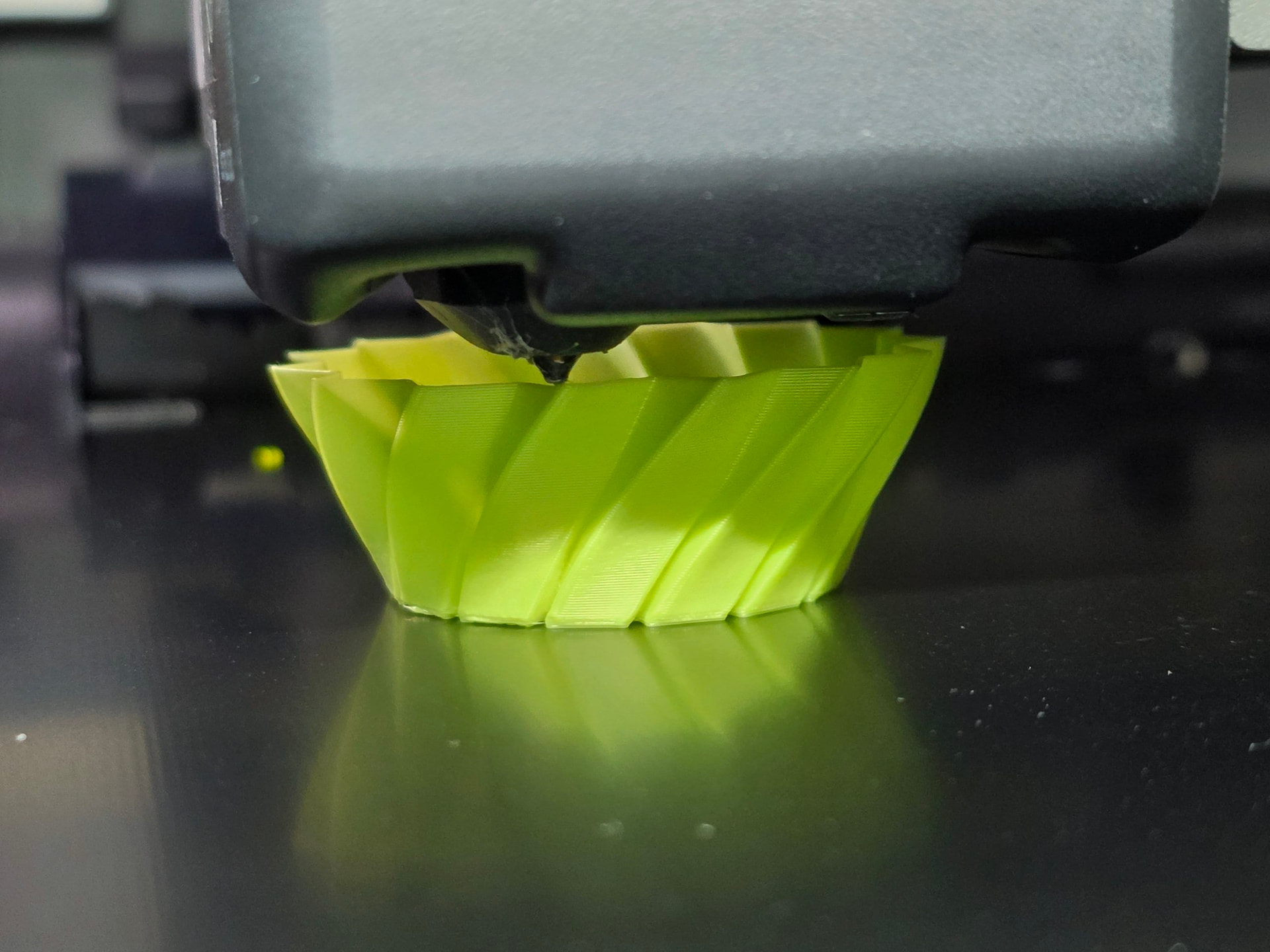

After a few hours of drying, it looks much better. Less blobbing on the nozzle too with Obxidian 500 on H2 and Tungsten on X2
Obligatory Avocado.
The color is freaking nice. A slightly underripe avocado.
Fair enough, and I appreciate you posting the results after drying it. That definitely looks much better.
