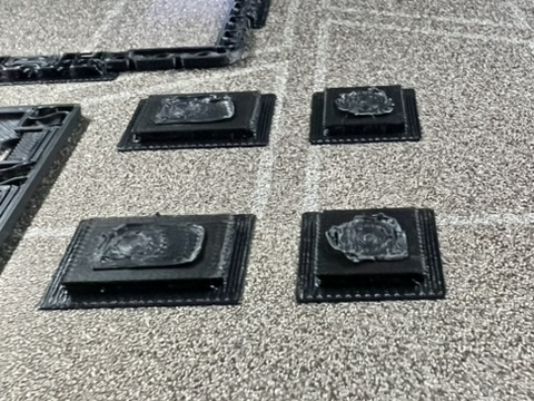

Bummer, PETG doesn’t want to stick to PLA support (normal (auto) fill) even with “0” Z distance.
“Sorry, you can’t embed media items in a post.” …
Are you using it for everything or just the interface layer? You’re generally recommended to use it just for the interface, otherwise it won’t stick
Just the interface layer, the colors are both black. I created a separate thread with as many details as possible to avoid over spamming this thread :slight_smile: Hopefully I don’t bother OP. Any advice greatly appreciated. H2D - PETG does not adhere to PLA support
I found a workaround solution for this problem - you need to add 1-2mm PETG cylinder anchors for each corner, this keeps the lines straight and solves the problem.
