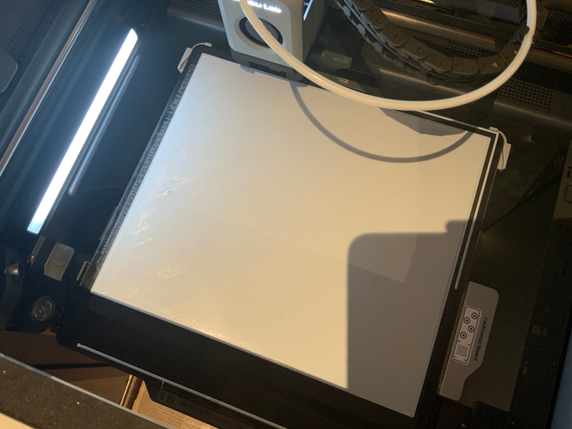

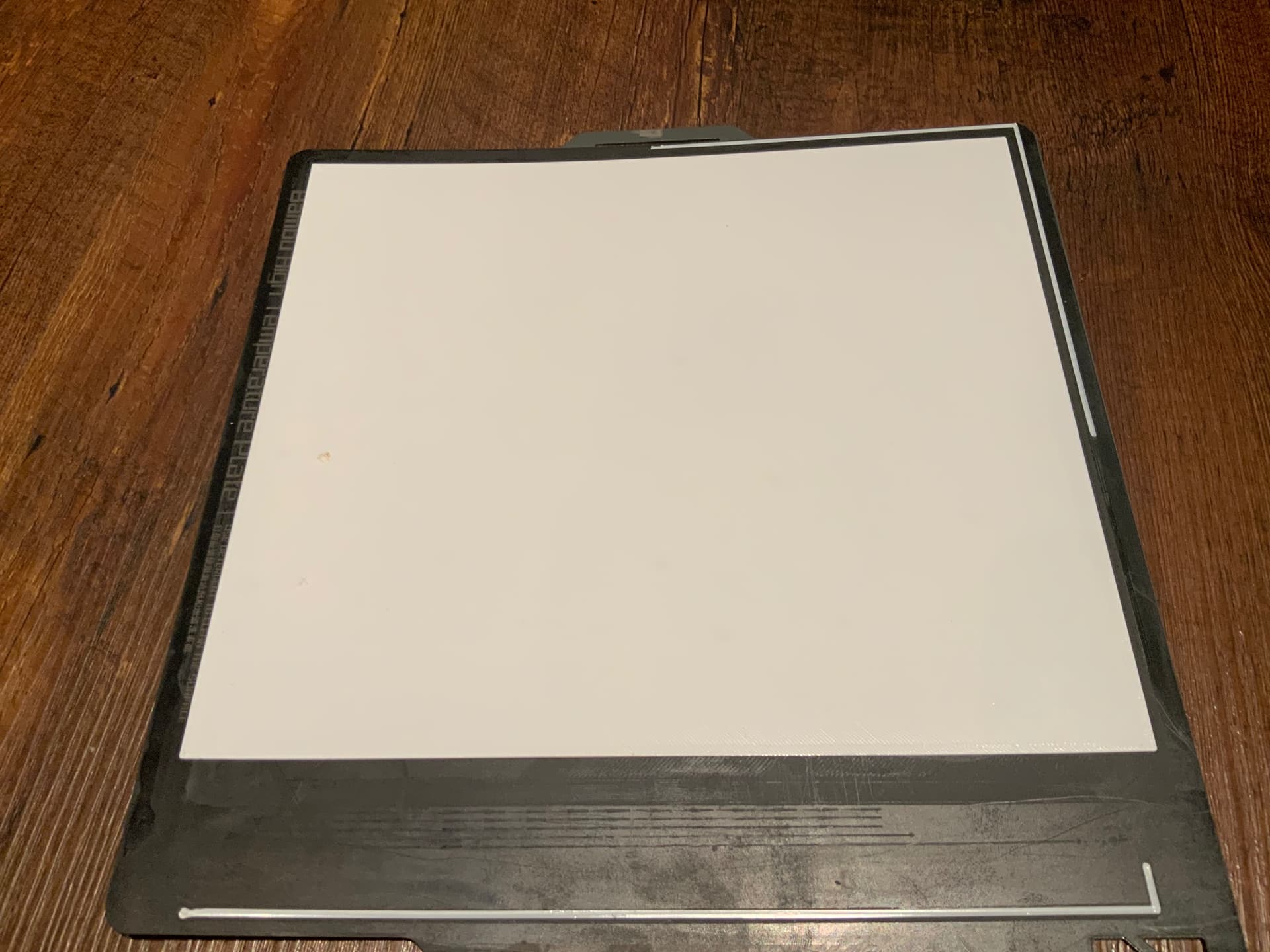

PETG (PolyLite) Adhesion Poblems / Wobbly Brim
Already did. Is consistent
90°C was tried but did not help. But I will try it again with 90°C with the new calibration.
Printing with PLA is not causing any problems.
Update will come as soon as I did further testing.

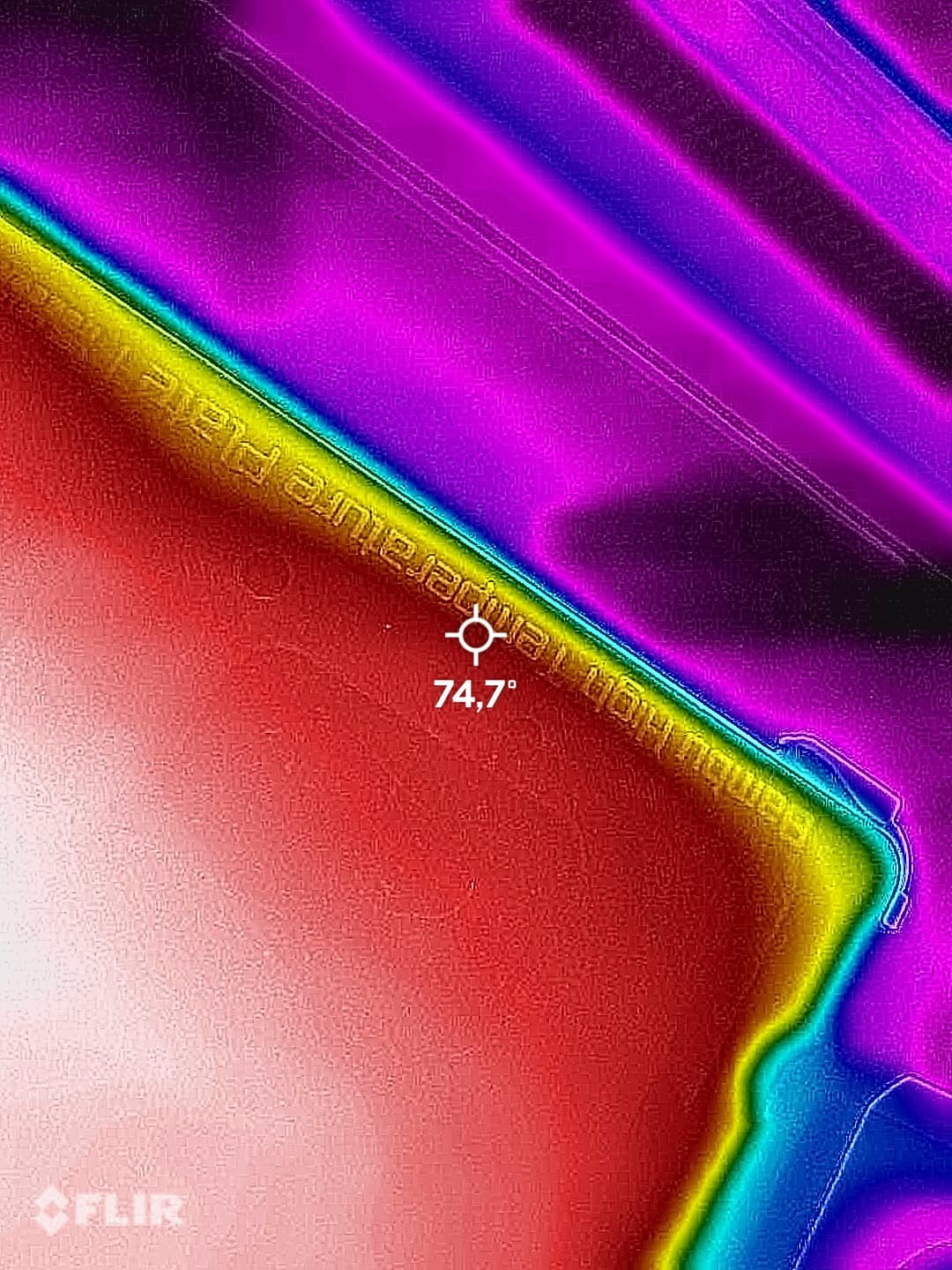

What kind of temp does thermal camera show on the surface when you set it to 90 C?
What is the ambient temp in the room where you print? And is it well ventilated?

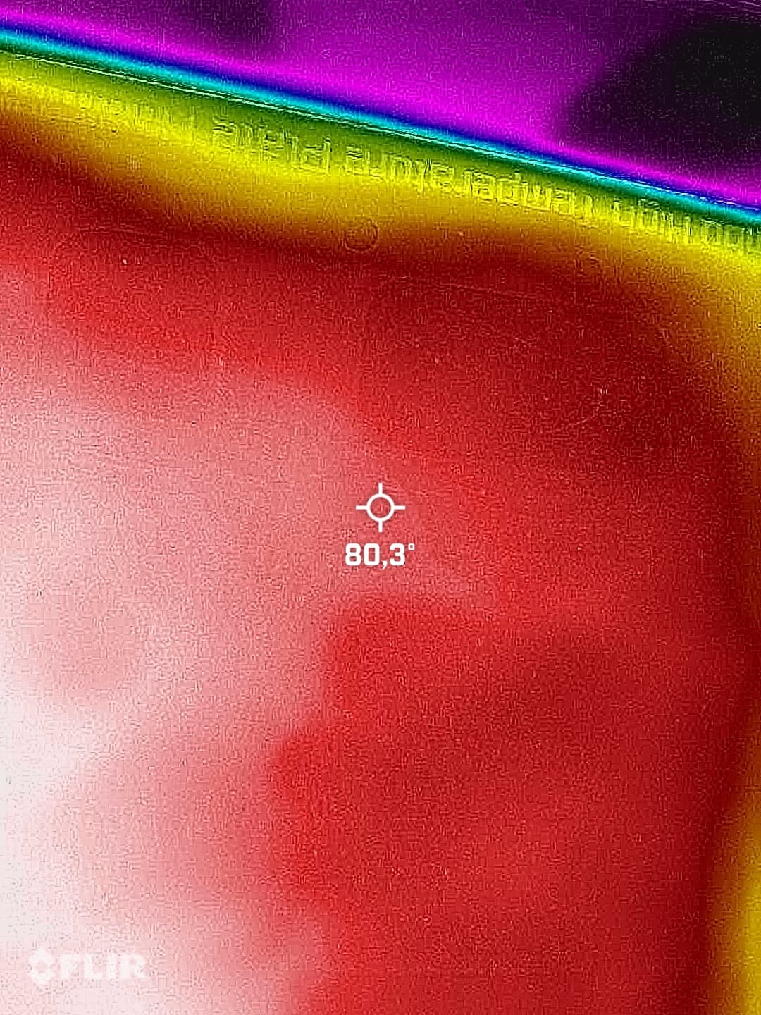

Yes if I set it to 90°C it is 90°C :joy:
To the edge the last 1cm is always about 5°C cooler but that seems more like normal for me.
For me, print would warp and lift up from the bed whenever there is too much cooling. So you should look into it from that point of view - how you can reduce cooling, reduce airflow in that area and how to keep temps high enough so that the print stick.
Just recently I had a case when even PLA warped and lifted up from the bed. It was because I started printing in a very cold room (morning) and there was just too much cold air and print model was big. I reduced AUX fan, split print into more parts and reoriented it and then it was fine.

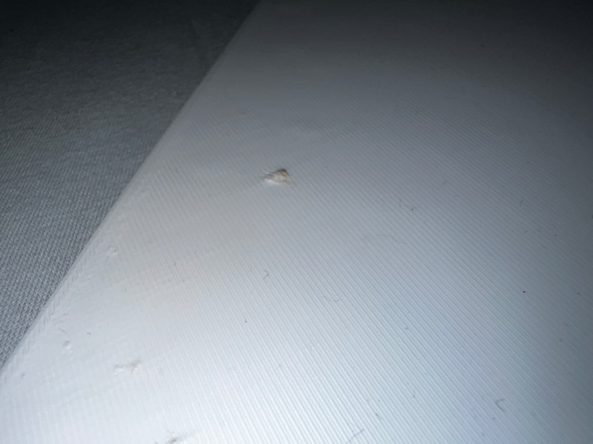

So hello again guys.
An update after some testing:
Did that now.
I did some more calibration with the flow rate and set the first layer speed to 20mm/s.
The result is way better now.
For anyone interested:
PolyLite PETG:
Flow Ration: 0,9502, Temp is 255°C and Bed 70°C
As you can see on the left border I still had one bump and also when looking at the side which sticked to the print bed I could see some signs that it had problems sticking again there. But in the end it worked well so definitely going in the right direction.
