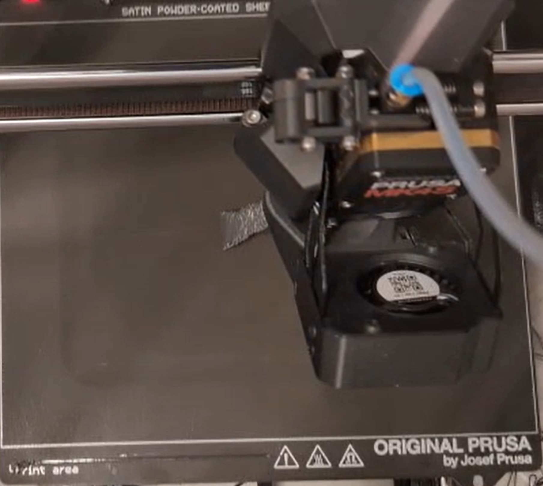

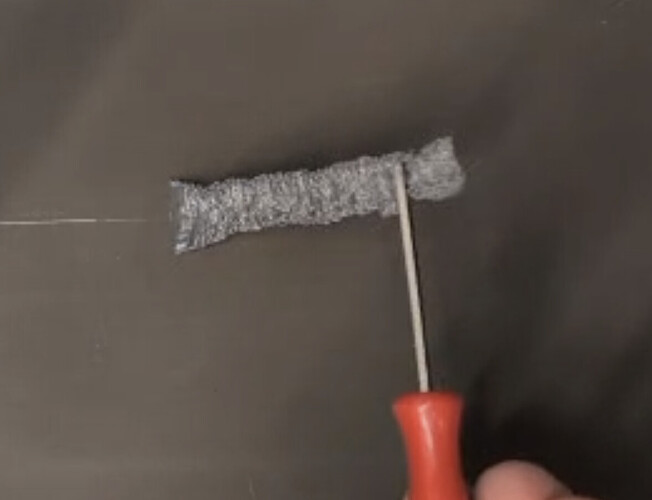

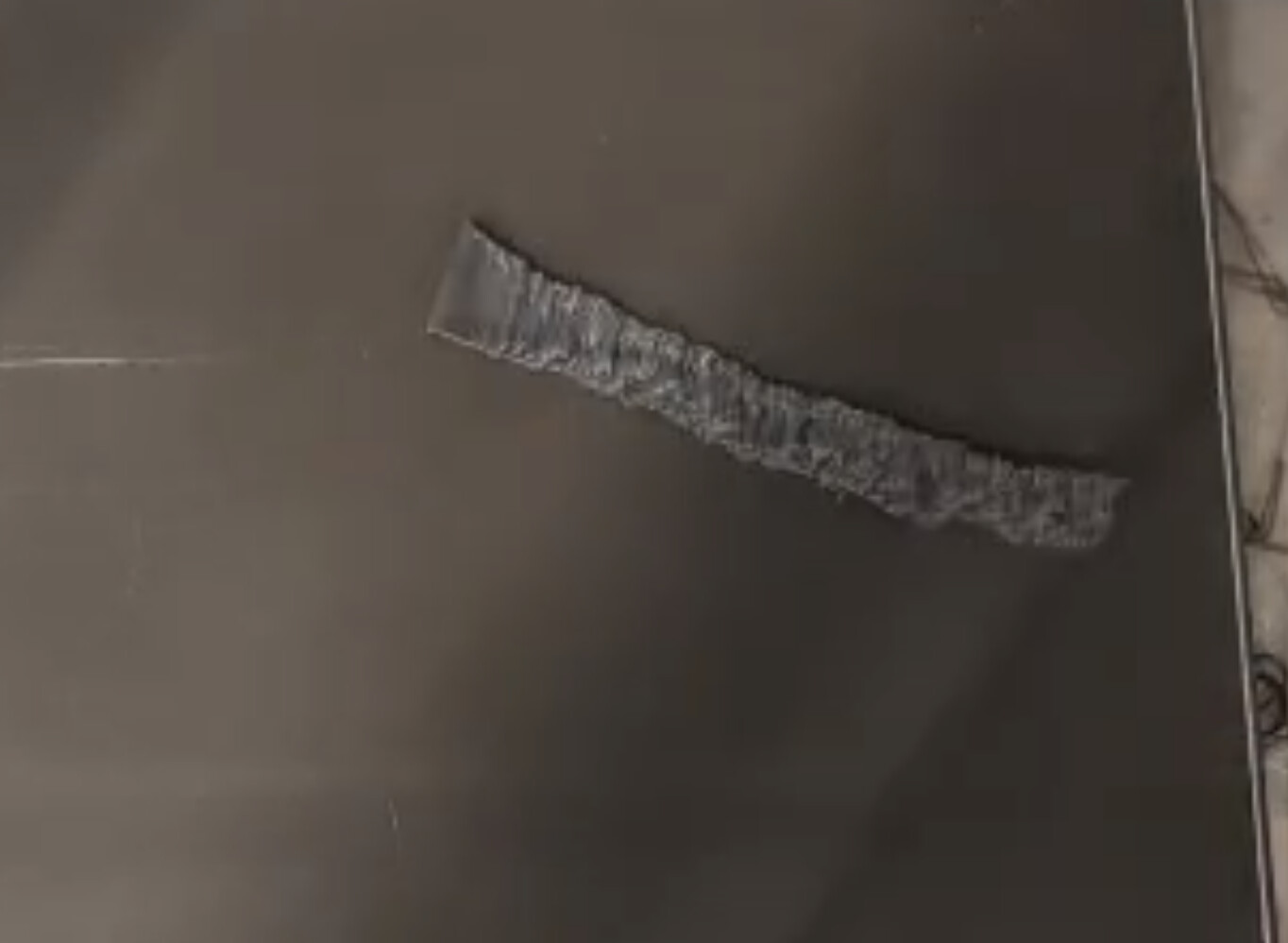

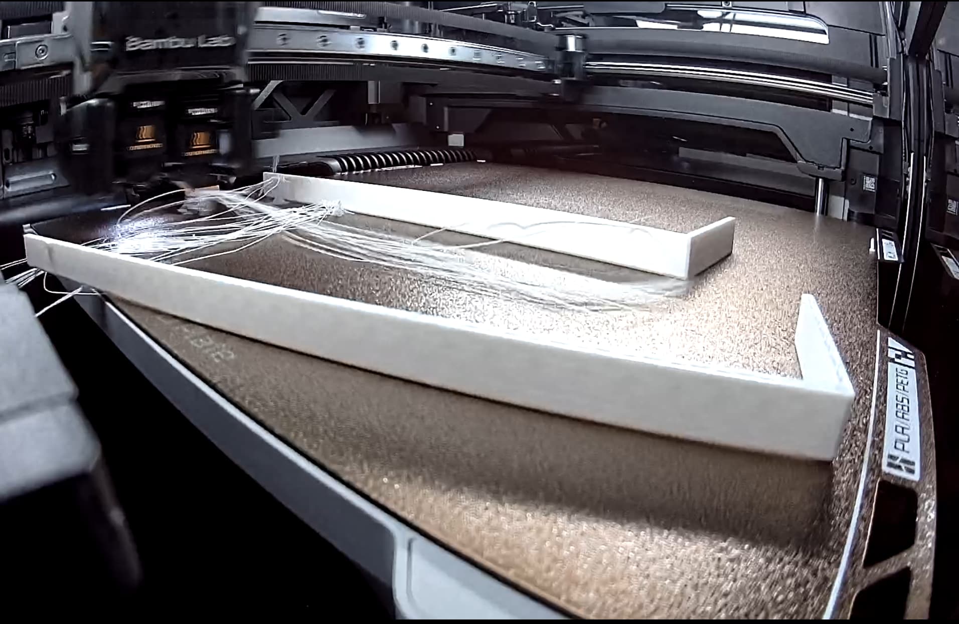

Btw, just to show why I like this “Satin powder-coated sheet” so much.

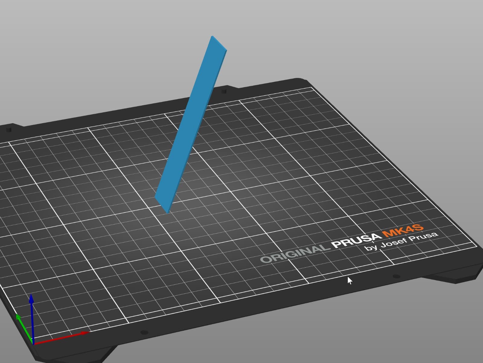

This object is sitting only on two walls on the build plate. 65 degrees angle, 100 mm long.
I printed it with PETG, satin sheet as it was (cleaned three to four weeks ago), no glue, no brim or anything else to promote adhesion.
I don’t know how to upload a time-lapse video here but I will show some screenshots of the movie.
During printing:

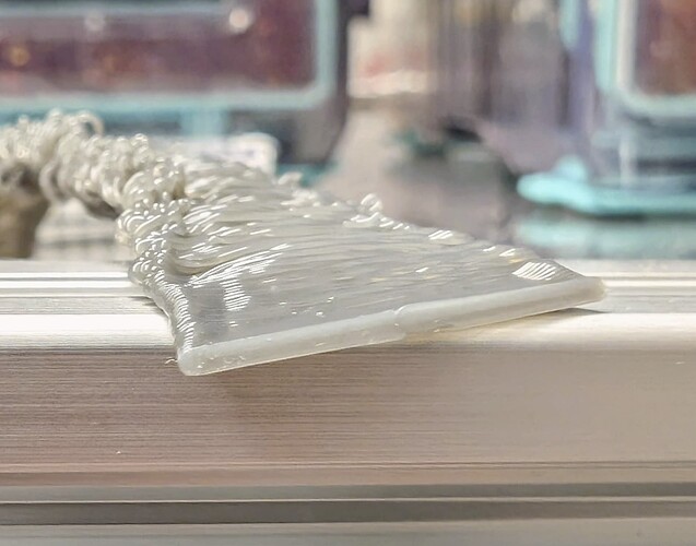

Printing finished, object looks terrible because I usually print PETG without any fans and I forgot to turn them on and 0.8 seconds layer time might be slightly too short without fan :scream::

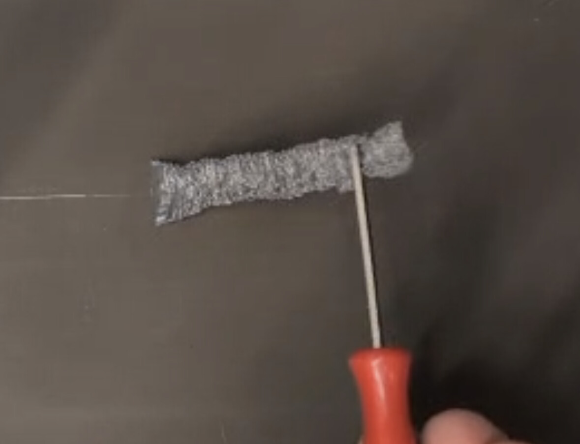

Bed started cooling down. Bending the print down with a hex key, still sticking at 50 °C bed temperature:
Printed object fell down at 25 °C bed temperature:

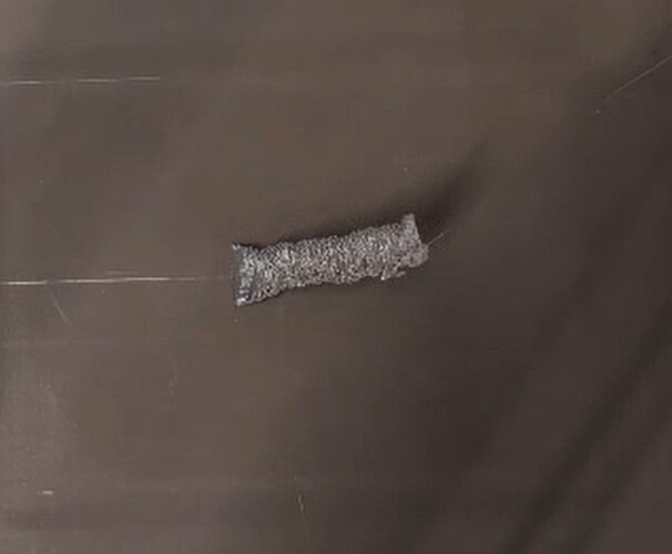

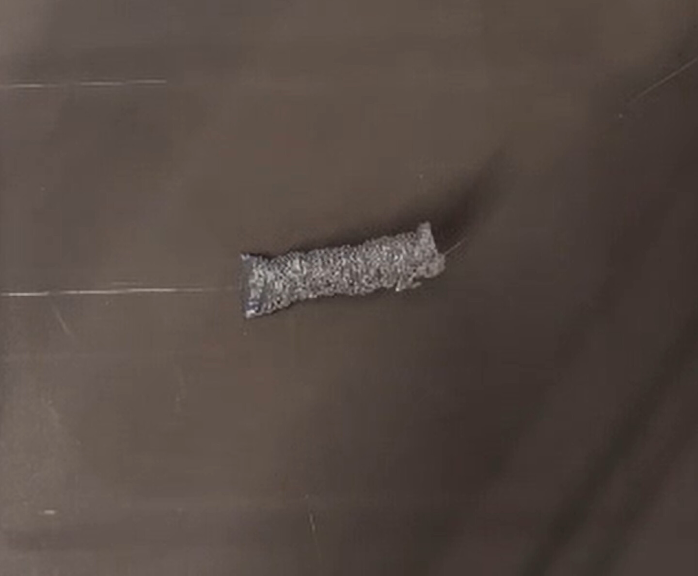

This is the area where it was sitting on the bed:
(yes, I know, the print has some slight, hardly visible defects)
So that’s why I was asking for this kind of sheets. Strong adhesion, no preparation, low maintenance and effortless (automatic) removal.
