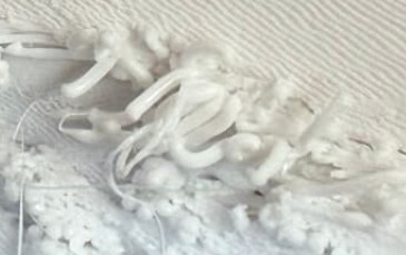

I’m getting defects when using PETG. They look like this:
Lots of boogers get left all over the print bed when this is happening.
I’m using Prusament on a Bambu X1C. This was a box with 0.1" thick vertical walls. No support, just a hollow box. Print bed adhesion was fine. I dried the filament for 5 hours at 50 degrees C prior to printing. I have also used different brands of filament (Matterhackers and Creality) and they had the same problem. At first I used the default PETG settings in Bambu Studio. Then ChatGPT recommended a bunch of stuff that was probably nonsense; at any rate, it didn’t fix it.
I don’t know what the name for this failure is, which makes it hard to research. It doesn’t seem to quite match the common PETG failures I saw when looking around, but I’m pretty new to this so who knows :slight_smile:
My first guess is you are having nozzle issues. It looks like your nozzle is clogging and then un clogging. I print a lot of PETG and dealt with my fair share of cold pulling. What temps are you running? and is that nozzle temperature fluctuating throughout the print?

Not enough to ensure it’s dry. 8+ hours at 65ºC. But I don’t think this is your problem, since I’d expect to see effects everywhere and not just in one specific area.
Also, it’s pretty amazing the rest of the print completed cleanly with that amount of disruption at lower layers.

IMO you are running that filament too fast, you can see the rippled area on the high speed areas along that entire wall. It’s at the absolute threshhold, and something tipped it over into pure failure in that spot. As the nozzle slows down to round the curve, the ripples fade away and it looks like neatly stacked lines. Too fast.
You either need to recalibrate your pressure advance AT THE SPEED you are running this filament, or you need to just simply slow down.
Nozzle temps are 255 °C for the first layer and 265 °C after. Max volumetric speed is set to 12 mm³/s. Initial layer speed is 50 mm/s; outer walls 200 mm/s; inner walls 350 mm/s; sparse infill 450 mm/s; internal solid infill 350 mm/s; vertical shell speed is 80%.

These noodles look quite a bit bigger than 0.4mm, so if that’s the nozzle size you’re using, I’m inclined to go back to “drying” since moisture can make oozed filament “swell”.
The rippling of the walls that otherwise printed cleanly are probably due to slightly exceeding the flow of the filament. Assuming it’s not something you’ve done intentionally. It’s kind of a cool effect…

I caught it in the act. First, there were some stringy bits that didn’t adhere properly. Then when it tried to print over them, a booger formed on the nozzle that got dragged around until it got big enough to fall off.
a simple test is set the speed to silent during the build. It is my impression that halfs all the speeds. Not the same as setting the speed pre slice but a simple test.
Yep, knocking the speed down fixed it. Thanks for your help!
