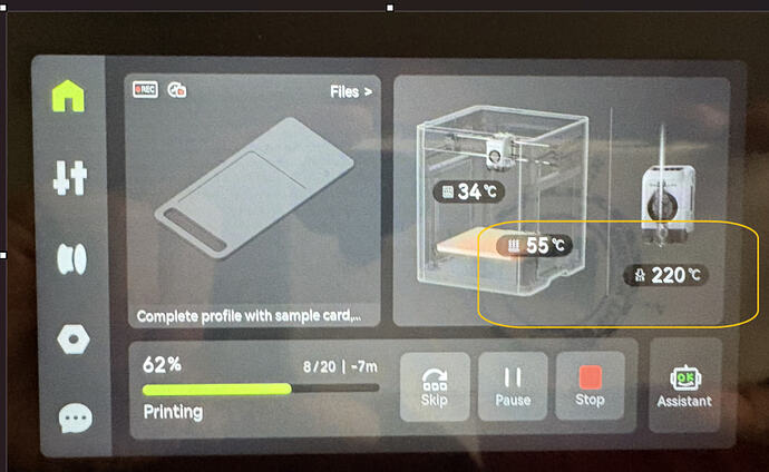

I am new to 3D Printing (1.5 weeks). This is my first attempt at printing with PETG. I created a profile, based on the filament (Micro Center, inland PETG Grey), and when I printed a test swatch; it began lifting almost immediately from the print bed.
I then decided to just use the “Bambu PETG Profile” and it printed. However the bottom layer was not (for lack of a better way to say it) smooth. I don’t know what you call it, but I could see individual traces of filament. The 2nd layer filled in the gaps. I was OK with that as it was just a swatch for the filament color/type. The swatch completed and it usable, but the bottom right corner lifted off of the print bed.
It’s my understanding that the print bed is not hot enough for adhesion of the filament.

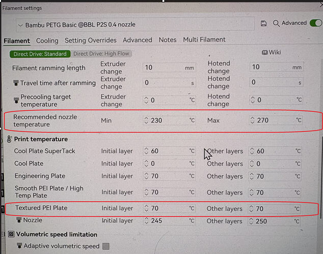

BAMBU STUDIO SETTINGS:
Nozzle Setting: 230 C (min) 270 C (max)
Textured PEI Plate Temp: Initial Layer 70 C Other Layers 70 C
BAMBU P2S ACTUAL:
Nozzle Temp: 220 C
Textured PEI Plate Temp: 55 C
Any advice/assistance would be greatly appreciated.

I am more curious in why the Nozzle & Print Bed Temp’s don’t match between what was set to what was actually used by the printer.
The 70c build plate and 240-250 nozzle should work good. So I would look else where, as mentioned it could be under extrusion run the calibration and dial in you flow ratio,
So I re read your post, definitely a concern, looks like you may not have your filament profile selected properly?

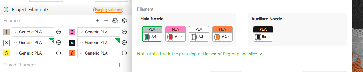

Are you certain you applied the PETG filament to the part in Studio rather than a PLA?
Or that the PETG roll is correctly declared in the AMS through the printers screen?
Both are common root causes when finding that the printer is trying to lay down PETG with PLA settings…
Easy error to overlook when multiple materials are loaded. Especially for similar colors. Happened to a lot of us (amhik) :wink:

The machine’s UI looks like it is still set to PLA. (220/55)
Double check / Send a screenshot of this page from your project as you go to print it, make sure PETG is showing up. You might need to right click on your project model and assign filament → filamentname, in case you have many colors that all look the same in preview.
I have learned, the hard way, to never say always, but I am pretty certain that it was set to PLA. That was my problem on the first attempt, I set PETG, but did something and it reverted to PLA.
BINGO!!! It was PLA Basic. Newb’ mistake. Bambu Studio was correct, the the printer said, “Not so fast.”
Easy error to overlook when multiple materials are loaded. Especially for similar colors. Happened to a lot of us.
