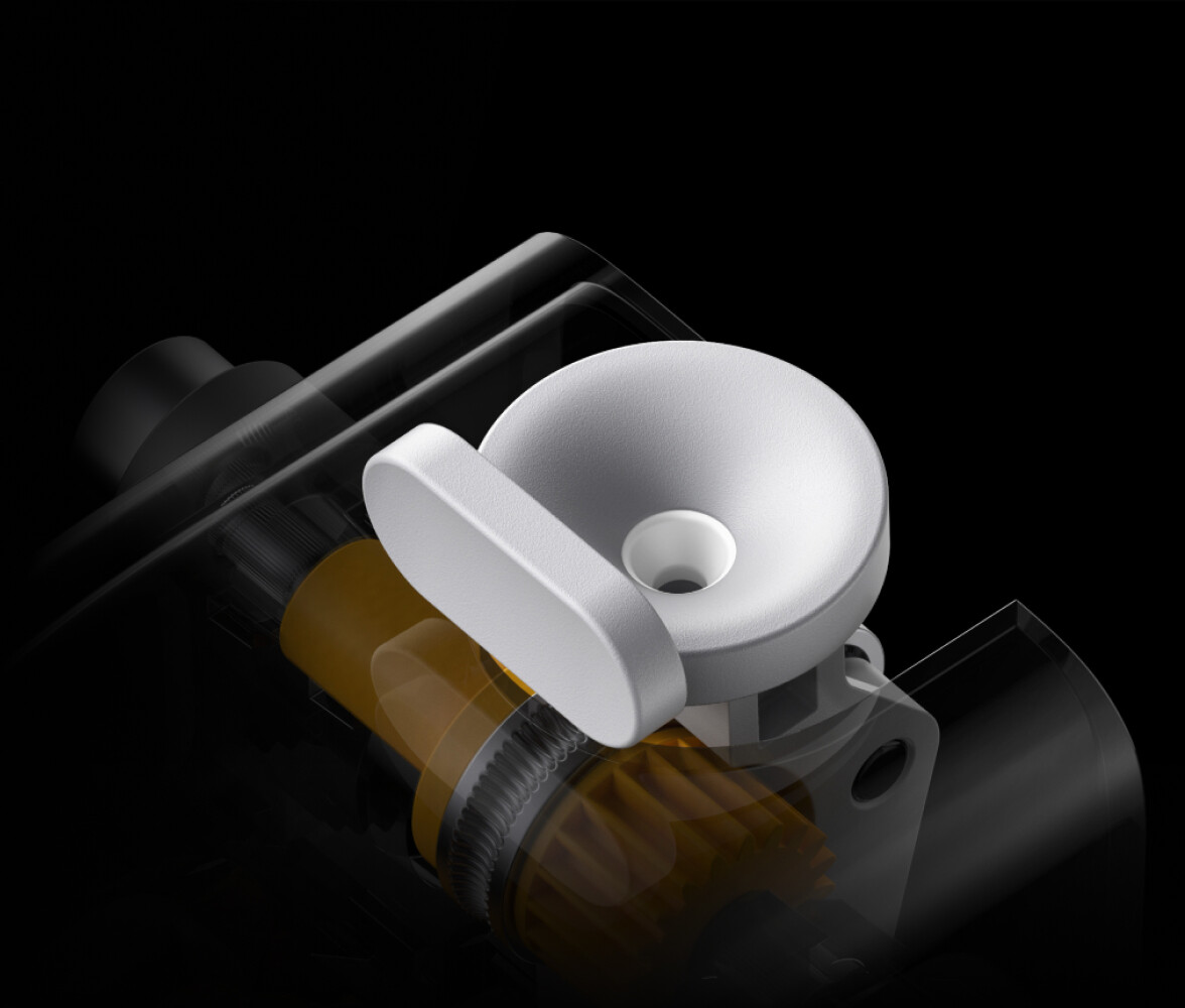

would be interesting to know whether the AMS2 Pro also has the same problems with the PLA glow, it now has the ceramic inlets/funnels, but maybe other parts are the same as in the AMS and they would also be damaged after some time
I’ve been running glow through the regular ams with a funnel protector mod and it seems to be going fine, I’d guess AMS 2 will be fine also
If Bambu Labs are introducing new abrasive filaments like the glow type that cut into the plastic feeder funnel, maybe it’s time for Bambu Labs to introduce a stainless steel top part of the feeder funnel for the filaments to run smooth and handle the wear and tear of abrasive filaments better?
The AMS2 actually has ceramic inlet funnels.

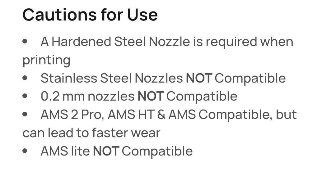

I have two AMS 2 pros so interesting that Bambu Labs would still be warning about using the glow filament is this wasn’t an issue anymore.
The warning is probably still there because the original AMS is still available for purchase as well as the countless number of users still using them. Also Glow filament is still abrasive and will wear other things such as PTFE tubes at a higher rate in both systems.
Not sure when this was updated, but this covers things nicely. OP may wanna try hitting BL up for some free parts since they’ve effectively admitted their old guidance was wrong based on this edit.

Looks like Panda makes a ceramic protector as well
Amazon - Panda AMS pro protector
