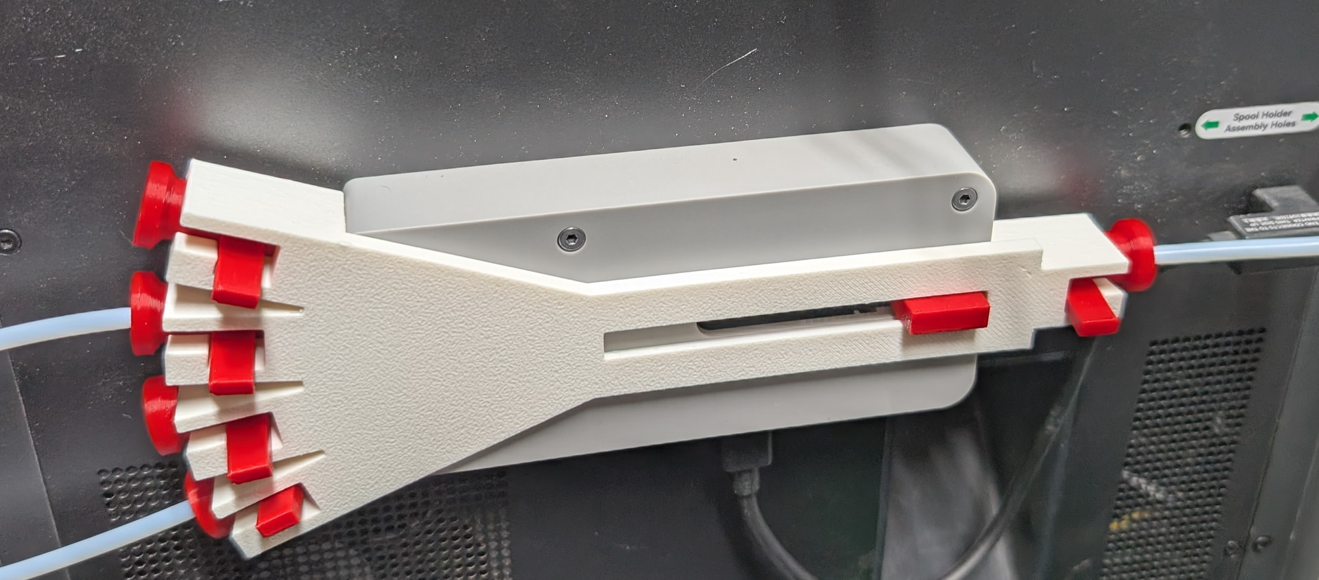

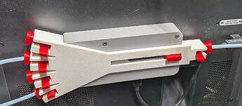

I used this one for a while with the original buffer. This design actually does work quite well.
https://makerworld.com/en/models/97066-ams-buffer-injector-guides#profileId-103587

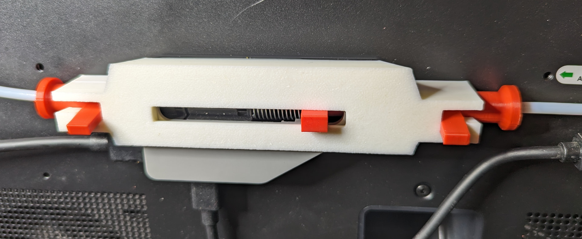

But then I designed this one and used it for a few years. The slide and the exit bolt keep the filament aligned during operation.
https://makerworld.com/en/models/149681-ams-buffer-tube-guide-release-babufferguide#profileId-163351

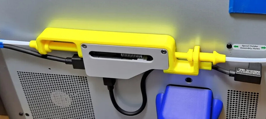

I made this one when I switched to using 2 AMS at the same time a few months ago. It’s essentially the same design with four inputs instead of one.
https://makerworld.com/en/models/3009283-ams-hub-tube-guide-release-bahubguide#profileId-3379497
I’ve been thinking about getting a P2S buffer just to make a version for those folks. They seem to be having similar issues to what I remember from 3 years ago.

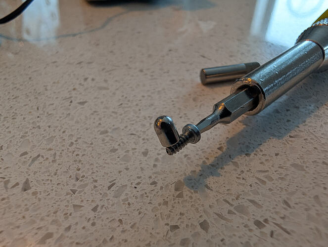

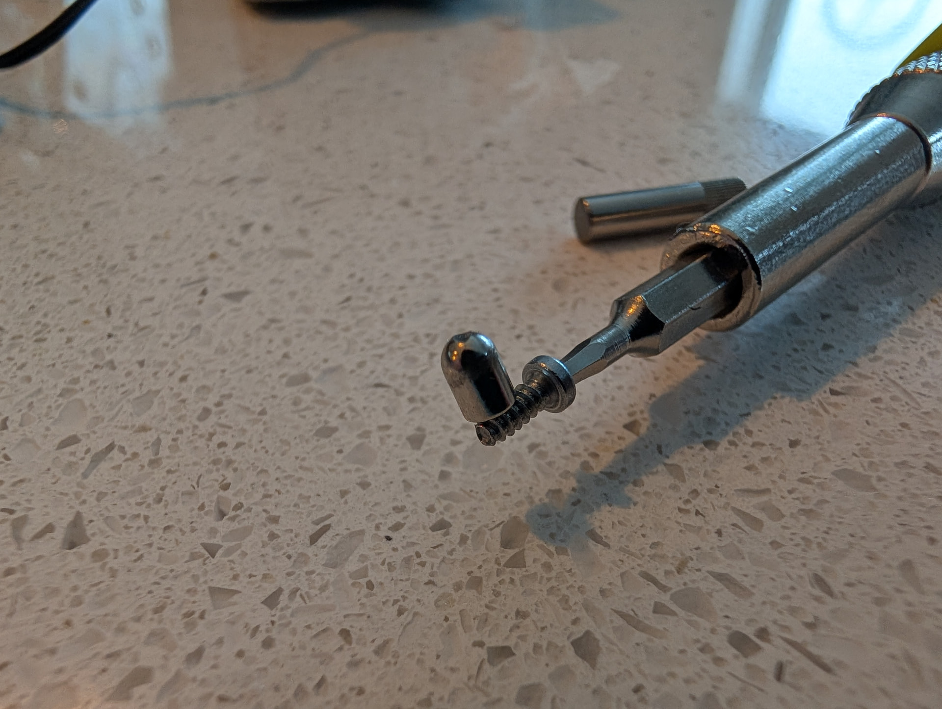

I can’t say this with 100% certainty, but after I printed around 20-30 dragons eyes and belly in glow in the dark filament I started to have trouble with the AMS primary feeders from where the glow in the dark filament was. So I’m assuming it was the cause. Personally I won’t run glow in the dark through my AMS anymore.
First signs I had was that the feeder would pull back the filament too far and I had to push it back through for the next filament change. It started out periodic, but then became every time.
I decided to take it apart and see what happened. There is a small switch that this little magnetic part on the end of my screw driver is part of and it had a groove warn into it (you might have to open the pic and zoom in but it’s evident!). I’m guessing this is what the warning means by increased wear :rofl: This is the part that tells the feeder to stop. Once I replaced that part I was back in business!
The question I still haven’t found an answer to is are there other parts that could see this kind of wear with glow in the dark filament? I’m been hesitant to use it since I learned this. The part in the AMS Feeder was only a few dollars and about 10 minutes to fix… but what other parts should I be concerned about (aside from the nozzle of course)?

No worries. I think everyone with an AMS should have some version of this.
The hubs/buffers on every one of the AMS(2) printers cycles every centimeter of filament flow on every print. The smoother this movement, the lower the tension peak from feeder to extruder. In the extreme, before I installed that first device, the filament sometimes pulled so tight it broke inside the AMS. It occasionally also dragged hard enough to stall the extruder. I do wonder how much wear is exacerbated by events short of that.
