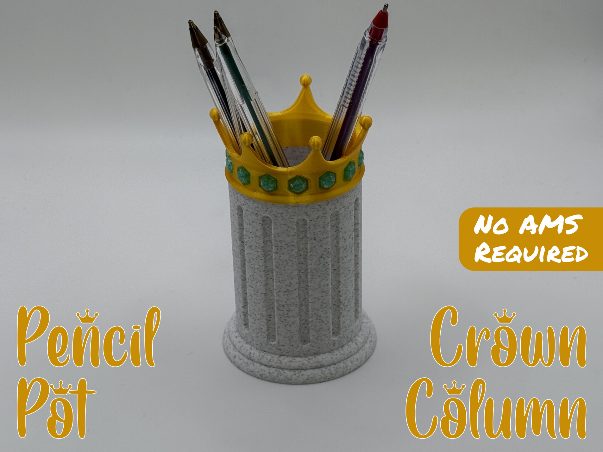

My Crown Column model uses both PLA Marble White and PLA Silk+ Gold, they are fine together.
