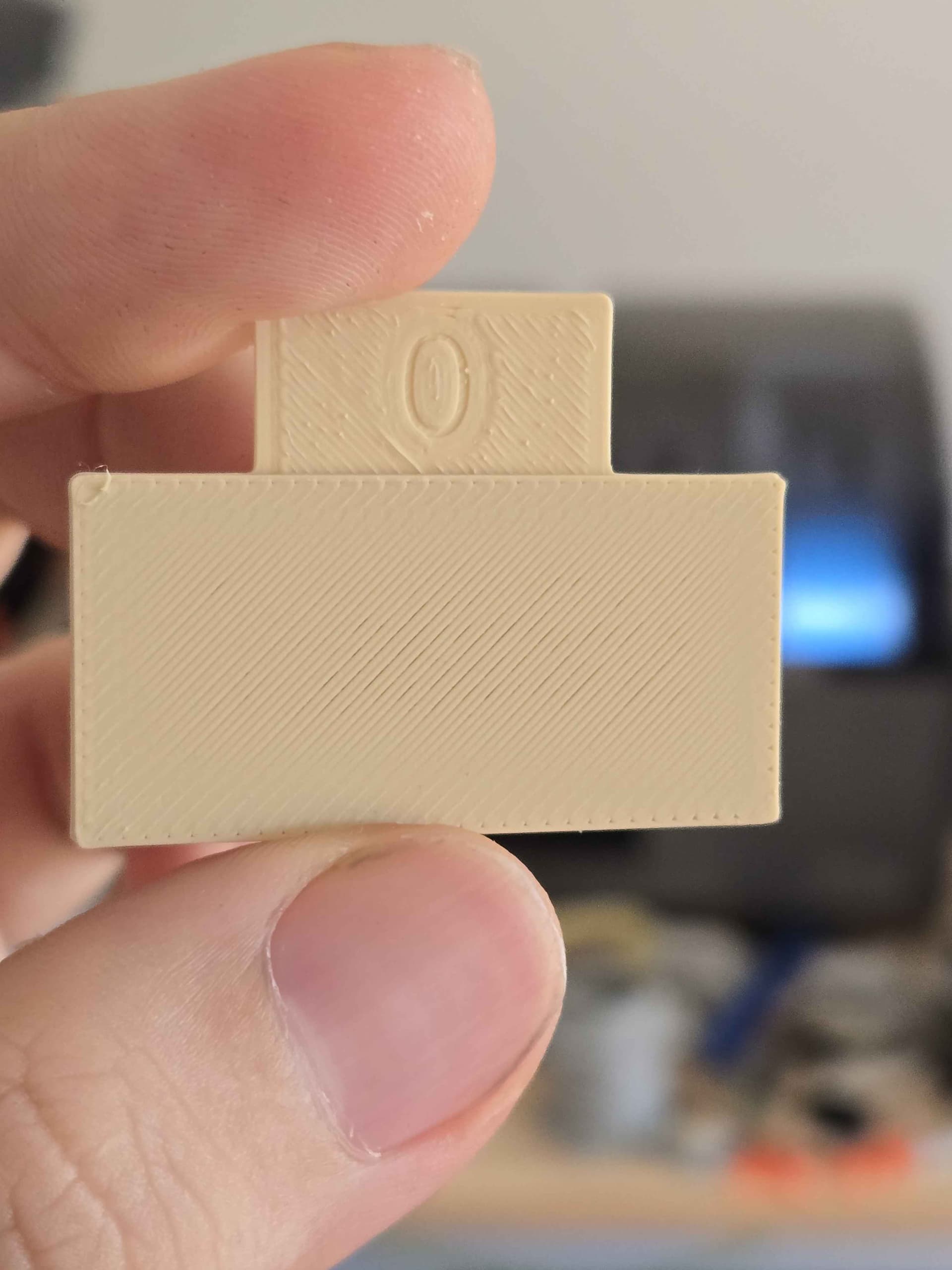

I trusted Bambu too much for their profiles and filaments, then I got this with PLA Matte, Desert Tan, which is freshly dried at 55C for 8Hrs :
The walls are perfect, the bottom layers are perfect, it’s just the top layer that is underextruding by a visible amount.

  • I tried to print with PLA Basic then.
The problem disappeared. So it’s the filament all along.
It’s super weird, but I guess the moral of the story is, don’t put your trust on Bambu’s filaments and profiles too much, do your own flow rate calibration… I guess.
Also this is a quite common issue for PLA Matte it looks, I asked around and some others are having similar issues with PLA Matte. Is the default flow rate too low?
(my manually calibrated flow rate is 1.01)

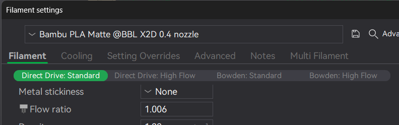

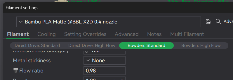

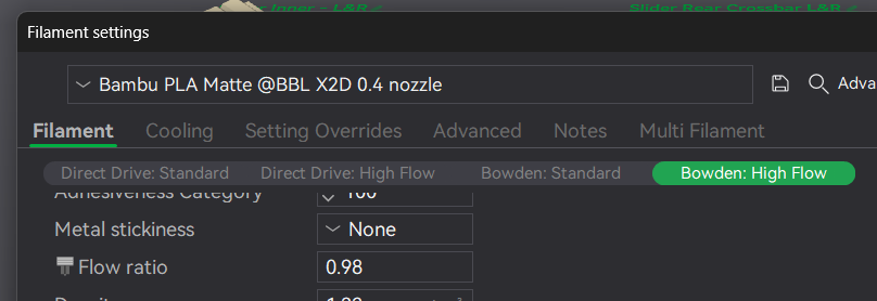

It looks like they noticed too, default FR for Matte on X2D is now 1.006.
but ONLY for the standard nozzle with standard extruder. The other 3 - remains at 0.98. @SupportAssistant I wonder if this is an error?
