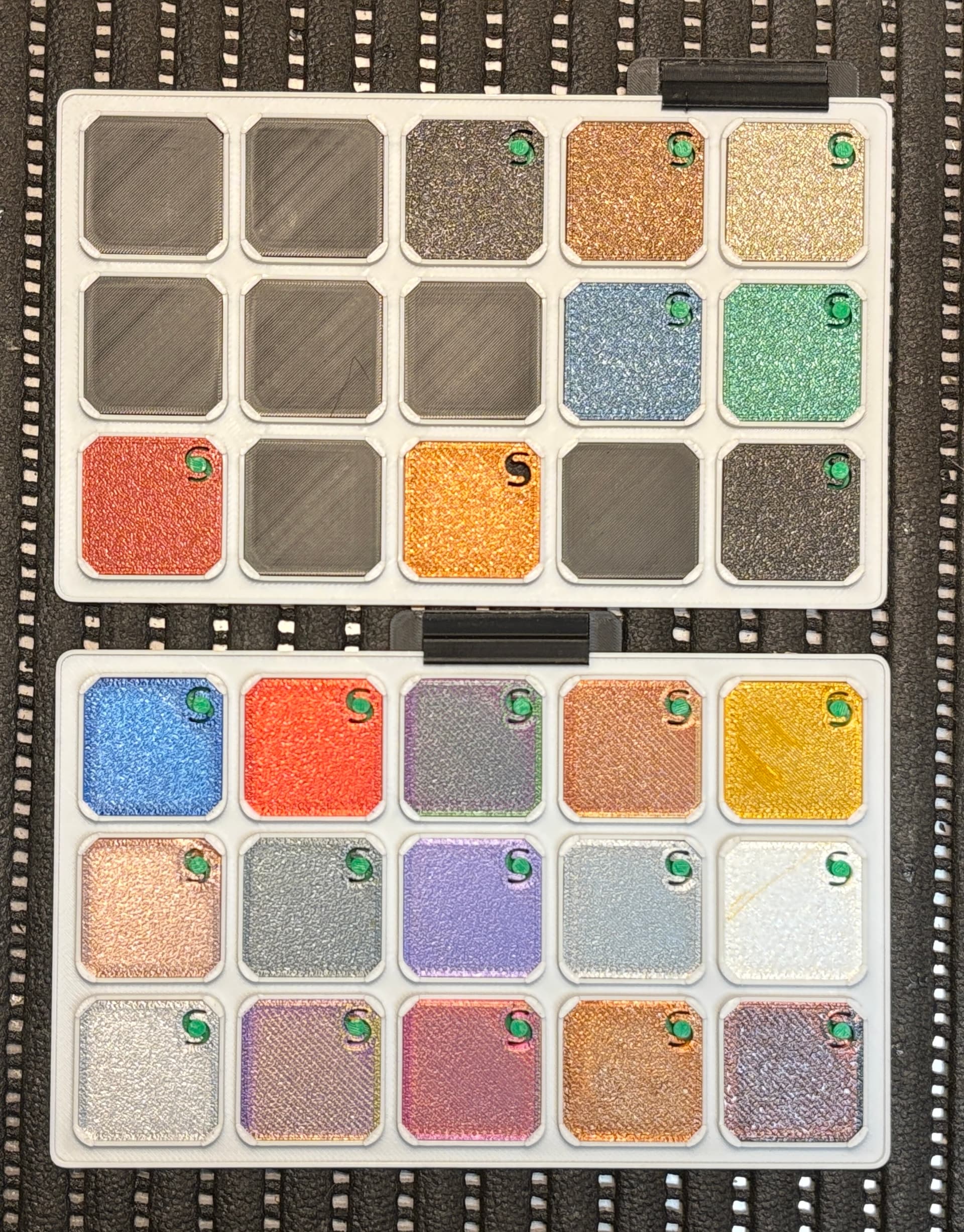

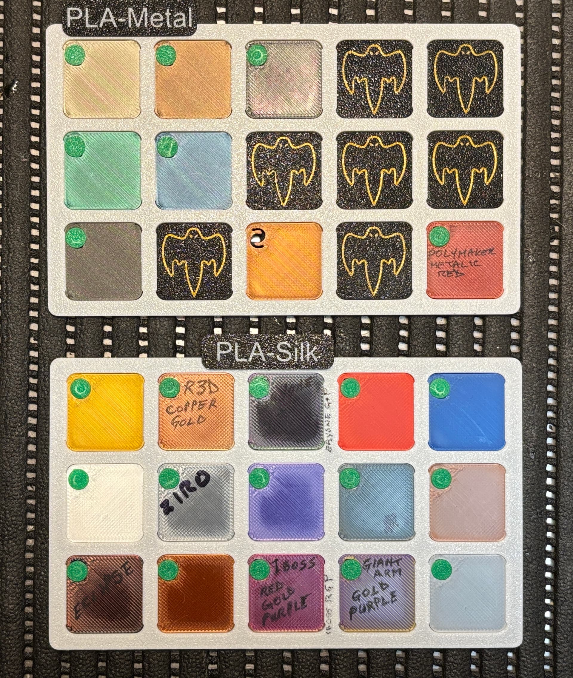

edit: PLA-Metal Iron Gray Metallic is top row center.

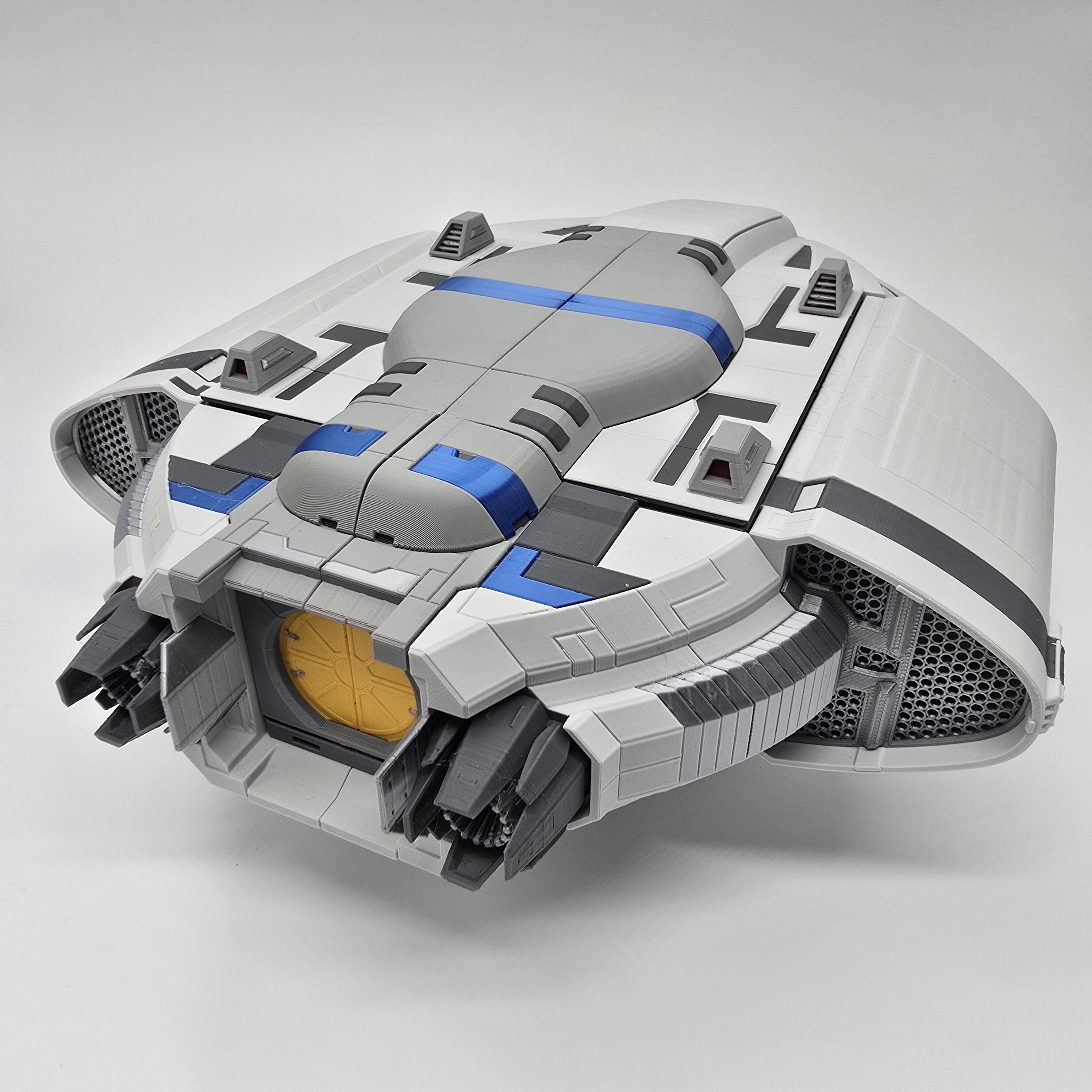

Second Dynasty (who make 1/56 scale space craft models) have some good photos of matte/silk models with no paint - the models are about 50-90 centimeteres long (like 2 to 3 feet). The “Skolpadda” is their new one, and the first one that supports multi-color print. I saw some photos of prints in their MyMiniFactory landing page blogs.

I don’t kow any resource that has the EXACT combininations you wanted to see, but I think those give an idea of what a “no paint” model would look like.
