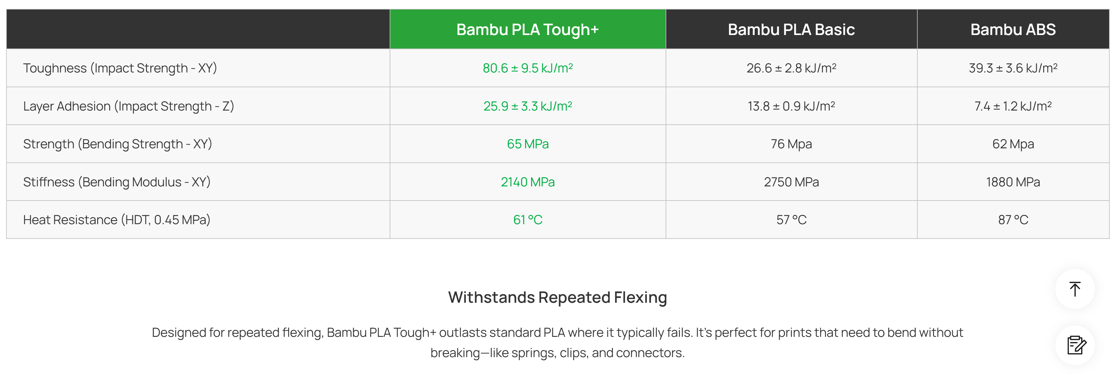

The manufacturer’s claim is that PLA Tough+ withstands repeated flexing and is recommended for springs, compliant mechanisms, box latches, and other such parts
Is anyone aware of publically available test results, or can they are share their experiences with this filament?

The video answers the question. If something is less stiff, you can flex it more often. Since you replied so quickly, faster than the video is long, you probably missed it. :sweat_smile:
You just have to get away from the term “flexing” in your mind and replace it with “stiffness”. Less stiffness, more flex. However, it will not give you an answer to “How often,” but rather as shown in the chart:
2140 Mpa (Tough+) to 2750 Mpa (PLA) :grin: :+1:

Also out of the filament data you posted, the Bending Strength is close to what is being asked, but is not quite the same thing. Although I would be happy with an extended test of the bending strength - take it to the limit several hundred times, and then compare the current performance to the original.

I’ll leave the PDF here, which tests Bambu performs themselves, but they also give the results in MPa and not in “how often”. I just stumbled across it because of another topic. :rofl:
For information the term “bending modulus” is also referred to as:
  • flexural modulus, bending modulus, or modulus of rigidity.
Since they adhere to ISO standards, the values are certainly accurate.

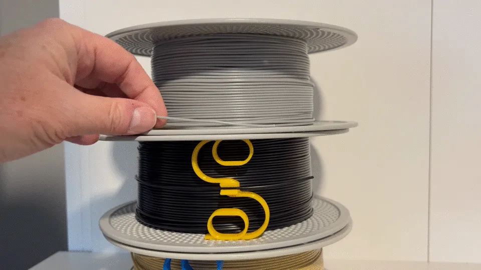

This isn’t exactly what you want, but I have done a small amount of informal testing of PLA Tough+ with this spring:
I use a good number of these filament clips that are essentially springs. PLA Tough+ creeps under load, like regular PLA. If I compress the clip and stick it on my filament spool, it will be much less springy within a day or two. PETG handles this tension much better. It might be okay if the spring is not normally loaded. But I would not expect it to hold energy for any length of time.
Thanks that is helpful. I did not expect it to creep so much.
My Tech Fun does their normal filament evaluation of Bambu PLA Tough+ in this video, which skips to the part that covers creep:
It is very similar to Bambu PLA Basic, which is not good. I think you want springs that will store energy and then return it. I don’t think any kind of PLA does that very well due to creep. My experience is that PETG will also creep a bit. But it tends to be limited. I have good luck with my filament clips using PETG. They do lose some of their springiness over time. But they are still very usable.
