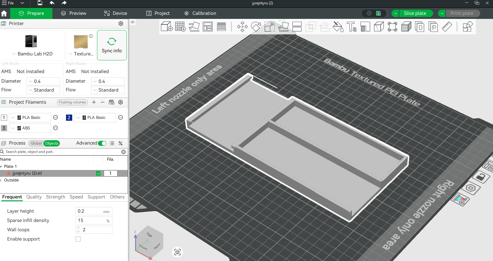

I am quite new here, as I am also new to 3d printing. The company I work for recently purchased a new H2D and I have been tasked with learning how to use it.

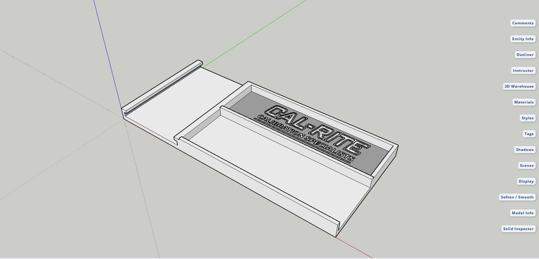

I have been playing around with some modeling on sketchup and have made a few prints now and have been very satisfied. Recently I have tried adding our logo to the design but with much failure. When importing the file, it seems to delete the text on the model. I assume that is because it sees it as a flat surface. I have tried adding depth to the lettering in sketchup but because the wording is supposed to be at the same plane I assume it keeps erasing for the same reason as before.
I have been trying all that I know (which is very limited) to no avail.

maybe use a step file- they are more detailed
The logo you put in the sketchup file looks like it is only visual. Aka, you are not changing the geometry of the part.
The easiest thing to do if you want that logo on there is to import it into studio as an SVG and do a multicolor print. (or you can add a negative part modifier to cut that part out)
I tried imagetostl.com to convert it. It does the same thing. I believe its just an issue with the way I have it drawn up as I don’t think even the converter is recognizing the depth. It is weird though as the text is actually dimensional at 1/16’’ deep.

It is possible the text geometry is in the model, just not visible as it is on the exact height on the surface.

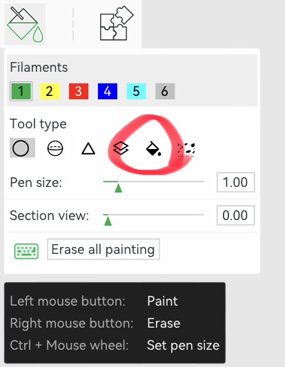

  • Navigate to the prepare tab in Bambu Studio
  • Make sure you have at least two colours shown in the filament chooser (top left of the tab under the printer)
  • Select the model
  • Use the paint icon from the toolbar
  • Select a different colour from the swatches
  • Choose the fill tool
  • Hover over the area the text was placed and if you see outlines of characters, you can select them with the mouse.
  • Continue until you have painted all the characters as you had in the source model
  • If you paint an area unintentionally, use undo or repaint with the base colour
  • Exit painting
  • Slice
If no such outlines where shown follow the advice of others.

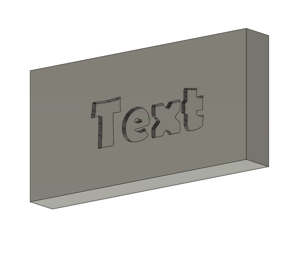

Even though you say the text is 1/16" deep, is there a cavity in the main part to accept the text? Typically when I make such designs, the process requires that I use the text to subtract from, or cut the main body so that the text has a place to sit.
And then fill that space with the text. Otherwise the slicer sees a conflict and defaults to filling the space with the main body rather that the text.
