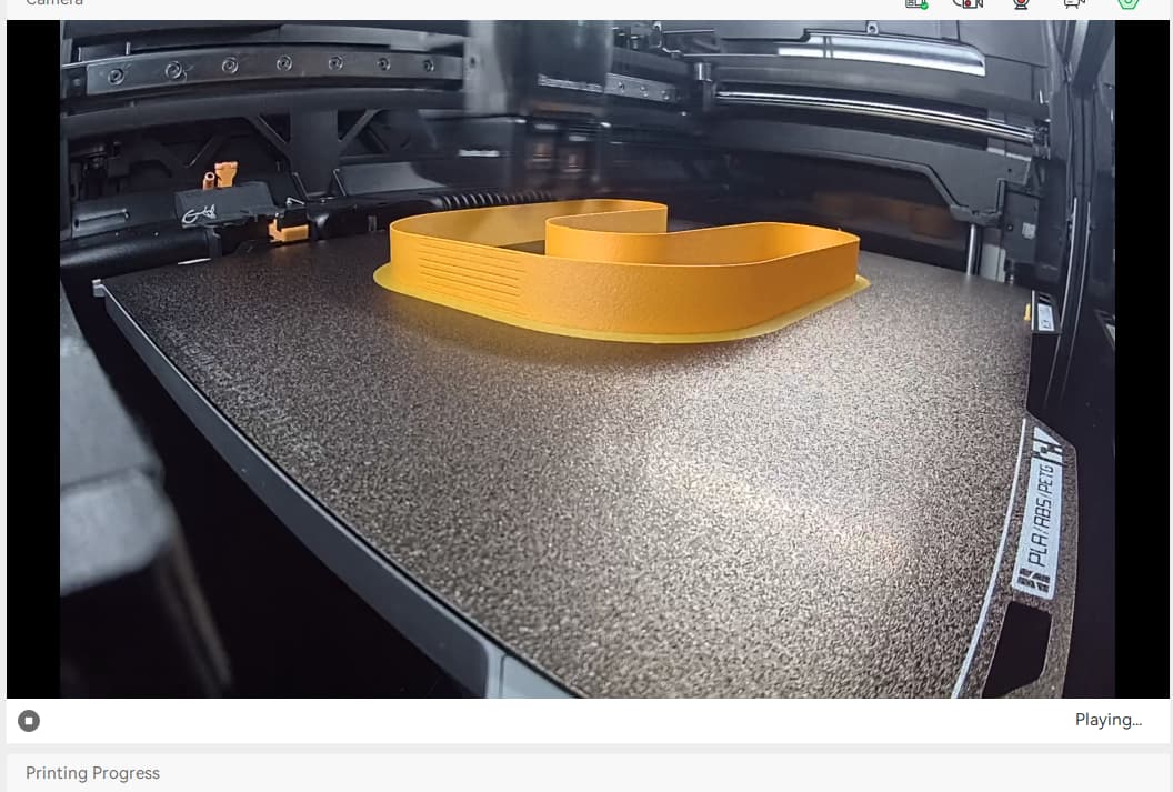

This is the first time I’ve done a GF print. The surface has a definite texture to it:
How to describe it: stipled? Powder Coated? Orange Peel? Sand casted? Sand blasted? What would be the right term? Considering it’s PLA, it’s a heavy texture.
The print is the lower half of a rugged 6x6 gridfinity box, so it kinda goes with that theme.
