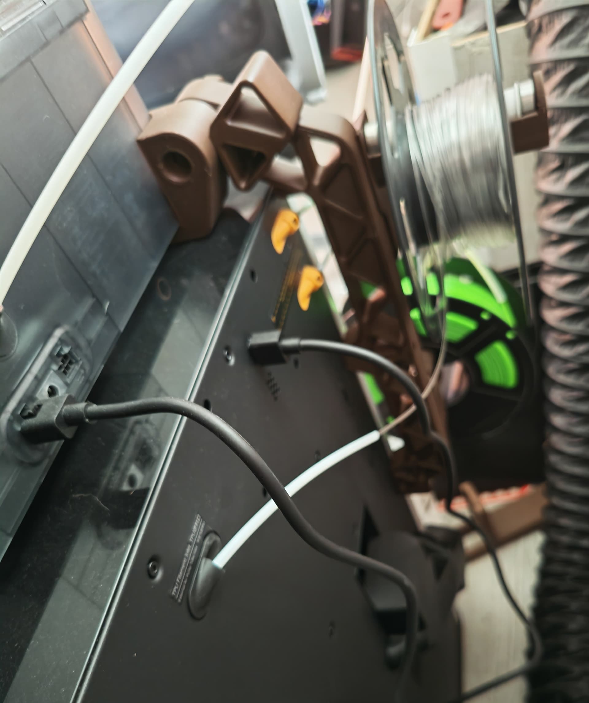

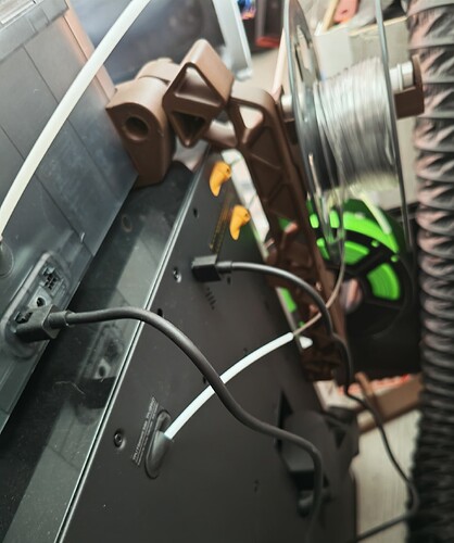

I put a third PTFE tube direct to the right nozzle
This is the best way through the bypass. Use of minimal PTFE tube lowers resistance.
I’m currently printing Siraya Tech PEBA Air through the AMS HT (while drying) via the bypass port and PTFE tubes with absolutely zero issues.
The only hiccup was my own fault—I forgot to check that the spool could rotate freely. Pro tip: if you seat the spool slightly skewed in the AMS, it won’t turn properly! :sweat_smile:
