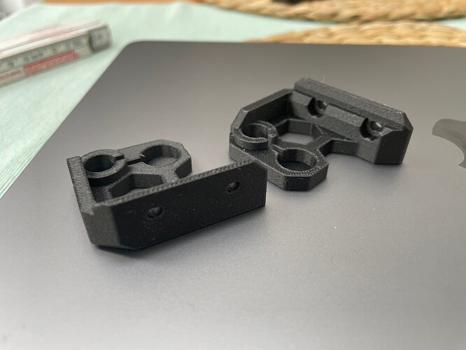

Did my first proper Polymaker PA6-CF test today. I must say this stuff is gooood!
Dried before printing at 105°C for 8 hours.
The prints look great.
Did you use the printer for drying?
No, I use a modified food dehydrator. Modified with an SSR, PT100 and PID temperature controller. Parts from Aliexpress.
