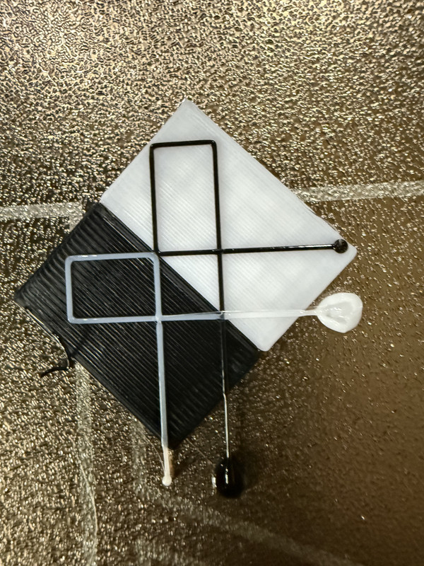

This is the image of the precision nozzle calibration that I sent to Bambu support this morning.
Does anyone notice anything that might indicate what the issue is? As far as I can tell it’s normal, although I suppose the black side might look a bit odd right where it meets the white? What should a normal one of these look like?
Nothing stands out to me with that nozzle calibration you sent to support, report back when the respond.
As far as your prints, mind definitely do not look like that, might need support on this one.
