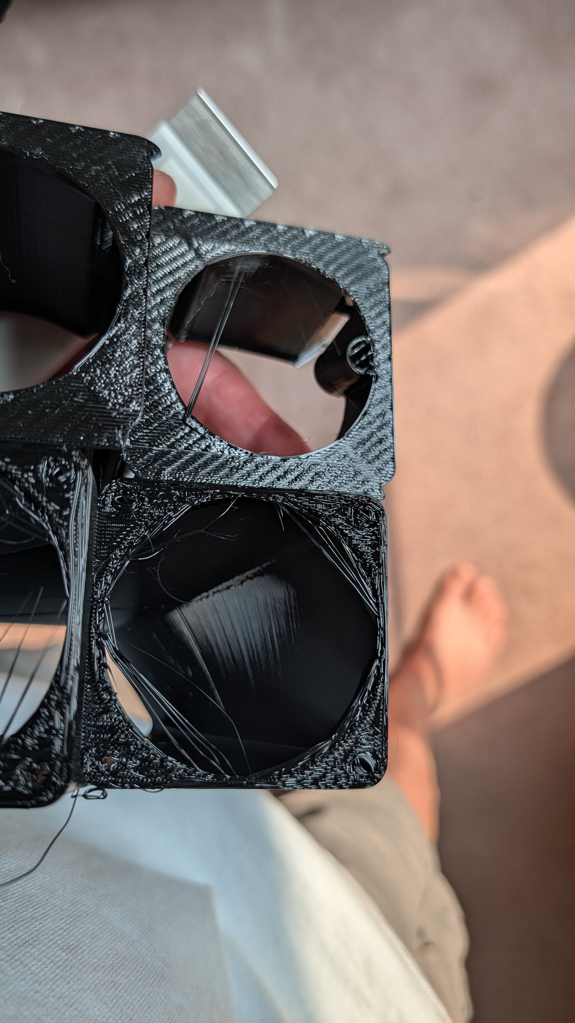

Poor petg layer above pla interface layer
Bamboo h2d using Overture pla at 245° and overture petg at 230°. . Support settings for this z distance equals zero. Three interface layers concentric interface pattern interface spacing zero. . The top piece in the picture is the pla interface layer and it looks pretty good. The bottom piece is the pedg layer directly above The interface layer.
Have you set the PLA to 245C?
Sounds a bit too hot to me!
And typical PETG temperature is 270 degrees.
Overture specs 190-220C for PLA and 230-260C for their PETG.
So 270C is a bit on the high side but for higher speeds a possible value.
245C for PLA is way too high.
270 is standard temperature for Bambu lab PETG basic.
My bad, it is default for petg and 230 for pla per Bambu wiki, entered the numbers wrong on the forum
The OP is using Overture PLA and PETG.
It’s not the standard temperature, it’s the Max temperature. Standard is 245-250.
You’re right! But the message was that his temps were incorrect.
