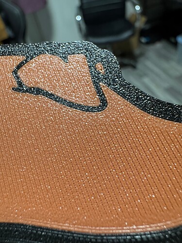

Hi, I currently own 3 printers and have been having a similar issue with all 3 lately.
I just completed a big order that took several weeks of continuous printing. I noticed some slight degrade in print quality towards the end of the order and figured maybe I should replace the hot ends on both, especially my oldest printer. (They still had the stock hotends). The main issues were noticeable underextruision even after calibrating the filament. Here you can see I tried to get around this by printing facedown, but you can still see the issue.

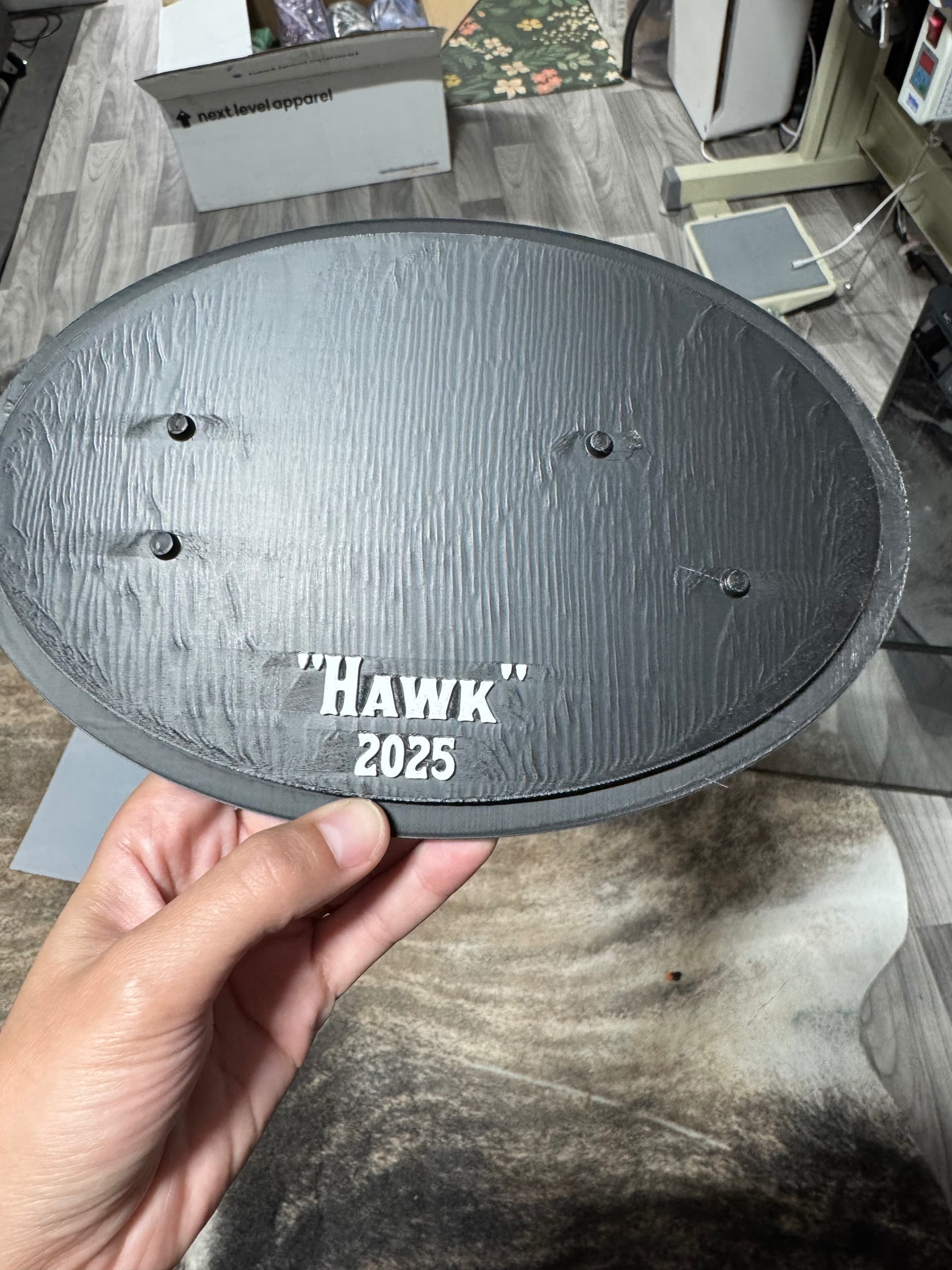

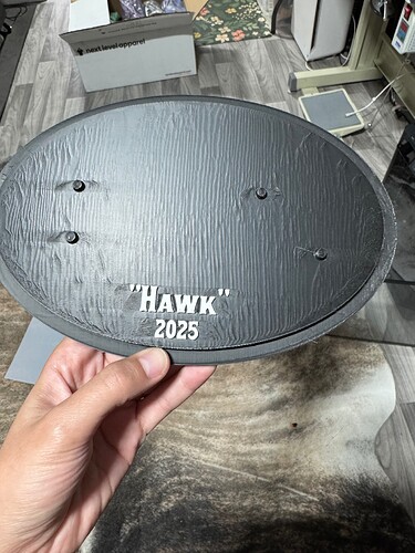

This didn’t improve anything either (in fact, maybe made things worse? See photo below. Ironing was turned on. )
All of the printers seem to print okay in terms of layer line consistency and bed adhesion, they will print, but flat surfaces look terrible with or without ironing.

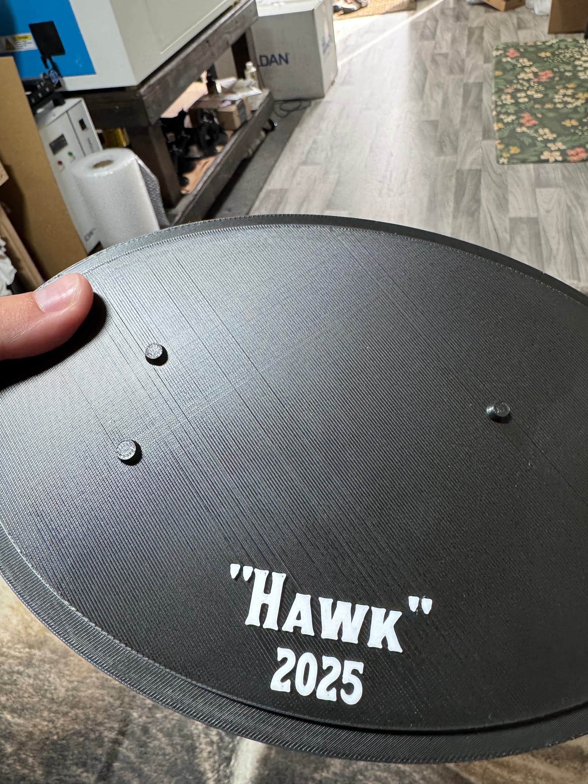

This is a different printer, same file, ironing off:

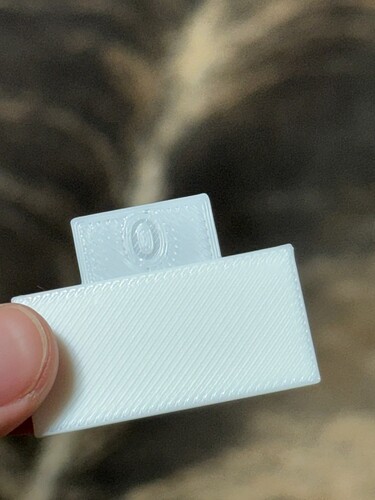

This is the best result I have been getting when running a filament calibration:

Seems to be underextruding. You may need to do the flow calibration for each of the colors. It can vary, even if the different colors are the same brand and type of filament. Try running a flow calibration on the black filament, the white seems to be dialed in fine.
For me, it looks like extrusion problems, check the extruder wheels, clean
or replace. Also check ptfe routing and filament buffer
